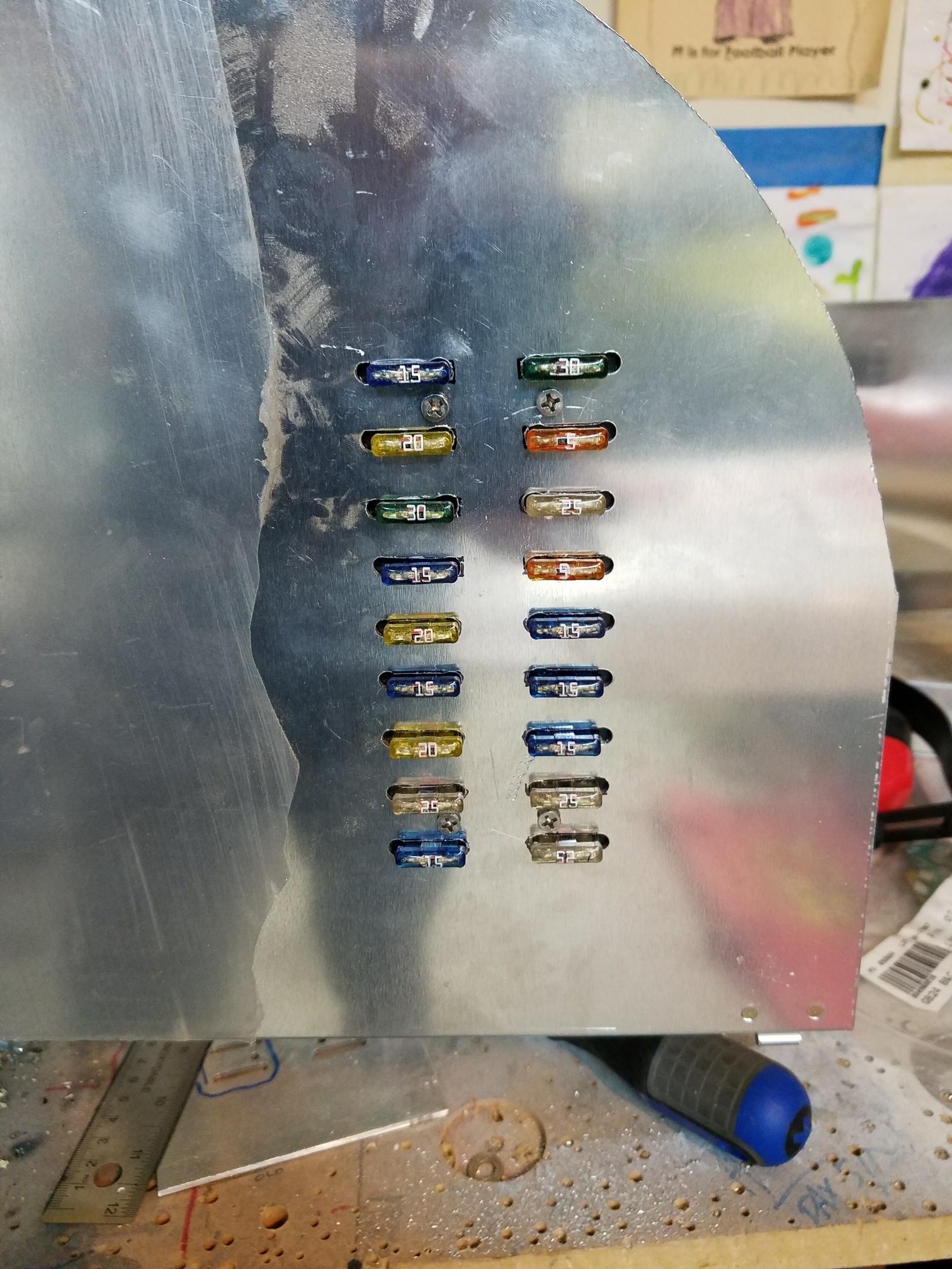

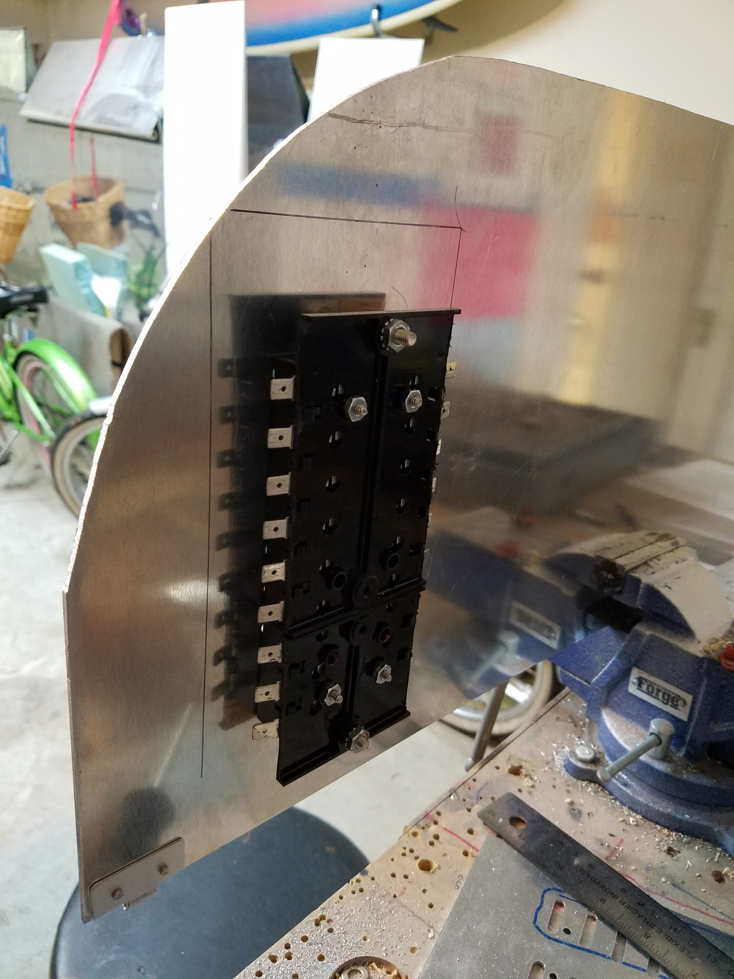

So, here is my instrument panel fuse system for my project plane. I like the way it turned out. Much more compact than breakers. Still need to clean up the holes cut in the panel...

Hard to tell from the pic , but are the fuses mini blade or full size ? ??? Where did you get the fuse block from ? :P

They are full sized fuses, but they are the kind that light up once they are broken. I bought the fuse blocks from autozone. I had to open them up do something to the metal tabs inside the fuse blocks so that the fuse blocks would lay flush against the backside of the panel.....but its been several months since I did the fuse block surgery and I cant specifically recall what I did now as I type this. It wasn't difficult though.

the more I think about it, I didnt modify the metal tabs, I had to take it apart in order to cut the plastic housing. You can see the cut marks in the photo of the backside of the panel.
