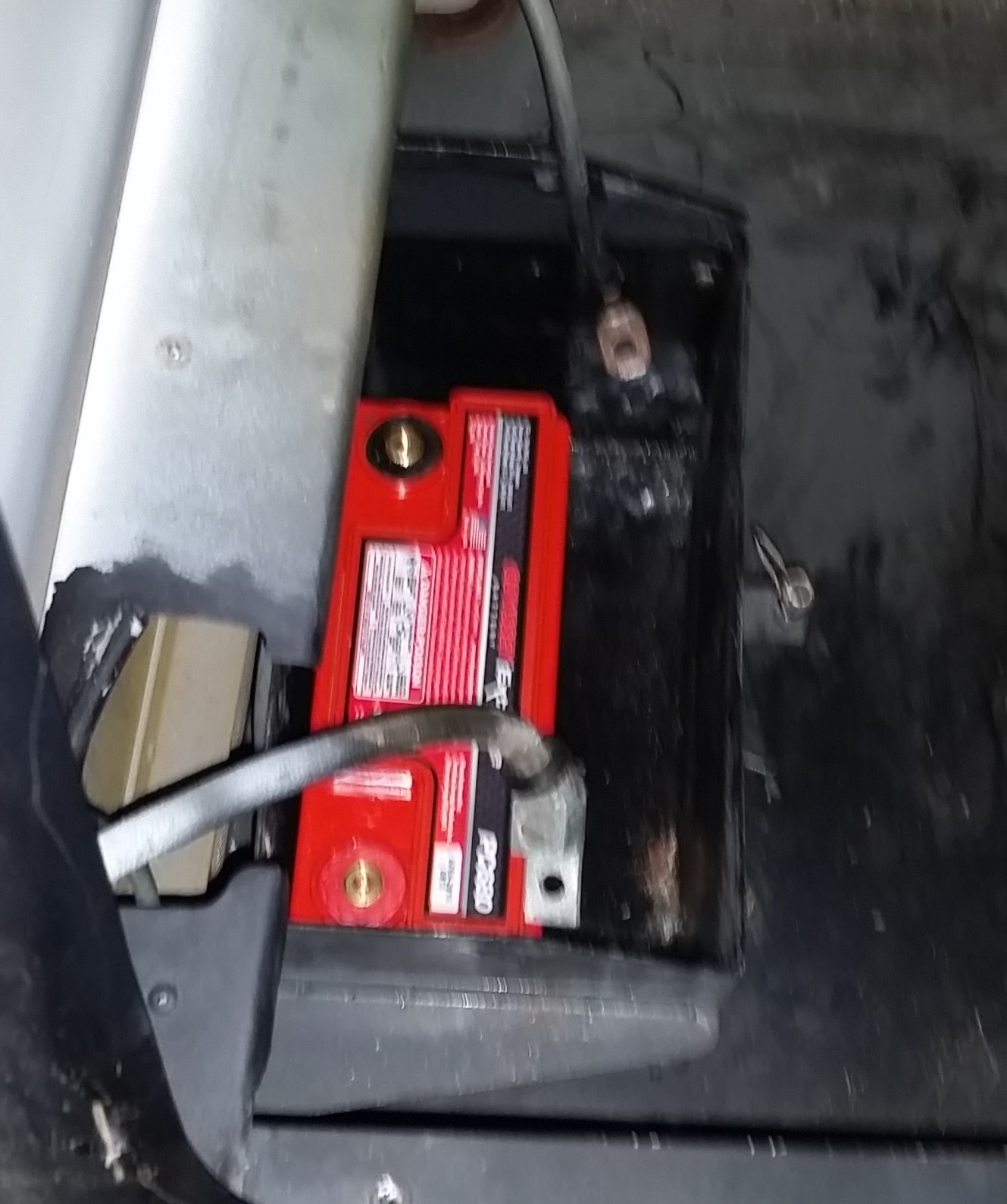

I'm trying to find and prevent problems before I drag old' N12055 back out to the airport in April. The big (to me) issue that I found last night :-[ is that the plane only has a starter solenoid. It does not have a battery solenoid. Therefore, the starter solenoid (and the big cable to it) is always hot regardless of whether the master switch is turned OFF. Was this typical for the '70's homebuilts?
Anyway, this is a mandatory change in my mind. Where do you guys mount your battery cut-off solenoid? I was thinking of mounting it inside the battery box (which is in the baggage compartment) because the new PC680 battery is so much smaller than the box. Or, outside the box on the forward side of it. There is a good 6" of space there that I could protect it from coming into contact with baggage (metal buckles, etc.)
