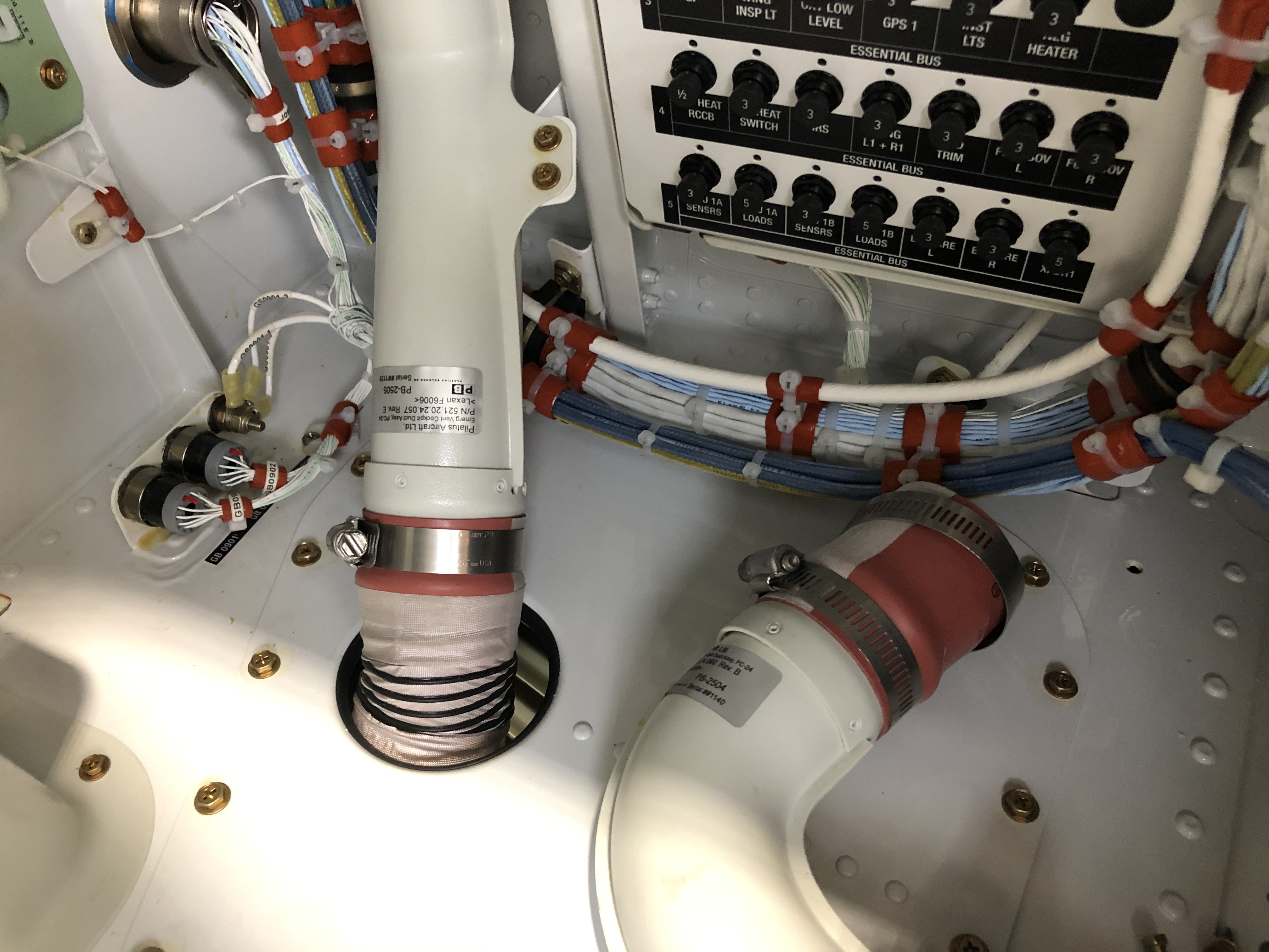

Re: wire ties vs lacing - I had a great tour of the new Pilatus completion facility at my home field, KBJC, today. They also do a lot of military work, but right now there wasn't any classified stuff going on so we got a good tour. They had several models being completed - avionics, interiors, etc. in various stages of completion. One of their PC24 jets had some panels open and wiring was visible. I found it interesting that they don't use any waxed lacing cord on wire bundles - just my favorite T&B brand wire ties. This is an $11.4 million airplane.

pacer18a
PostPosted: Wed Mar 04, 2020 10:57 am
Posts: 43
John is that silicone rescue tape under some of those wire ties?

PostPosted: Wed Mar 04, 2020 7:32 pm
I forgot to ask, but I believe it is. They seem to use that whenever the bundle is going to touch & be attached to a bracket, or the cool little extensions that are attached to sockets, etc. for strain relief. If ties are just used on the wire bundle alone, it doesn't seem to be used.

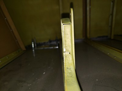

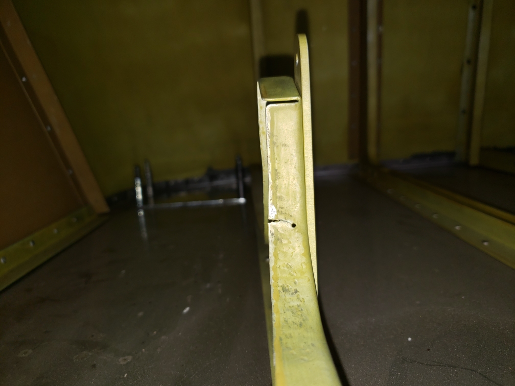

So its getting close to time to install my fuel tank, so I need to address this issue. The tank support bracket is cracked (see photo). The photo is taken as if you were laying on your back on the ground and looking up. Any suggestions to salvage the existing bracket, or should I remove it and reinstall a new one?

PostPosted: Fri Mar 27, 2020 12:54 pm
Make a strip out of .040 and rivet it on the back side. If you want to get fancy make a doubler.
PostPosted: Fri Mar 27, 2020 4:13 pm
Posts: 1169
Wonderful! Thanks Bob.
