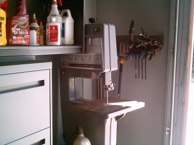

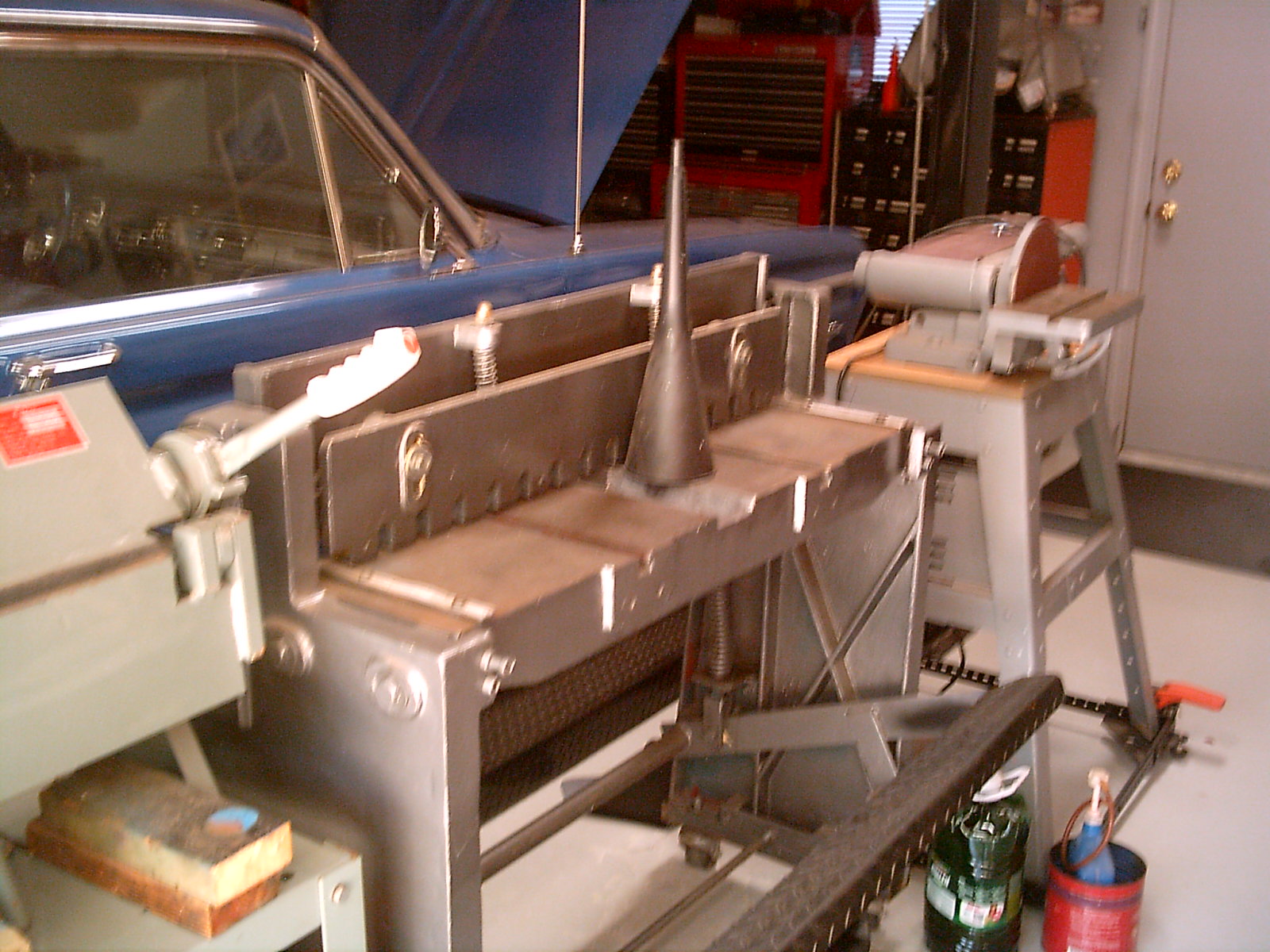

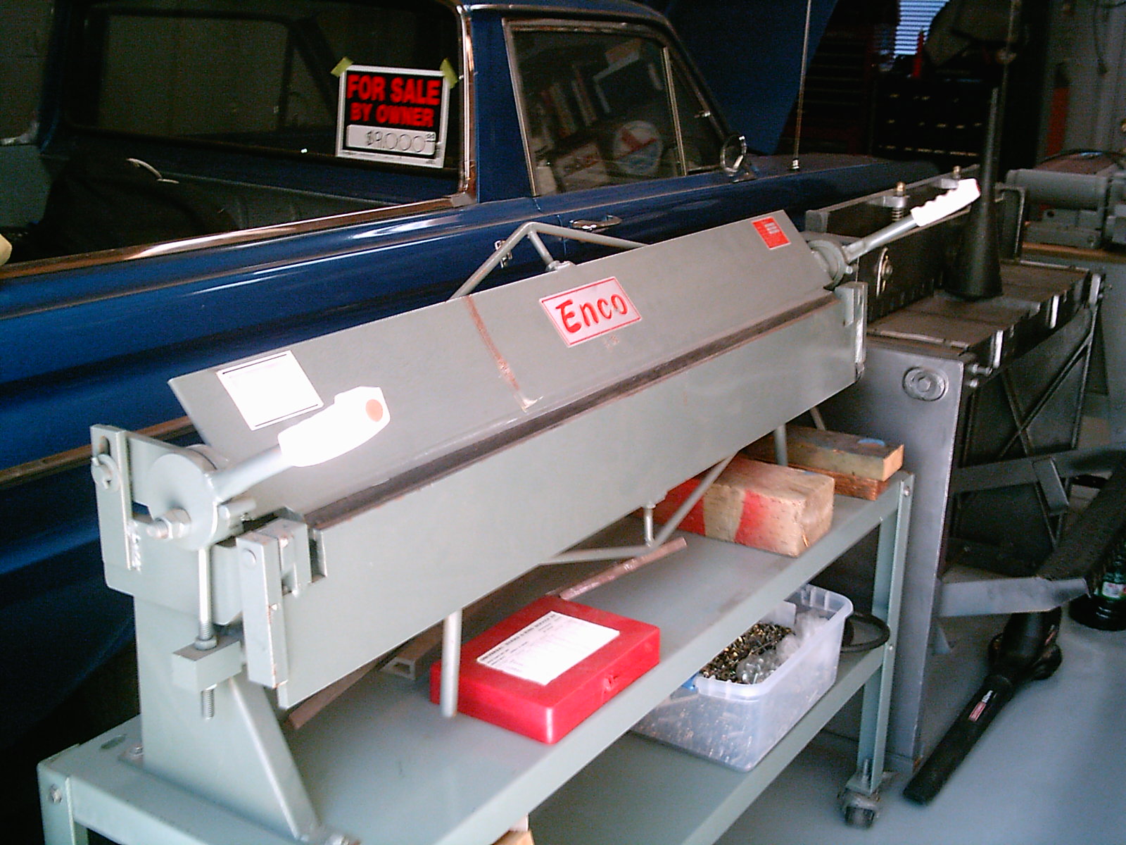

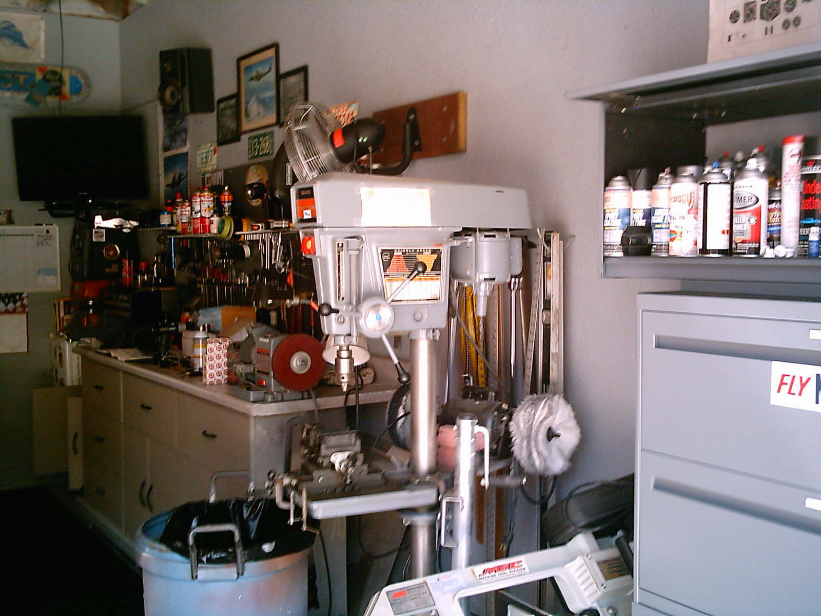

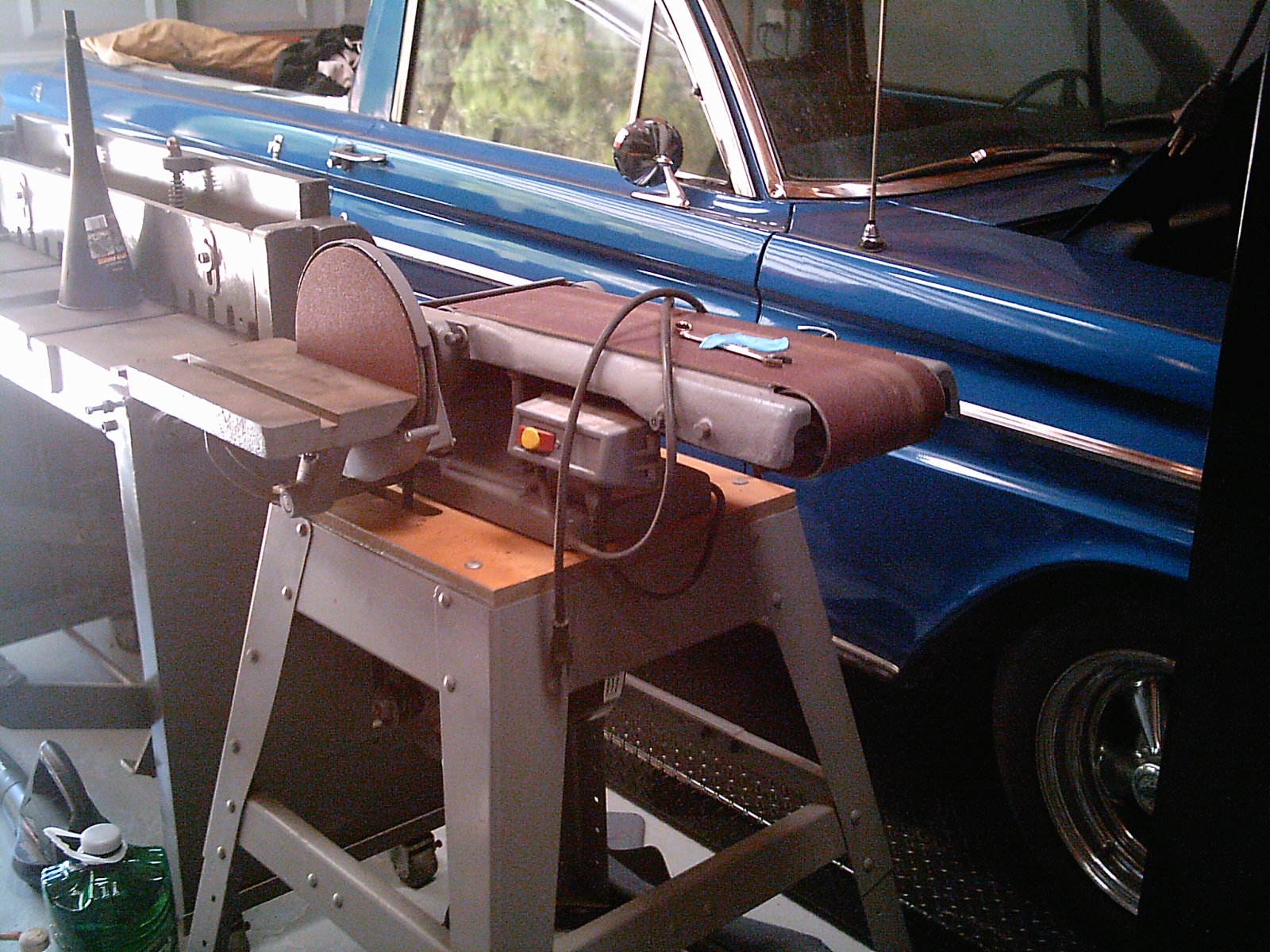

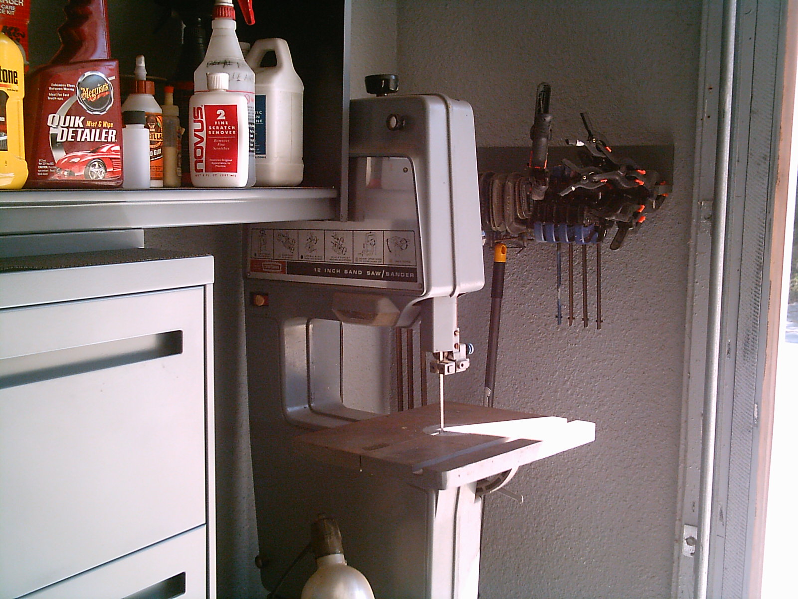

These pics might clear up a few questions you have . You can see the Craftsman Belt/Disc sander . The sander , drill press , band saw , bench grinder are all USA made heavy iron Craftsman tools that I bought back in 1974 . You can't buy them at Sears anymore , but you can find good deals on E-Bay . The brake I got from ENCO and it was a clearance item with free shipping, $200.00 . Made in ROC and not China and you can tell the difference in quality . I had to make radius shoes for the brake . The Shear I got off E-Bay and it is a China knock off , but works just fine for thin gauge aluminum that we use . The band saw I used all the time (metal blade with a speed reducer) . You really need a good quality bench vise . I used it a lot to bend steel parts with the help of an acetylene torch to heat the steel (canopy latch , etc.) . The Craftsman drill press I used a lot when it came to drill repeated holes in the wing beams . Made a jig that allowed the parts to roll right thru straight and true . Much easier than a hand held drill ! ;)
