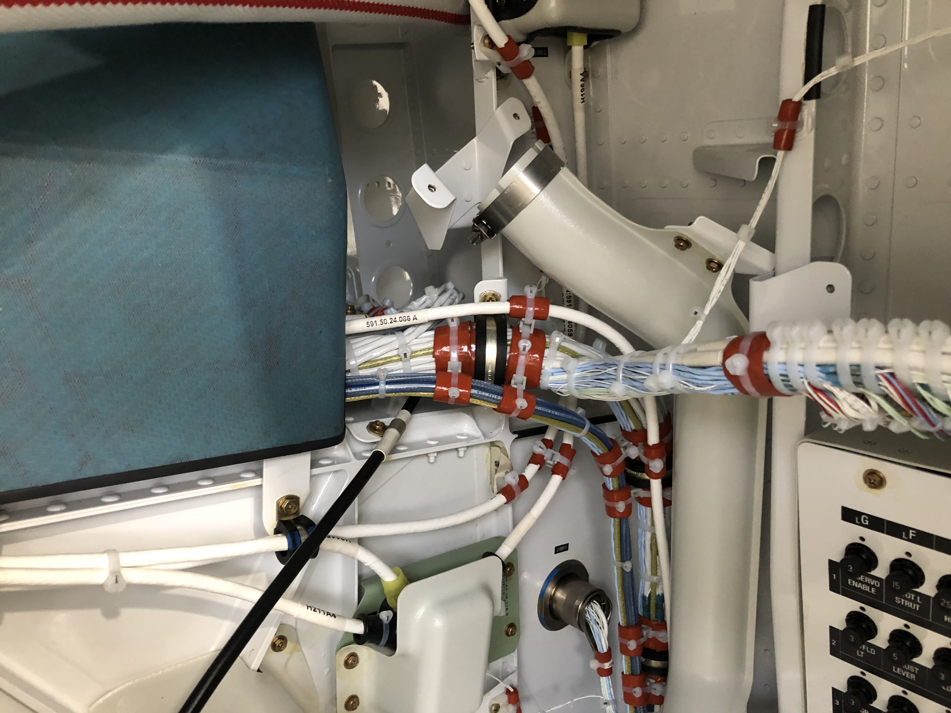

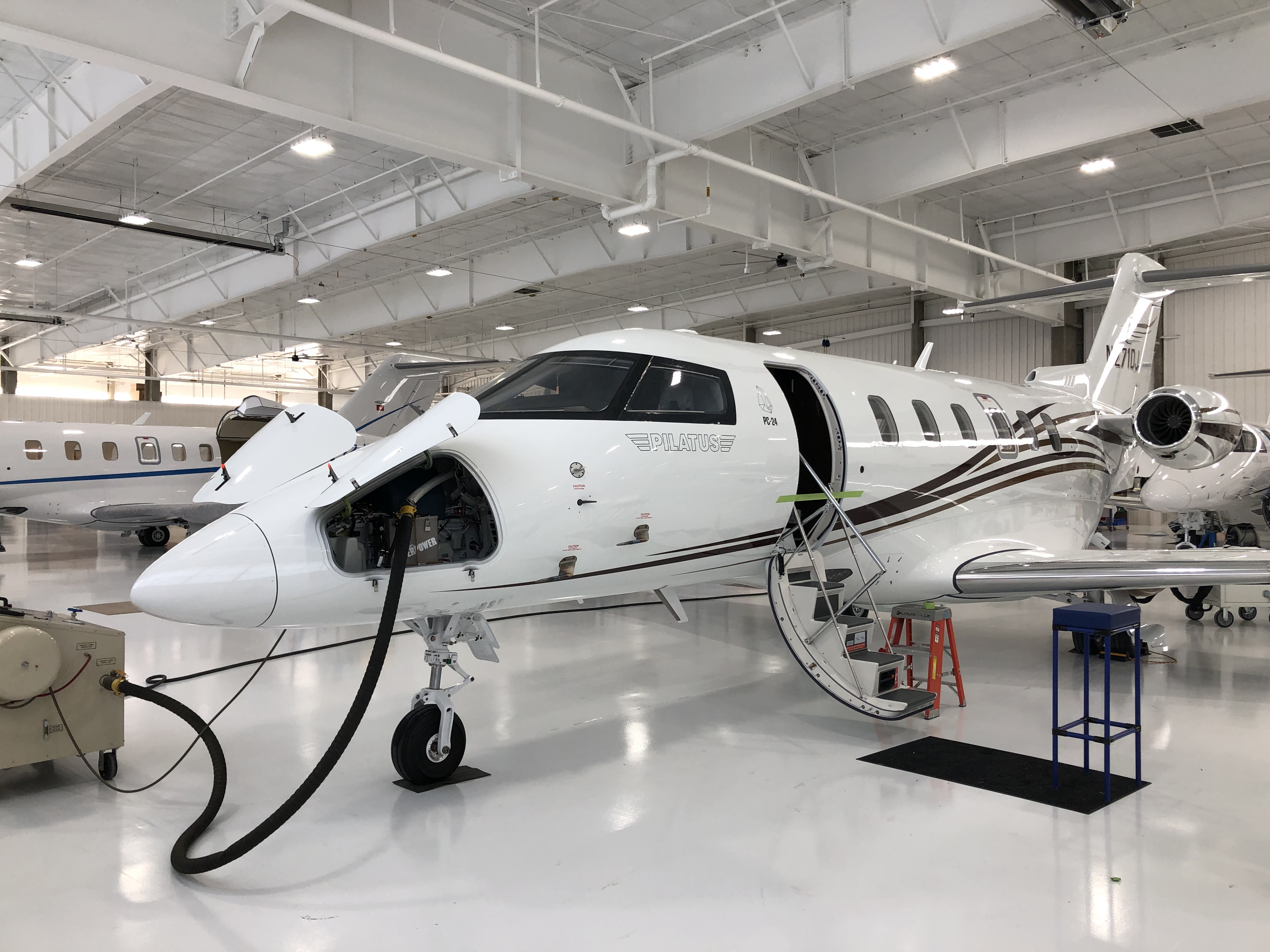

Re: wire ties vs lacing - I had a great tour of the new Pilatus completion facility at my home field, KBJC, today. They also do a lot of military work, but right now there wasn't any classified stuff going on so we got a good tour. They had several models being completed - avionics, interiors, etc. in various stages of completion. One of their PC24 jets had some panels open and wiring was visible. I found it interesting that they don't use any waxed lacing cord on wire bundles - just my favorite T&B brand wire ties. This is an $11.4 million airplane.

pacer18a
PostPosted: Wed Mar 04, 2020 10:57 am
Posts: 43
John is that silicone rescue tape under some of those wire ties?
PostPosted: Wed Mar 04, 2020 4:57 pm
Posts: 1171
well, that's interesting, thanks John. I guess if Pilatus can do, so can I.
PostPosted: Wed Mar 04, 2020 7:32 pm
I forgot to ask, but I believe it is. They seem to use that whenever the bundle is going to touch & be attached to a bracket, or the cool little extensions that are attached to sockets, etc. for strain relief. If ties are just used on the wire bundle alone, it doesn't seem to be used.
