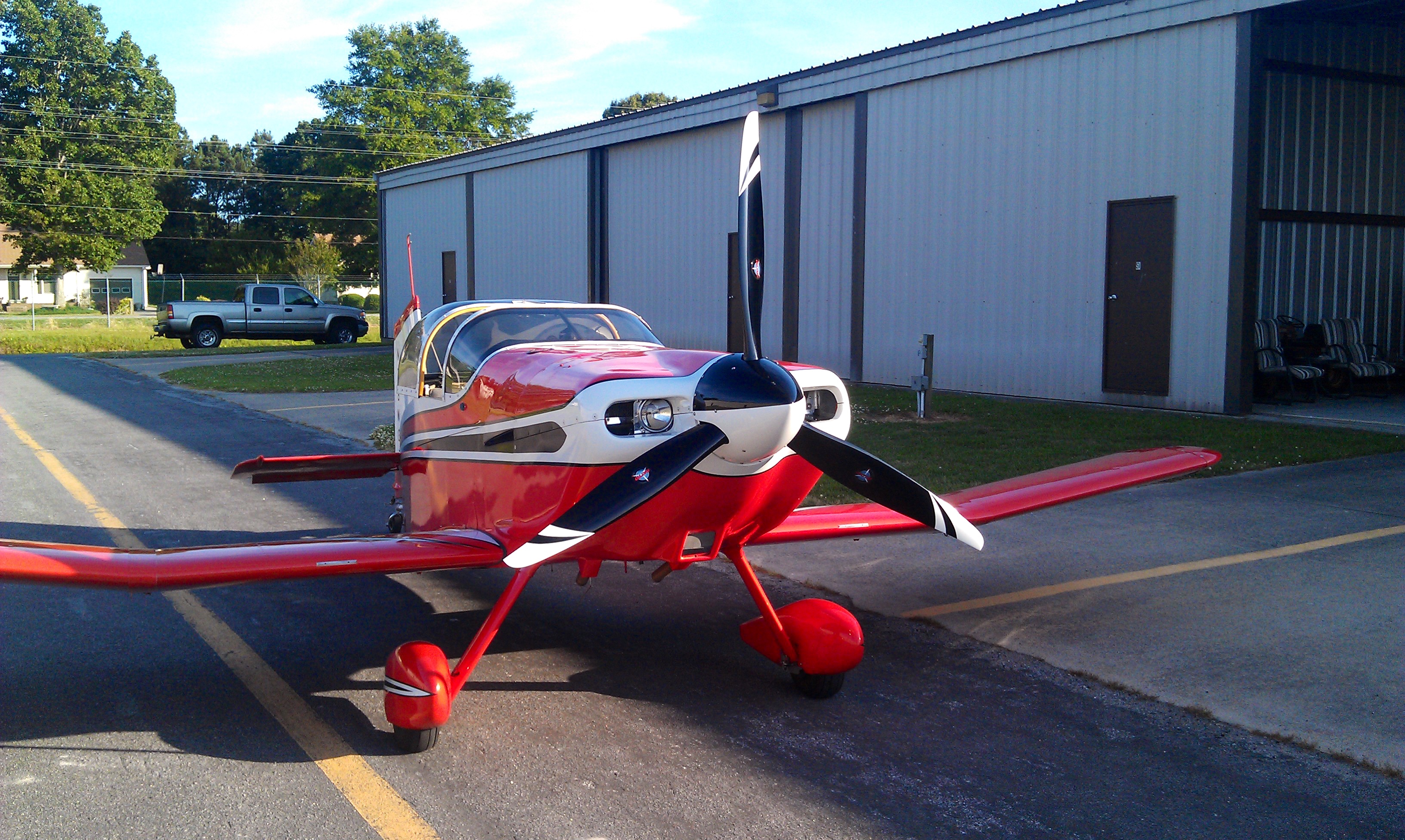

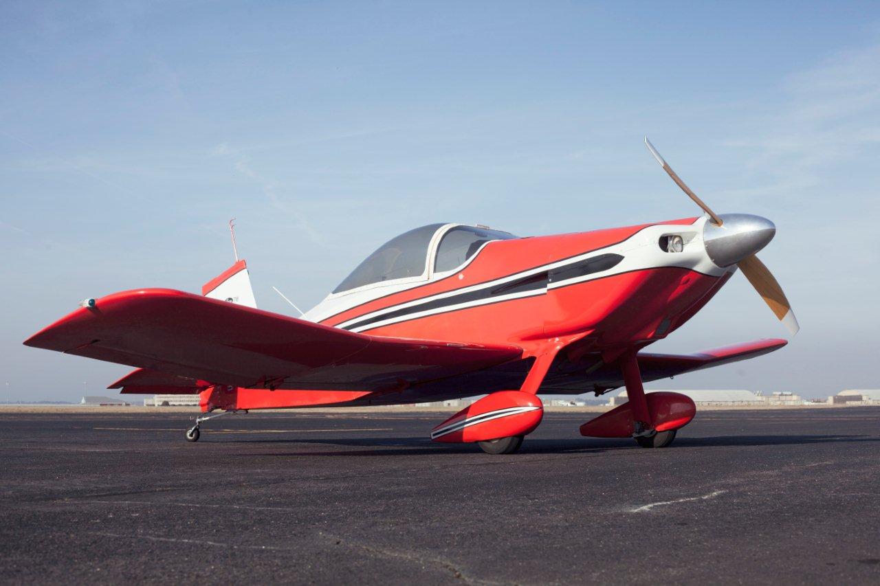

When my AD prop developed a small hub crack I swapped it out with a Catto 3 blade and their RV spinner. It was a very simple process and worked out great.
