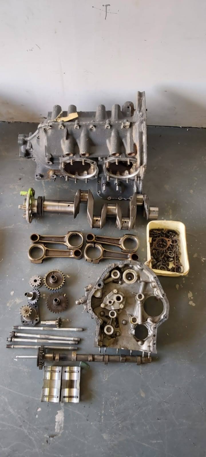

My Thorp was fitted with an 0-320 (unsure of configuration). The previous owner sold the engine after it had a ground loop. I bought the project with a partially complete 0-360. I still need to see what comes with the engine, but it needs quite a lot.
I am trying to decide if it is best to spend the money building the 0-360 up, or selling it and buying a complete 0-320. I was keen on the 0-360 due to the extra power, but after reading your comments, I think the 0-320 would be the best engine (weight saving and economy). Suggestions?
Question: I've been trying to research the different configurations of the Lycoming, and would like to know what the best or recommended configuration is for the Thorp?
