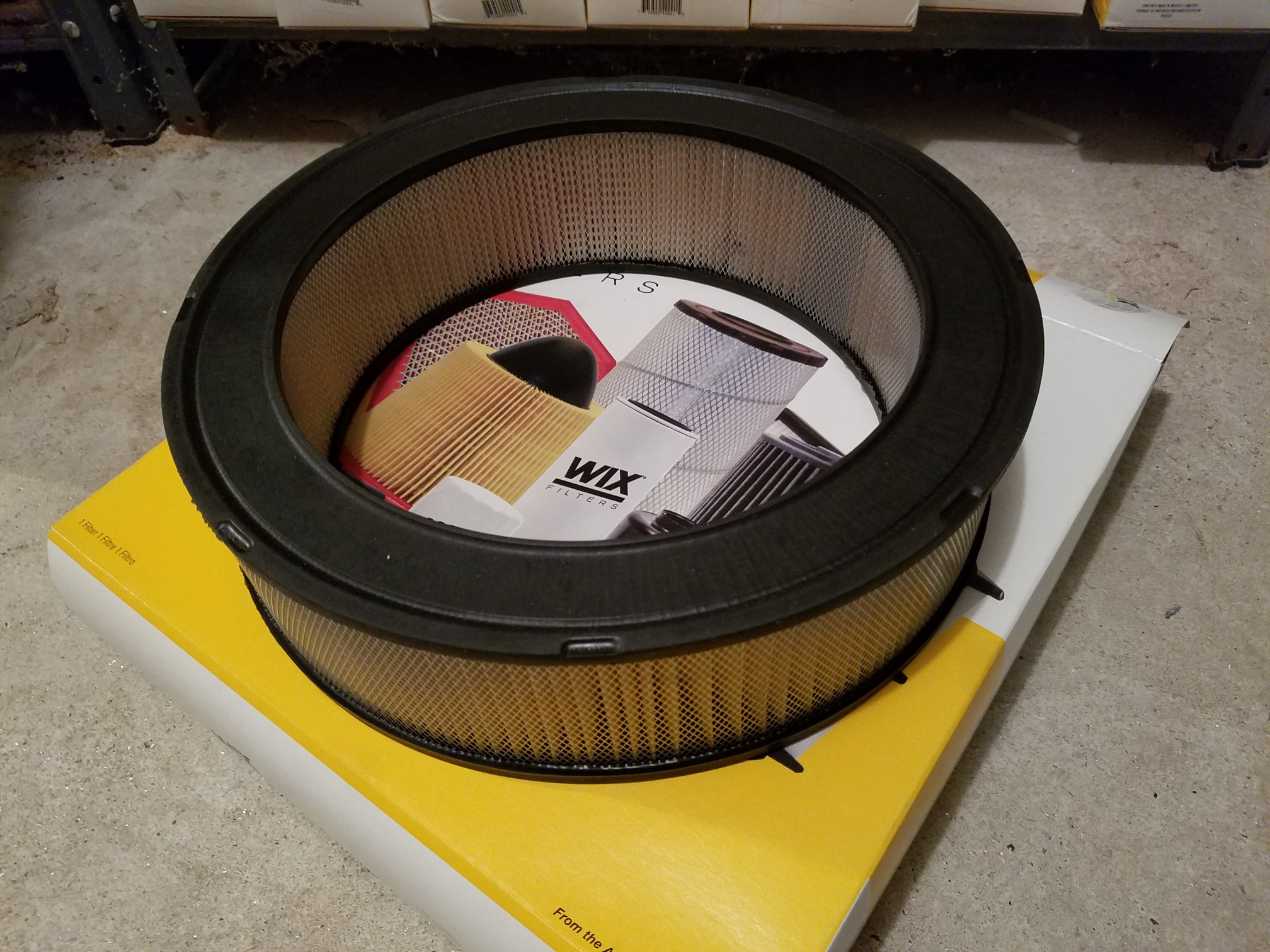

There is always a lot of grit found in my oil filter when I send it in for oil analysis. I cant find anywhere that I think unfiltered air is getting into the system. Only other thing is I would think is that I would need to try a different air filter. Any other suggestions as to how to lower the amount of grit being found?

Is it solid "grit" like pieces of sand or is it black granules that can be crushed when put between your fingers ? :o If it is black and can be crushed it may just be carbon deposits from combustion . Exactly what are the oil guys saying it is ? ??? I used the disposable foam infused with some type of oil from ACS for my air filter . :P What filter are you using now ?

When I cut my own open, it doesn't look black like carbon. I do notice some grit (like sand or dirt), but it doesn't worry me when looking at it. When I send the filter into Avlab for analysis, they always come back with "Major Grit" found. I use a Wix brand filter. I guess it would be worth a try to use another brand. Im just wondering if Im missing something obvious thats allowing the dirt/grit into the system which is being caught by my filter.

Are you talking about sending your air filter into a lab for analysis (shown in the picture), or your oil filter. And surely you're not sending the whole oil filter in - just an oil sample, right? Do you fly from a dirt strip?

I thought you were talking oil filter and don't call me Surely . ??? If it is the air filter is it possible that it is not sealing correctly in the housing ? :o

Carb heat air leak?

Proper fit of the air filter in the housing was the first thing that came to my mind when I saw what is being used. I have seen that style of filter siliconed top and bottom because of improper fit (loose). Carb heat boxes are rarely tight and provide unfiltered air if on.
I would think the analysis shop could tell what the "grit" is. Grit could be anything from carbon to sandblasting media or even metal filings.

Sorry for the confusion. I am talking about the results of my oil filter analysis. I have called Avlab about what "grit" means, and although I cant recall exactly what they said now, I came away with the understanding that it was basically dirt. I was thinking that the only way grit could be getting in was around a poor fitting air filter (and now I'll check the carb heat box too). I only fly off paved runways.

The filter in your picture, is that the one called out in the original Thorp drawings? I'm having a great deal of trouble trying to find one for my T18. I gather its a WIX, can you give me a part number.

I don't know if its the one called out in the original drawings, but it fits my filter box like a glove. Its WIX part # 42091. I have just switched to using a K&N Filter that is a cross referenced fit to the WIX 42091 in hopes of reducing the amount of grit found in my oil filter samples.

Dimensions look familiar, all I need to do now is find a local supplier. WIX is not common in NZ!
