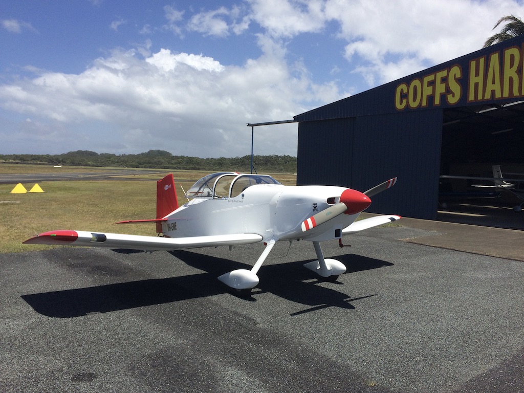

Im running a 72FM8S9-1 (86) with rans 2 1/4 spacer on my T18 and I'm happy with performance.

Thank you for letting me know! I really want a CS prop, but if I can find a used metal Sensenich FP prop at a reasonable price, I may do that. Beautiful airplane by the way.
