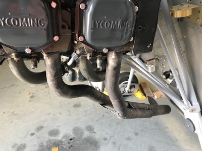

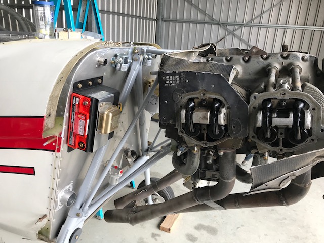

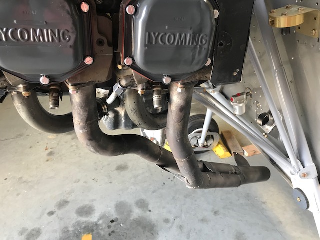

I just called Clint at Vetterman Exhaust about a replacement exhaust for my T-18 (N7077J). The existing system on the airplane is not conducive to adding carb and cabin heat muffs.
It sounds like he is very familiar with the T-18. I've seen one post about using the Vetterman Exhaust, but thought I'd ask if anyone else on this forum has any experience with Vetterman. Thanks in advance.

I have one on mine. Had to make the front one (#1) a couple of times cause it wasn't tight enough to the engine for the cowl to fit. Other than that, it is perfect.

It's a Lycoming crossover system with a muff on both sides. I lost some power switching from the 4 individual pipes I had but I gained speed.

Repaired it so he could fly it home and ordered a system from Clint and was here within three weeks. Installation was a breeze and everything fell in place with no interference from cowling and heat muff fit well. The only glitch was the tail pipes weren’t long enough. I ordered a system for my Thorp and he sent me 6” extensions for both. My only disappointment was that system was made using 1 1/2” instead of the 1 3/4” I had and wanted. I was reluctant to install them until I read up on it and found out Carbon copies with 190 hp engines were using them just fine.
Flew the airplane and had no loss of power and if I could put a mouse in the airplane, I think I could get him to tell me I picked up 2 knots.
