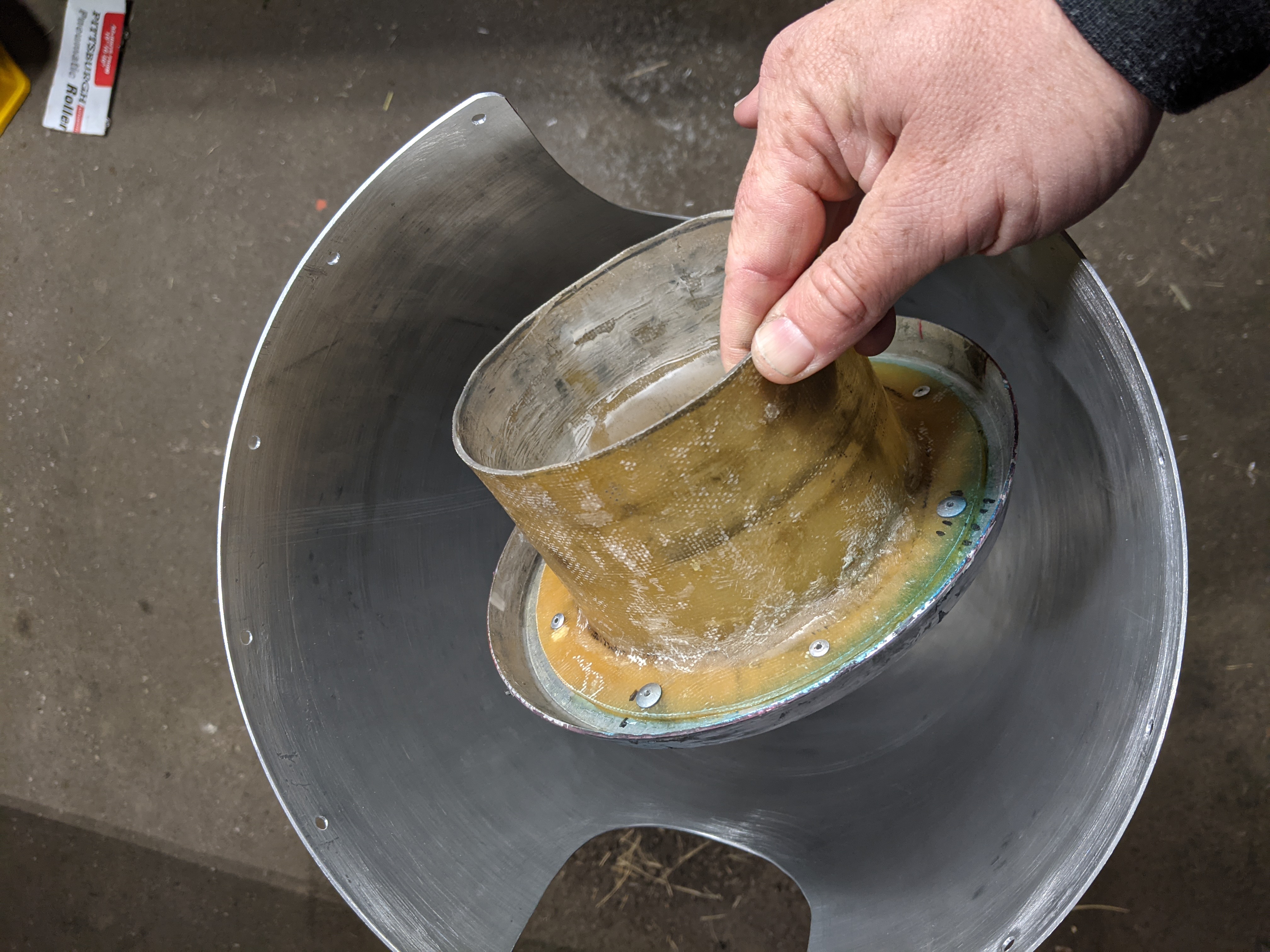

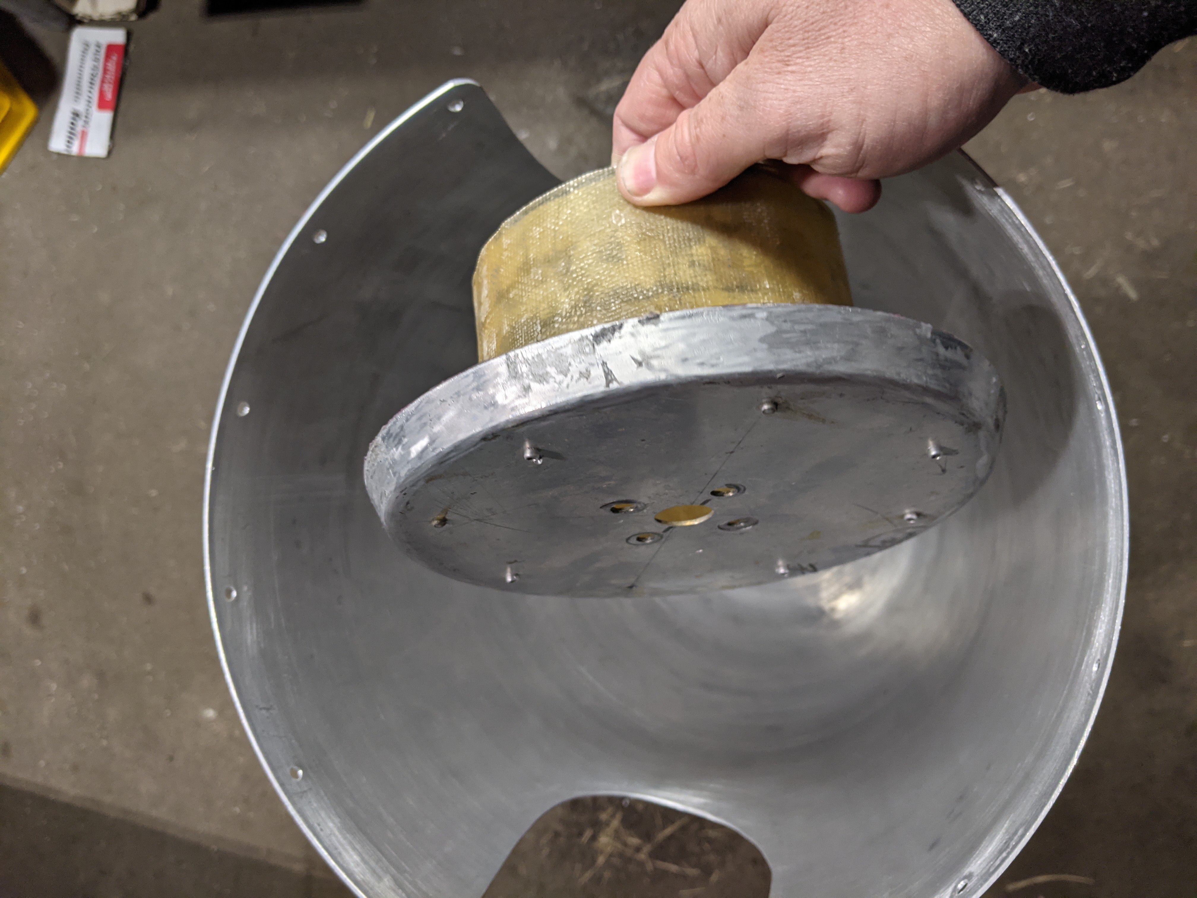

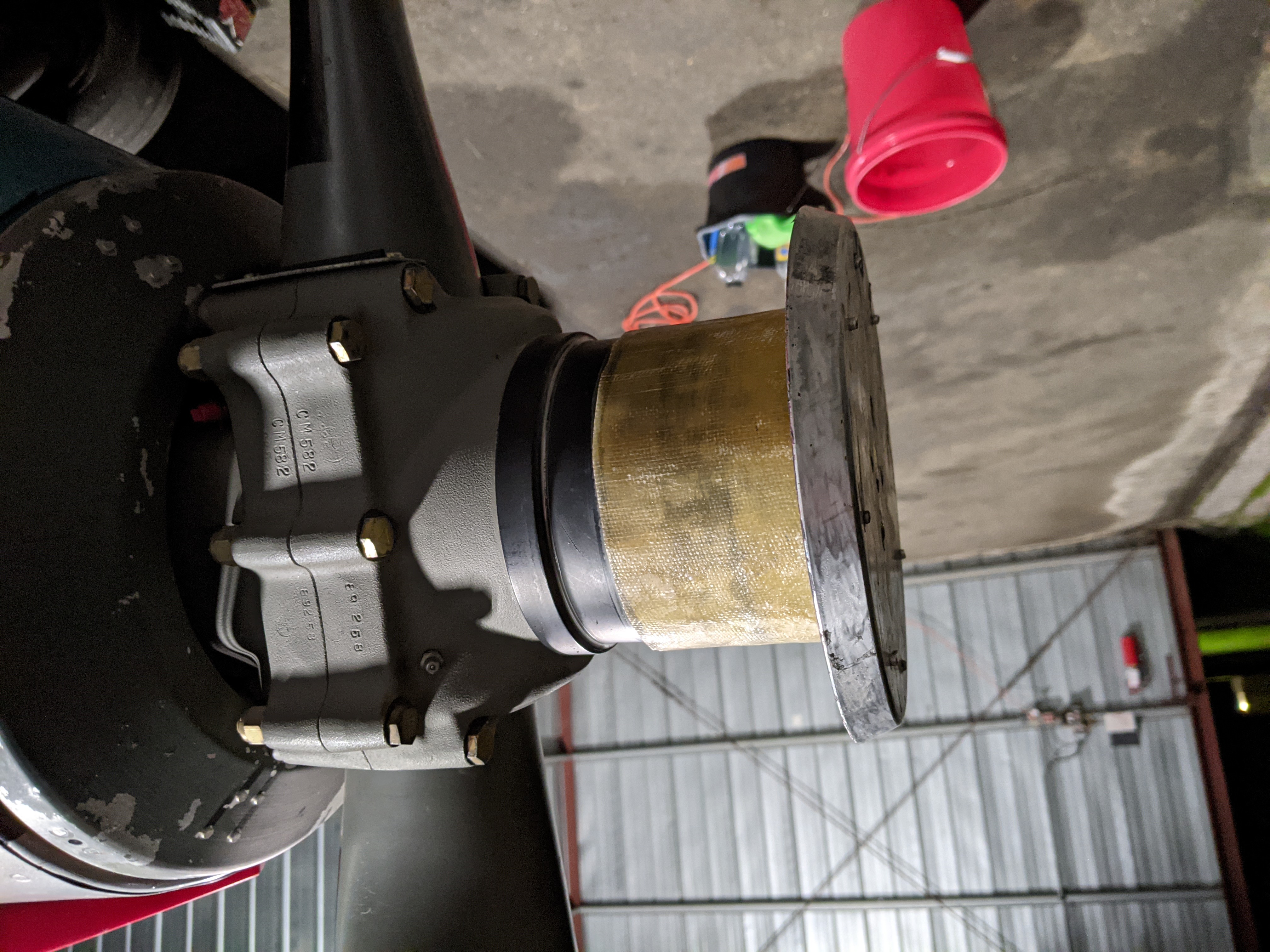

Can you confirm that your front bulkhead is mounted to the propeller hub with a single, centered screw? What are the four surrounding screws for?
I'm amazed at how long this has taken me to finish. It took a year to do my first spinner, and more than that for this second one. I finally drilled all the holes in the dome for the rear bulkhead. Thankfully, all the holes line up. Now what remains is the front bulkhead and final surface finishing.
So continuing on Question #2 above, how do I actually mount the front bulkhead?
I have attached some photos of the front bulkhead on the prop hub and held up next to the spinner dome.
My assumption had been that the front bulkhead attaches to the interior of the dome either with strong/permanent double-sided tape or with rivets/screws. It seems like Philip's installation is secured to the prop hub and the dome just rests on the front bulkhead when it's installed. Which is the right choice? Should the bulkhead be attached to the prop hub and provide support for the spinner (without attachment), or should it be mounted to the spinner dome and slide over the prop hub?
I would love this spinner #3 to last more than a few hours, so I'm happy to take the time to get it done correctly.

I epoxied my front bulkhead to the spinner with JB Weld. Very similar to your setup. Been there for 35 years. The other must have (IMHO) is fillets behind the cutouts that tie the opening together. Might have a picture later today.
PostPosted: Mon May 31, 2021 10:19 am
The proper constant speed forward spinner bulkhead has five holes in the center. The center hole is simply a clearance cutout. The four surrounding it are drilled for #4 bolts. Get short AN4-3 bolts and gently bolt it directly to the constant speed cup on the very front face. It will be perfectly centered. I use electrical tape as anti shaft around the flange. Any thin material will work.
When you install any spinner dome, the fit should be tight enough that you need to use an awl to pull it aft to the backplate holes. I do not recommend putting screws and nut plates in the forward bulkheads.

Dr. Drift,
My installation is much like Phil's. The 4 screws guarantee the front bulkhead will be centered. I have a few washers between the bulkhead and the dome on the C/S prop which, as Cubes said requires an awl to pull the spinner dome back for the screw holes to align on the rear bulkhead. I measured the run out of my spinner and it was less than .005". I am real happy with the set up I got from Cubes.

PostPosted: Mon May 31, 2021 2:51 pm
James Grahn wrote:
......When you install any spinner dome, the fit should be tight enough that you need to use an awl to pull it aft to the backplate holes. I do not recommend putting screws and nut plates in the forward bulkheads.
Are screws and nut plates in the forward bulkhead also not recommended for fixed pitch propellers as well?
PostPosted: Tue Jun 01, 2021 10:19 am
That is correct Ryan.
