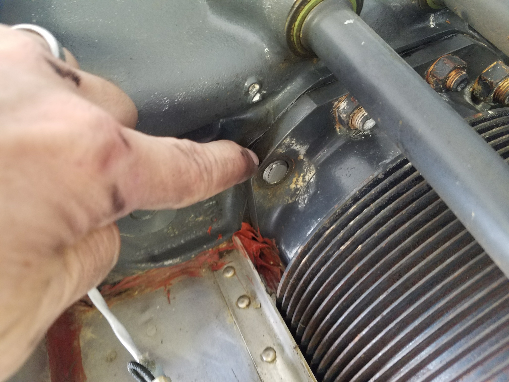

Well, see the photo below. There is a second broken stud on the underside of the cylinder too. How can this be fixed?

The stud should thread out once you can get a hold of it. Replacement studs can be a bit of a pain with the minimum torque requirement and getting the proper length remaining out of the case to put the nut on.
I have seen the threads get pulled out but this the first broken cylinder stud. If it was a through stud the case would have to be split.

Thanks Jeff. How would I get out the lower stud out which appears to have broken off flush with the case (rather than flush with the cylinder flange in the photo above).

I'm thinking you are looking at a through bolt and not just a stud. Even if is just a stud, the amount of corrosion on the remaining studs would make me want to tear the engine down for a complete inspection.

I hate to say it but I think the jug will have to come off for both. Probably have to drill the bottom one and use an easyout. How hard they come out will depend on what, if anything, was used as a thread locker.
I think the through bolts are on the back side of number 2.

The white stuff on the case and bolts is actually baby powder that I put on the case a couple hundred hours ago in search of an oil leak.

I was just looking at the picture zoomed in. It looks to me like there might be some kind of sealant under the cylinder base. If true, that can cause all kinds of nastiness down the road to include broken cylinder studs and possible catastrophic failures. Those mounting flanges need to be clean. Mike Busch did a good article about it...

i would pull the cylinder off . Remove and replace all studs and nuts. Fit new studs with thread sealer to stop corrosion developing . There is enough stud
sticking up to apply the stud removal tool. can buy at any good hardware shop .. J.P..
