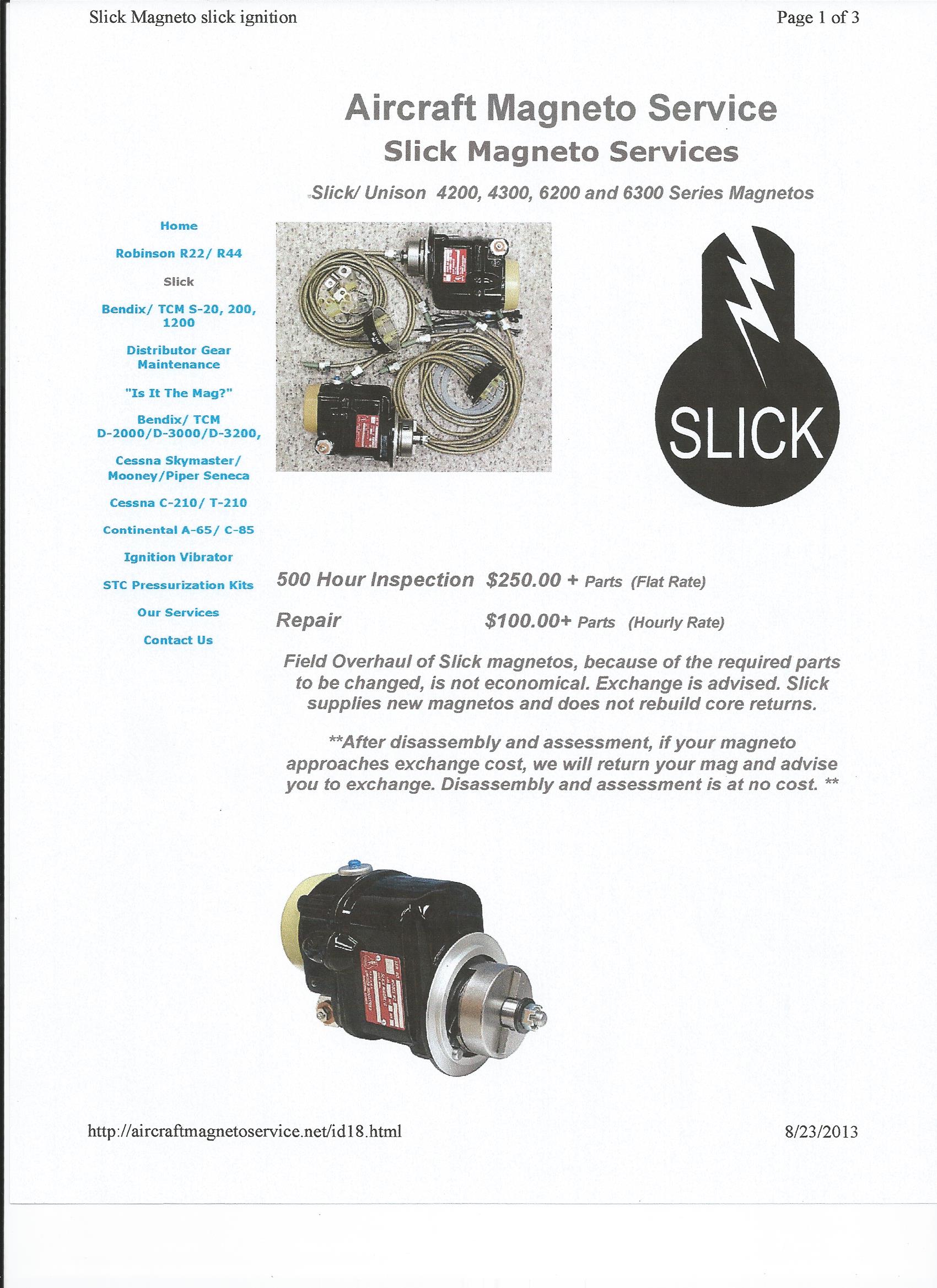

To do a "complete " overhaul of the Slick Mag requires "special tools" to remove the more expensive parts . As I found out doing my research . The "Over Haul Tool Kit" is about $500.00 . :o The parts that need to be R & R with the "Tool Kit" add up to more than a new Slick Mag . From what I have read , Slick does not accept cores as it is more cost effective to buy new . :P No BOOM here ! Just $$$$ .

More info on the Slick Mags...
