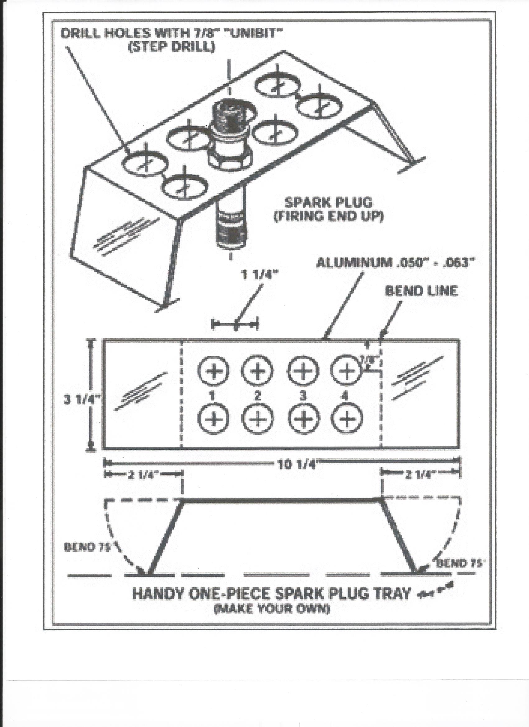

Something to make when it rains or you have a snow event . We have neither in San Diego so pick any day . ??? Easy to make and cheap ! For the Skin Flints in the crowd you can use cardboard ! ::)

I used a spade bit in a piece of 2x4. Yours is much more elegant!

I made one out of wood also. I like your's - a metal airplane deserves a metal spark plug holder. Please keep up the research and development.
