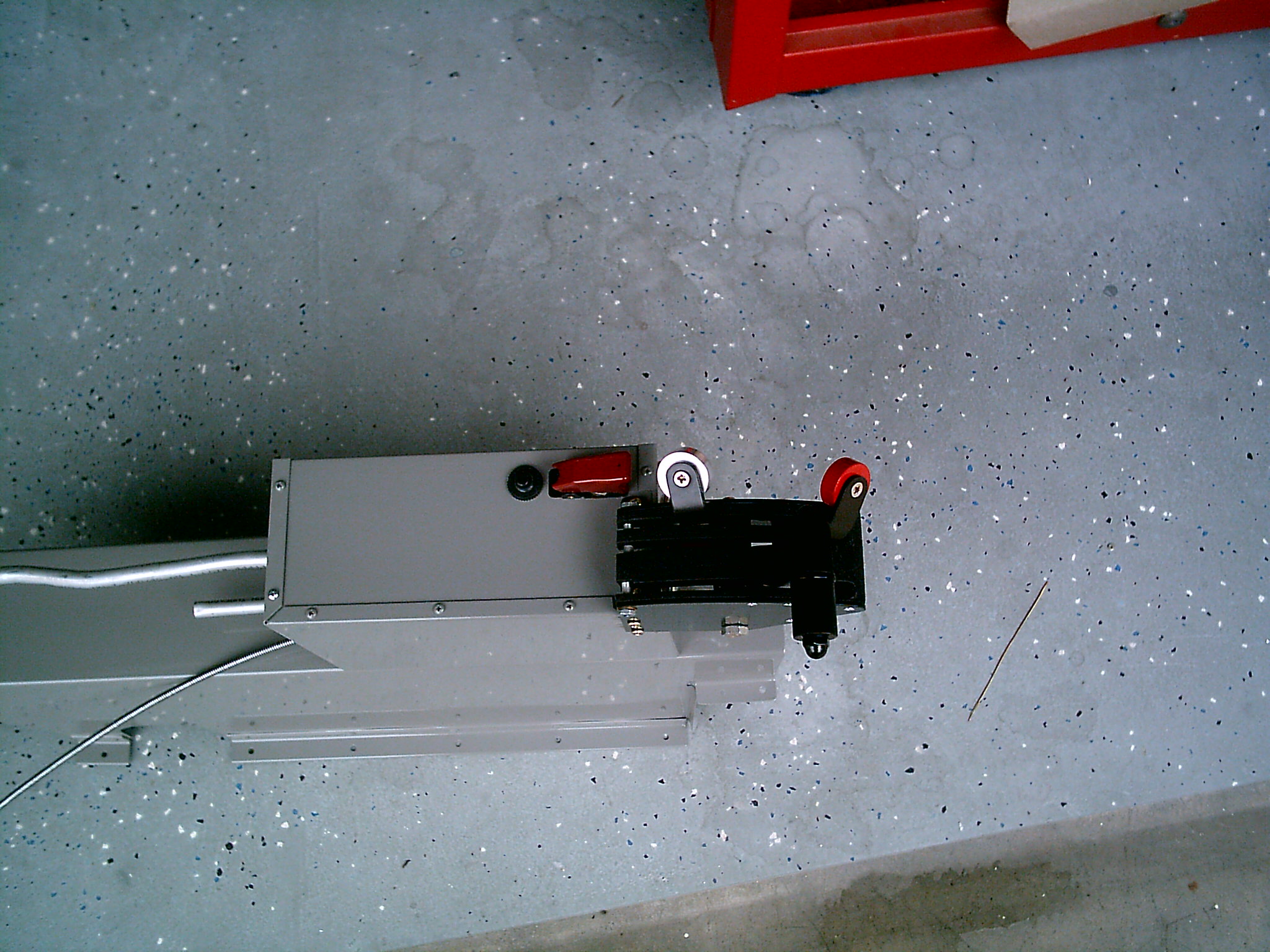

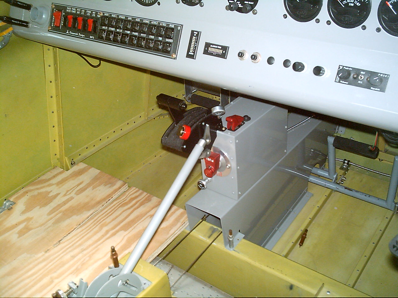

PostPosted: Thu Mar 12, 2015 8:31 am
Just like Bill said . I used rod end bearings also with standard ACS push/pull cables threaded on both ends . No bell cranks involved . My quadrant is small enough that it could be "side mounted . " Don't look for my quadrant in any catalog , I made it from a solid block of acrylic and the control levers were also made and bent in a vise . I ended up making one because I couldn't find one small enough . I have Muey Macho Hands ! The quadrant has worked perfectly for over 200 hours ! :o Sorry I don't have and pics of the assembly process . :'(
