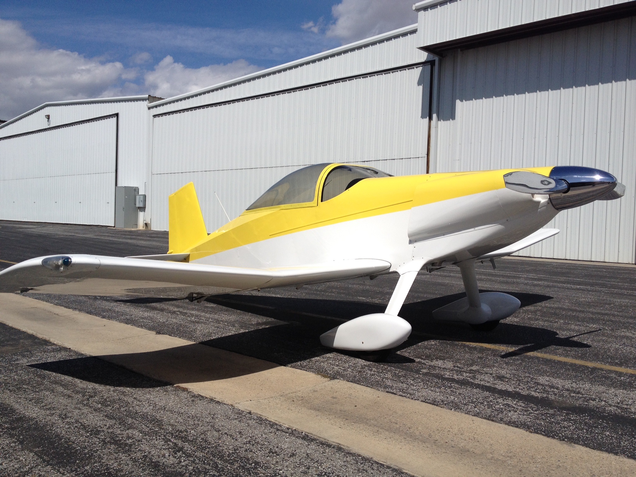

Look at my album. I have attached some more pictures of new Thorp "Yellow Bird." And also some more of ole Six Charlie Mike.
