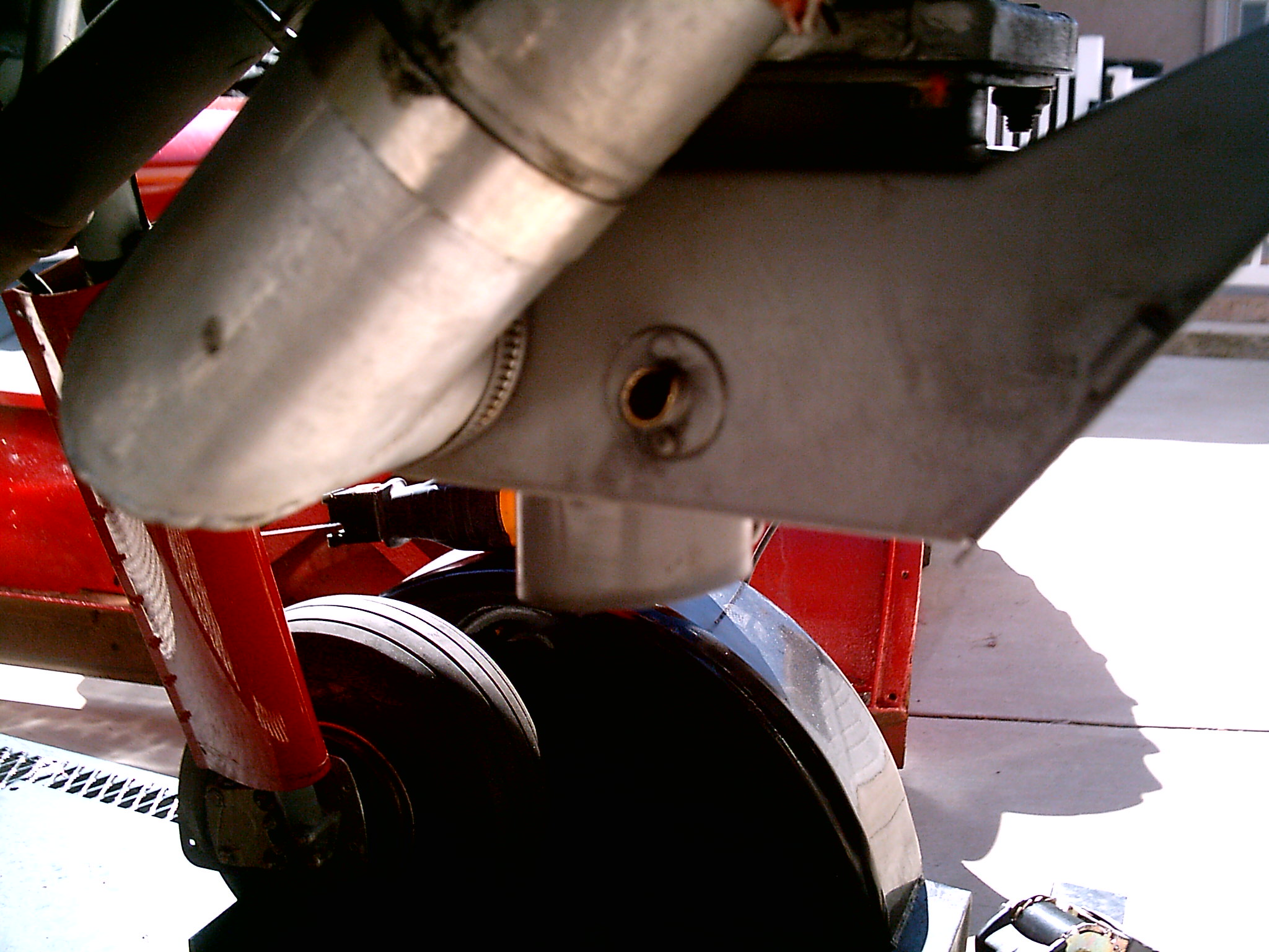

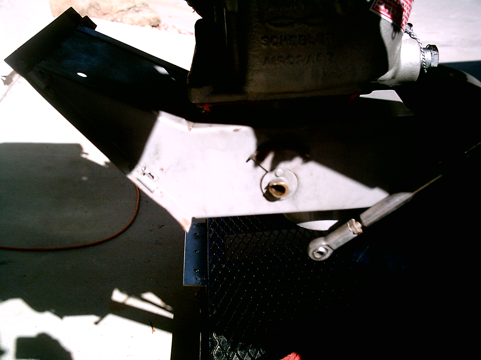

Cubes : First thing I saw when the filter came off was the butterfly valve "crimped"/welded to the shaft . Got out the Dewalt Demo saw with a metal blade and cut the shaft to remove the BF valve . I like John's idea of the rubber grommets . ;) Right now I just need to drill out the rivets holding the bronze bushings in then I can use the existing holes for the grommets . Rest of the day will be spent making a new BF valve . Monday off to the metal supply house to get a new "rod ." The new BF valve will be attached to the shaft via mini bolts and high temp lock nuts .
I wish I had adequate aluminum welding skills to make a new box , but my limited welding skills with the soft stuff is limited to wrapping it around a potatoe ! Attached are 2 pics of the bushings . Both were FUBAR ! :o Pretty piss poor material to only last 175 hours . ???

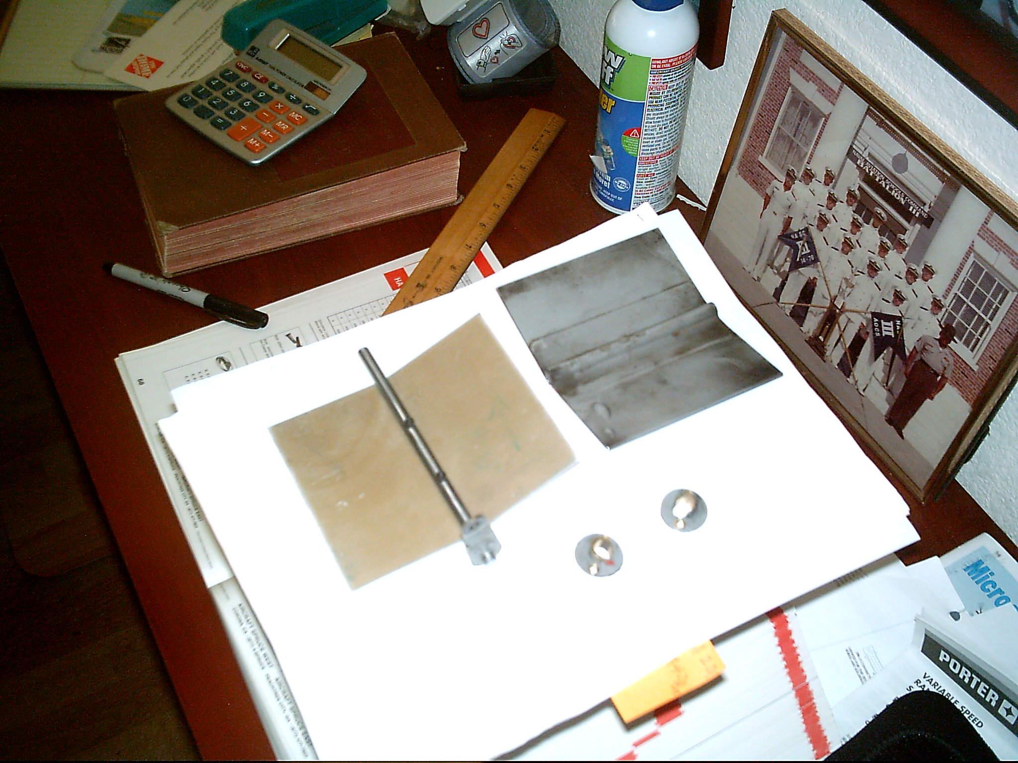

Well...the old bushings are out along with the BF valve . Also drilled out the old shaft on the control arm to reuse . New BF valve has been bent up and attached to the 1/4" shaft with 4-40 heat treated cap screws and high temp locking nuts . Tomorrow will get the rubber grommets and cut the shaft to length and weld the control arm on . The heat box is in good shape other than the FUBAR bushings . There is enough room to attach the BF valve in the heat box .
 Post subject: Re: Usher Carb heat box
PostPosted: Mon Mar 10, 2014 9:52 pm
New BF valve in with AN 931-4-7 rubber grommets to replace the bronze ones . BF valve is attached to the shaft using heat treated cap screws and high temp lock nuts should I have to remove the shaft to replace the grommets ! ;) Sad that these heat boxes are not made so you can replace worn components ? ??? I guess the good news is this is the weak point in the design and can be replaced with a little work ! :P Total cost...about $3.00 for the parts . Much better than buying another short term carb heat box for $200 + saw bones ! ;) BATA BING, BATA BOOM !
