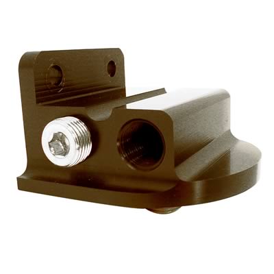

I have a canton remote oil filter on my plane with a tempest oil filter. I am leaking oil where the oil filter seals against the remote oil filter mount. I have assured there are no burs, etc, on the mount and I have tried several filters and it still leaks. The canton filter mount specifies the male threads are 3/4-16 and the tempest filter specifies its female threads are 3/4-16.
But, when I screw the filter onto the remote mount threads, the filter is able to wobble. That does not seem right to me. It seems the oil filter is slightly too large for the remote mount, but that doesn't make sense to me because they both specify their threads are the same. I plan to put calipers on them tomorrow, but does anyone have any thoughts about this? I believe this is the reason I am leaking oil around the oil filter seal.

I would also check the filter gasket diameter vs the remote mount mating surface. Note, just because the spec says so doesn't make it true, I would also check the threads on the mount nipple. The part could have been put in the wrong box.
PostPosted: Mon May 27, 2013 10:35 pm
Ryan: I use the same Canton adaptor and may have told you about mine ? I use the Tempest long filter with the 3/4-16 threads and have had ZERO problems with the unit . 130 hours and no leaks what so ever . I suspects the Canton remote you have may not have the 3/4-16 threads or the filter is not the correct threads . Take a piece of 3/4" iron pipe and thread it into the filter to check . You can also remove the pipe nipple in the Canton remote to check it for the correct threads . I am very happy with the Canton unit . ;) NO WOBBLE IS ALLOWED ! :P The filter should "screw" up snug into the remote just like a car filter then using a torque wrench finish the job . BOOM !

well, all the thread diameters and pitches matched, the seal diameter looks good and is smooth. I can get the proper torque on it. Maybe I have a leak from another area and it is leaking down onto the filter. I am now suspecting the unused ports (like in the picture above). Can I use some sort of thread tape or paste in the plug threads to help seal those plugged ports? I certainly don't want any thread tape bits coming off and getting into the oil.

It very well could be one of the 4 ports . The "IN" and "OUT" for the lines or the 2 outlets for the plugs . This should be easy to see . I use Fuel Lube on all my fittings . A small tube will last you a lifetime ! I do not recommend Teflon tape or Permatex . It may be possible the oil is "running" down one of the hoses from the engine adapter or one of the AN hose fittings is leaking ? New hoses, old hoses ? All the spin oil filters I have used "wobble" a bit until they are tightened close to the base . If I remember correctly , the "nipple" on the adapter is a standard 3/4-16 galvanized pipe nipple . I originally had a Lycoming 90 degree adapter on the engine (did not fit with the engine mount) and I recall it had a 3/4-16 hardware store pipe nipple ?

Rich, you described the wobble perfectly. That makes me feel better. The fittings match and the seal is good. The more I talk about this, the more I am thinking its one of the plugged ports that is leaking. The nipple on the remote mount does have the 3/4-16 threads that matches the oil filter. I think I will try some lube/paste on the plugs and see what happens. Thanks for the help thus far. I'll report back.

it was leaking around the plugs and dripping down onto the filter. All is well now with no leaks. Thanks all for the help
