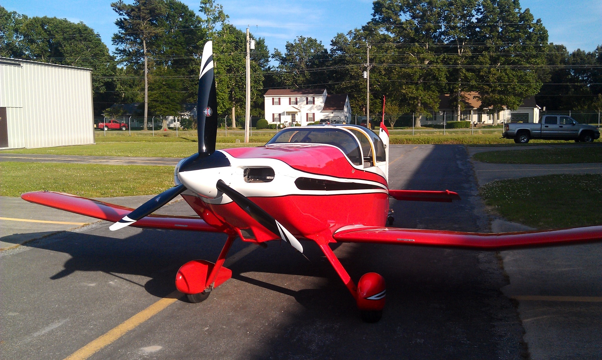

The new look...
PostPosted: Mon Jun 10, 2013 9:06 pm
man, that looks sharp!
PostPosted: Mon Jun 10, 2013 9:53 pm
What's an rv spinner doing on a Thorp!?!? You should be ashamed Scott! ;)

Well, Craig said he could cut and paint the spinner (he has them in stock). I kicked myself afterwards for not buying one of your carbon fiber spinners and having sent to him. I was in a rush to make Gary's fly-in. It looks good, but you're right, the Thorp spinner does look better. I sure hope Walt understands... :)

Looks great! what pitch and diameter did you get? I'd be interested in performance numbers once you have them for comparison. Mine is a 66 x 70.

It's a 68 X 70. I seem to have lost about 100 rpm and 5 mph top end, but climb rate is still 2000 fpm at 110 mph. I need to fly more to nail down reliable numbers. The prop is noticeably smoother and quieter and because I removed the harmonic dampener, the weight change was a net loss of 6 lbs. Plus, it looks cool!
PostPosted: Tue Jun 11, 2013 9:27 am
Great look Scott!!.....though I think I would have made the black half of the spinner white, and the white half black. But that's just me.
shinton
PostPosted: Tue Jun 11, 2013 9:32 am
Joined: Mon Mar 29, 2010 11:53 am
Posts: 97
It would be reversed if we were in the southern hemisphere, but since were not, that the way is should be. Besides, when it spins it looks the same!
