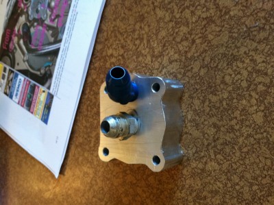

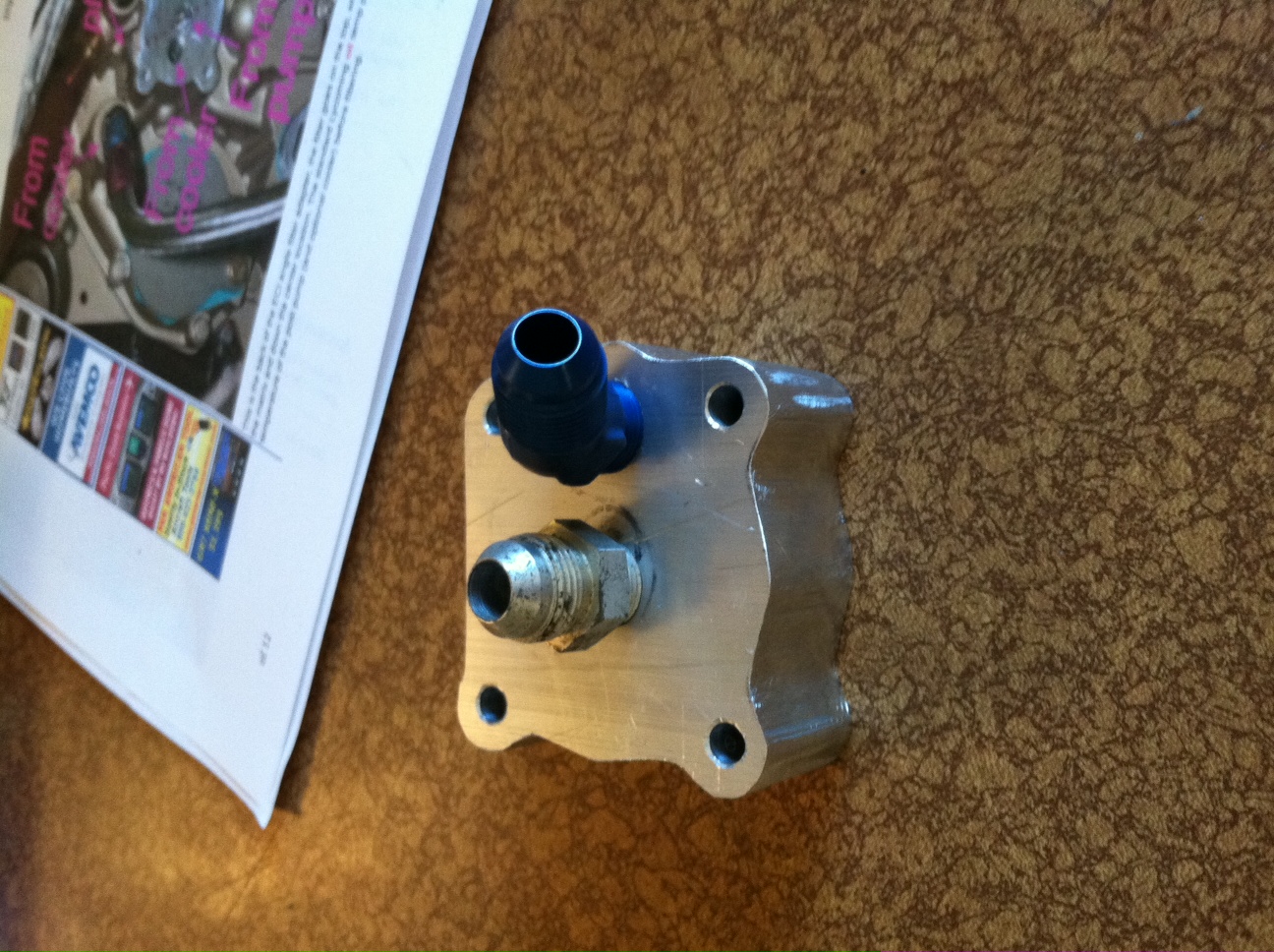

I got an Air Wolf oil filter kit, but I didn't like it for the T-18.
Didn't seem right for a plans built plane, so I bought a $5 block of 6061 aluminum at the Metal Supermarket and started band-sawing, drilling, tapping & filing. 8)
"Feisty" doesn't use a Vernatherm, just the plunger ball to control oil to the cooler, so I don't want the complex adapter. Also, I can mount the oil temp sensor on a boss on the oil filter housing I have in mind.
[img][attachment=0]photo.JPG][/img]
The picture is 90 degrees rotated to the left, a typical iPhone phenomenon..
I can take several more ounces out of it by porting out the oil side and cutting down the outside around the oil fitting ports.

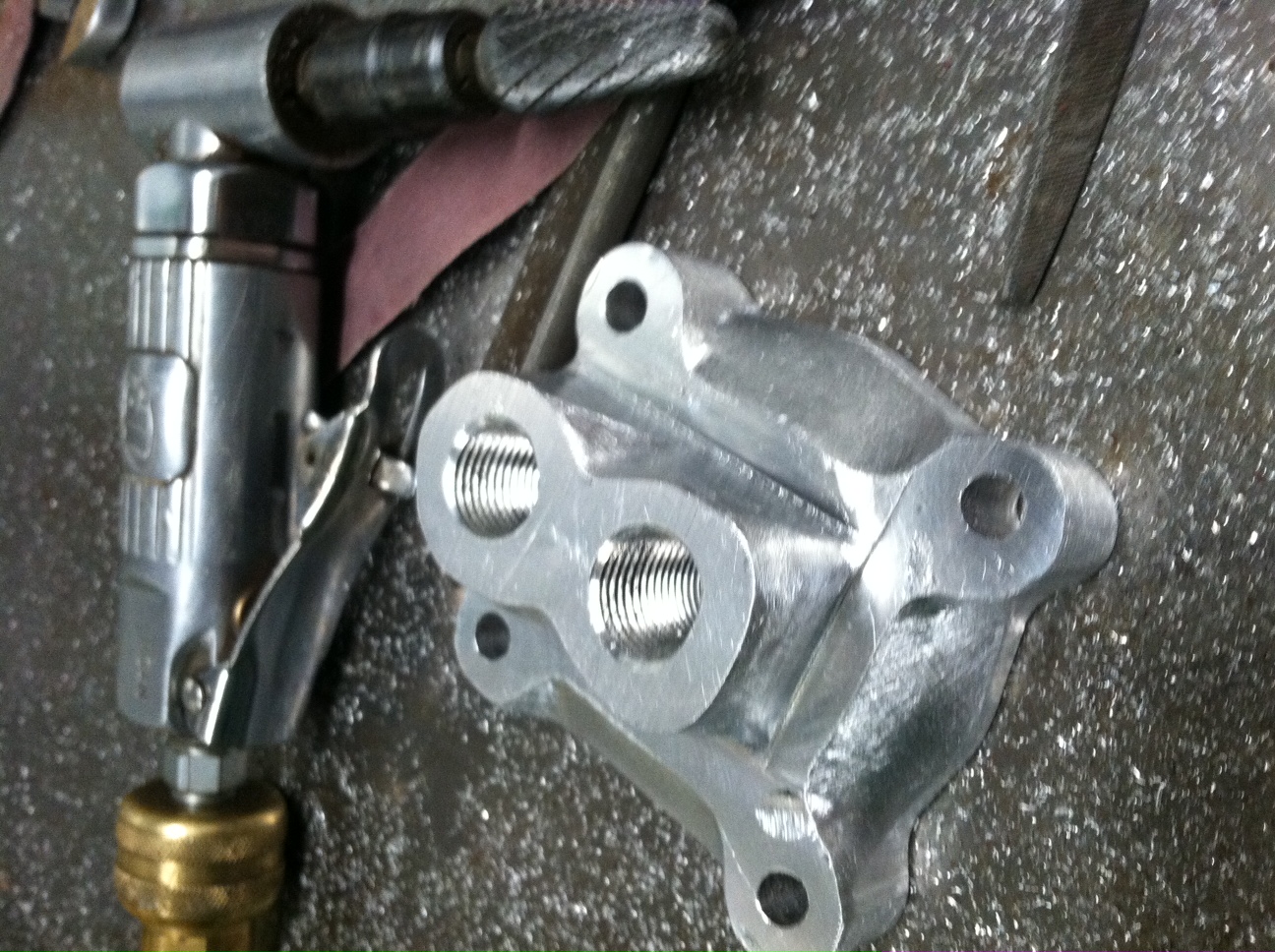

The "Air Dog" oil filter adapter after Gary J took it to task on his mill, then I had a whack at it with a belt sander, a cut-off disc, a die grinder and some sand paper...almost done.
Then we finished the remaining 8 T-18 rear spars for outer wing panels.
Gary is an enthusiastic T-18 parts hoarder and very good with making things, so I'm hoping to work with him on building T-18 ribs next.

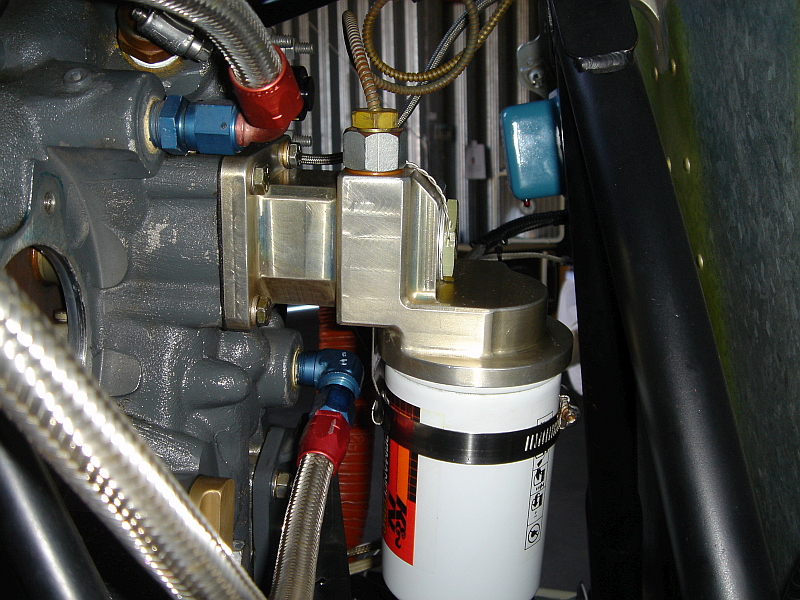

This is what I designed and made for my T-18 from a hunk of aluminum quite a few years ago when engine-mounted spin-on filter adapters were not available that would fit the T-18 without hitting the landing gear assembly (and the vertically mounted filter was also unique at that time). It's worked very well for over 20 years.

That is a fine bit of work you made there!
I was planning to buy the filter housing from Summit Racing, but now you've gone and dunnit!
I'll have to get another chunk of aluminum and make that part too! I didn't find a pre-made one that exactly fit my layout.

Those are very nice... I accused them of copying my design one year at Oshkosh (jokingly - sort-of). The concept is similar, but the design is improved, lighter, & more elegantly done. Not sure how well they would fit my particular set-up, but that's the way I would go nowadays. I had less "disposable income" back then, and it was just kinda' cool to be able to design & make something that nobody else had at the time. It was over 20 years ago! 8)
