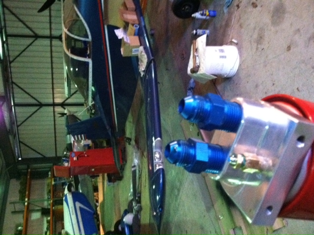

PostPosted: Wed Feb 07, 2018 11:18 pm
Here is a picture of the Earl's oil filter mount with the temperature sender installed toward the back. The rear mounting flange has been removed, showing the 1/4-20 holes.
'Feisty' is in the background. Most of the upgrades have been completed and the engine is about ready to run again. I still have the left wing panel to work on...
The picture is suffering from the iPhone effect (rotated 90) It will appear properly if you click on it.

"Looking good Billy Ray !" ::)

that is pretty nifty with temp sender hook up right there.
