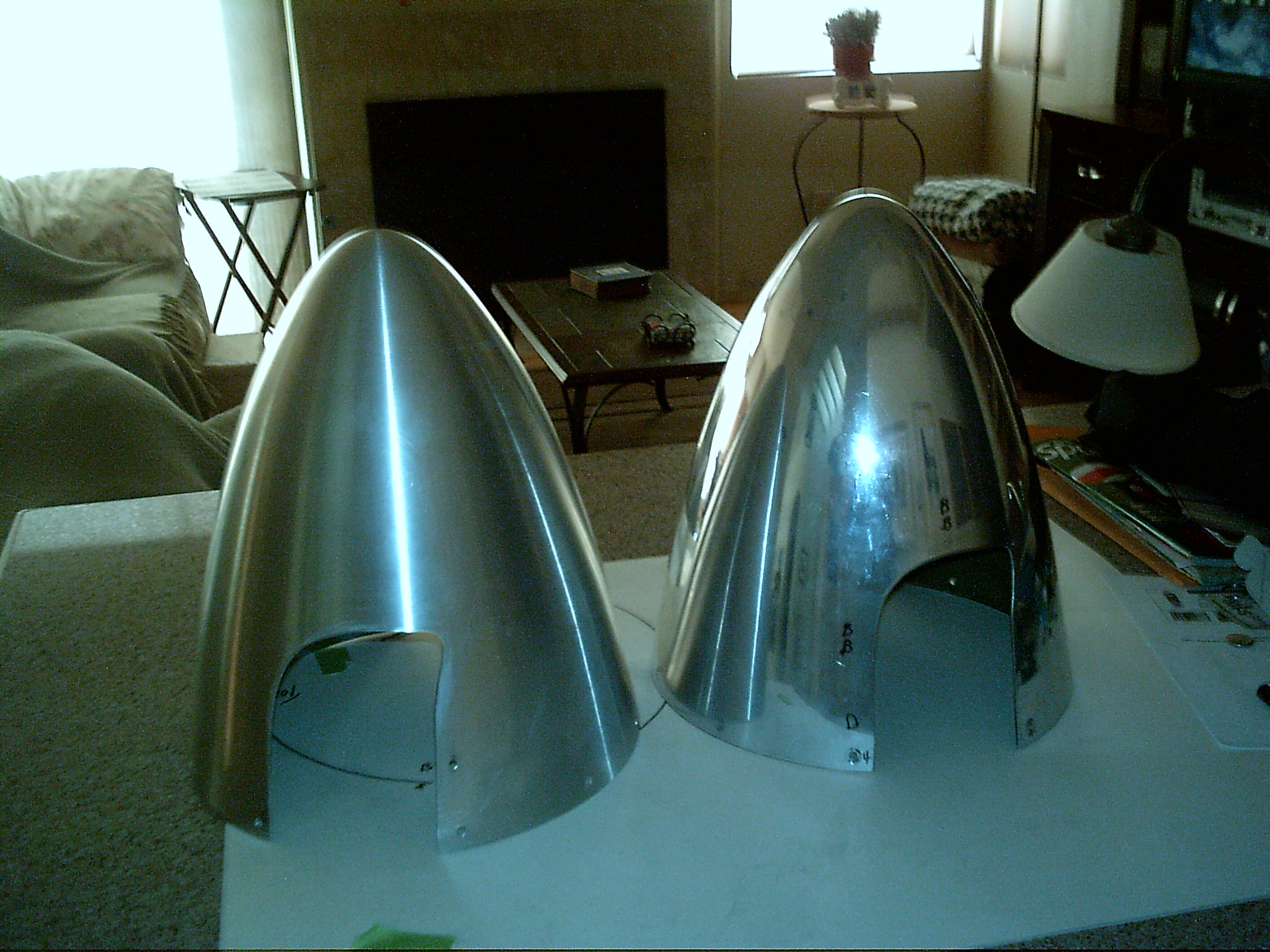

New spinner arrived late Saturday ( that's why I like FedEx . They deliver on Saturday) . :o Spent the rest of the afternoon making poster board templates for the cut outs and the screw holes and transferring them to the new spinner . ??? Very careful making the templates and it paid off . Everything lined up correctly ! 8) This time I made the inside radius for the one cut out (crack area) larger and spent extra time "polishing" the entire cut out . Tomorrow I travel to Oscar's to see if I can still get the $40.00 "polish" job . $45.00 would still be a good deal just to remove the tooling marks . I'll report back . :P
