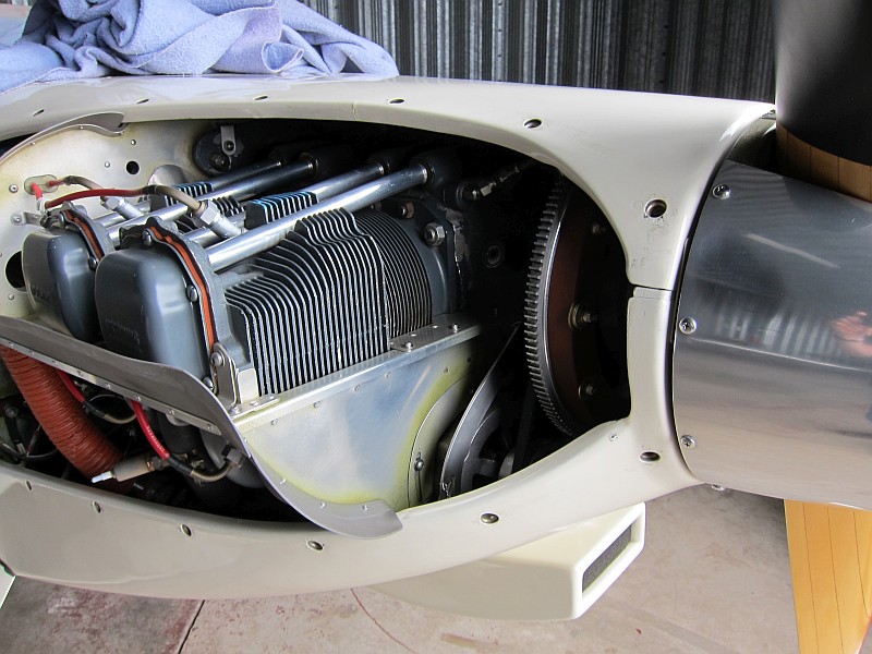

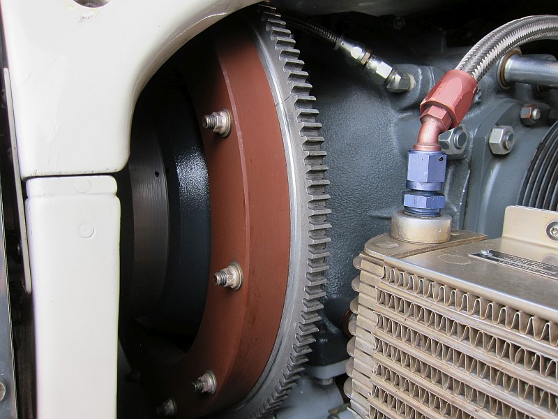

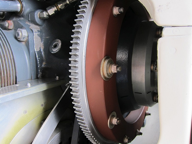

I got to the hangar today & measured my ring, as close as I could. These should be accurate enough -
Thickness: 15/16"
Width: 1 7/16"
O.D.: 11 1/2"
I.D.: 8 5/8"
Here are some pictures... the first shows how some washers are used for balancing -

I noticed the washers on your weight ring and I was wondering, are they all on the same side?( front side) If they are, you would have a better balance situation if you split the balance weight/ washers so that they are on both sides of the flywheel/weight ring assembly. As the assembly rotates the balance weights will want to exert a force towards the center of mass of the rotating assembly.

2 things Jim... I'm balancing the entire rotating assembly - ring, prop, spinner, etc. They are closer to the center of mass as is. Secondly, there are potential clearance issues on the back side with the alternator belt, etc.
It has worked very well as you see it. I can get the vibration down to 0.02 to 0.03 ips.

Thanks Jim... I agree. I think you should statically balance the propeller as well as you can before installation, but the ring should be pretty perfect if it's machined carefully. Once it's installed, you're limited to a dynamic balance, involving the entire rotating assembly as I said before. With a prop extension, applying the weight to the ring gear is not always effective enough, but it worked well for me since I had already balanced everything without the inertia ring installed. Sometimes you have to add weight to the spinner backplate instead or also. Again, in regard to adding weight to the front AND back of the ring, it is never recommended to add multiple washers under the head of a bolt, and there is a potential clearance issue on the back of the ring gear.
