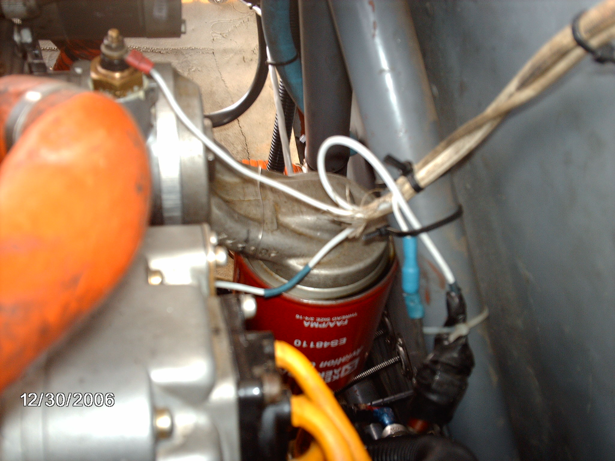

i got a FORD adopter for the oil filter. Its right angle can be swivelled to any position . than locked to place .Its the last one i got . H
ad 11 i bought them when i was building . trouble free. can be used with the long or the short filter . J.P.

Lee you are correct .The standard oil filter adopter i picked up from an engine supplier.. As i recollect it was $25 .Used.
I still have 1 ford adopter for sale . As you can see on the picture it fits very nicely. J.P.
