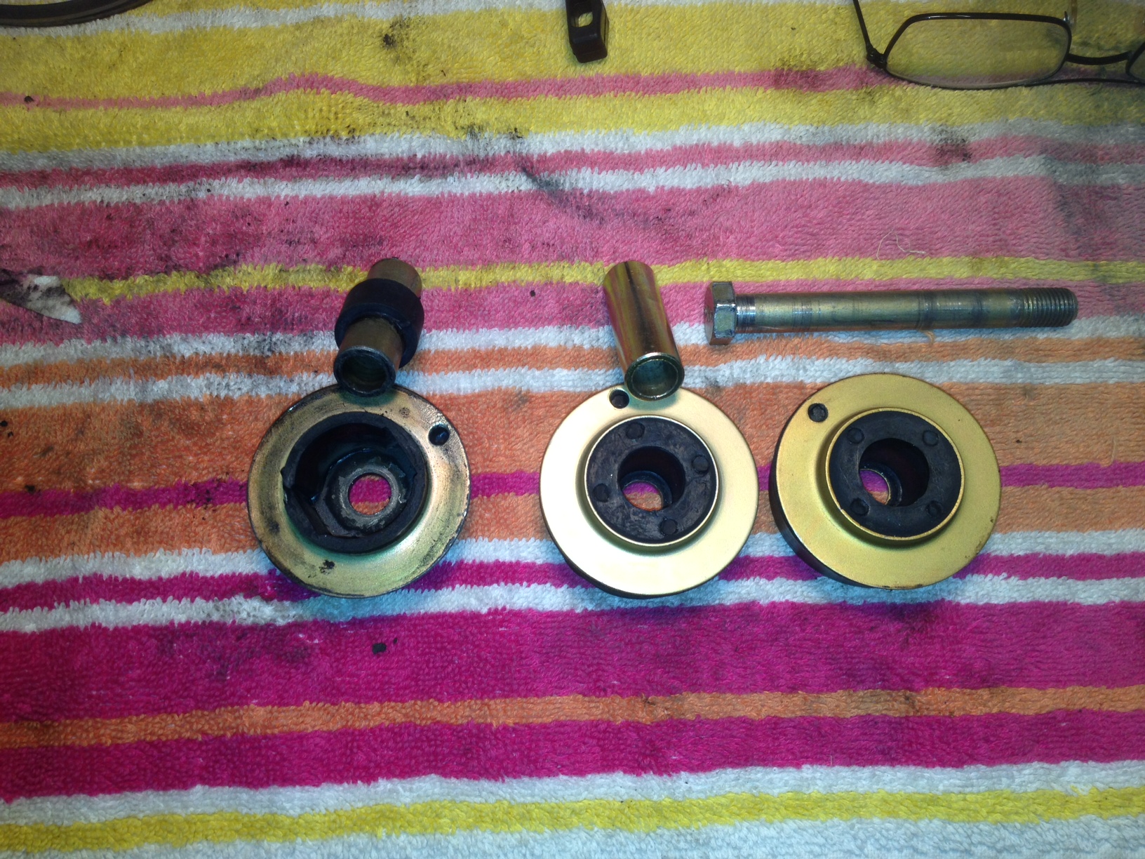

As some of you probably witnessed at OSH, the mistress's frontal blessings were sagging a little...it's an age thing. Hence, (and as I am replacing a cylinder) I went Johnny Quest to find motor mounts. This was not as easy as first anticipated. Nothing in the logs and a plethora of choices with little dimensional info to reference - As usual, I wasted countless hours trying to make sense of the T-18 plans, the forum, spruces catalogue and google, I finally broke down and called the Lord guy (No, not God - he always just laughs when I call anyway....) and told him I had 2.25 OD/ID donut mount with a..??...oh crap, I forget...something like a 1.25 inch hole - He recommended a mount from Lord, and for kicks and starters, I X-ref'd to VIP and Barry and settled on the Barrys - this all took time given my cataclysmic world, and given my schedule to get the plane properly repaired and off to KVIS - I UPS blued them Tuesday last.....got to the airport that night and realized that the mounts on the way were not going to work, as the Lord guy (not God) had effed up and I had 3 inch pucks coming - POOPSTAIN!!
I started looking agin at AirSpruce and looked at the "homebuilders" mounts at 100 jeters per corner - same as Lord (not God) J7402-5.....checked the plans again - huh...similar....found a reference on the old sight from Richard Ecklund that these are it....then I see the "beefed up version for aerobatic mounts - same as the 100 jeter per corner ones only 69 jeters per corner - less than half the price of the Lord (not God) mounts.....and "beefed" up to boot.....without much in the sporran, that sounded good to me - I got them today and they look perdy good and will fit - a little different style than the old one (on the left) from the backside of the mount (I have not gotten the one off next to the case yet). I'll give a report once mounted tomorrow and the new cylinder on and broken in next week as to how they are doing, but sure am hoping thy blow a nice pleasant breeze up the kilt.
One thing I cannot seem to find is what torque value to put on these......any suggestions?
You should torque them to the standard torque value for that size AN bolt - they should "bottom out" against the properly sized spacer, giving the proper amount of compression automatically. I can look up the torque value if you need it Frase. Making sure you have the correct length spacer is a little trickier... depending on your mount, you may or may not have the correct ones with the new parts. If yours were correct before, you can use them as a reference (or perhaps just use the old ones if the new ones are too short or too long).
PostPosted: Fri Aug 30, 2013 7:54 am
Well, John...that's what I thought at first, but then began to wonder if that was too much compression for the squishy stuff - the spacer is the same length as the previous one - at least on the bottom starboard mount - the pucks are same dimensions, except a different rubber "fit" configuration.
PostPosted: Fri Aug 30, 2013 11:07 am
This seems to be a recurring topic, there are several options for sandwich mounts the cheapest is the "homebuilders mounts"
http://www.aircraftspruce.com/catalog/e ... ndwich.php
Rumor has it that these are simply the mounts that Lycoming ships their motors with ... regardless they seem to work fine for me.
As John pointed out, (max) torque values are not unique to application each bolt size (in this case AN7) has it's specified torque value (in this case 450-500 in lbs). That being said and I know I've gotten in trouble for this in the past ... I prefer to use the "comfortably snug rule".
I recently pulled N51863's motor and while I was at it I decided to change out the Lord mounts, I agree Frase .. there is no easy way! It requires patience, muscle and a lot of cussing!
