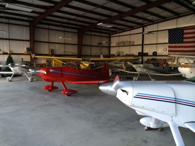

PS: Pic is from when Brazell came to visit for the LA County Airshow. Tom's T-18 is in the back.

Now that's how hangars should look.
