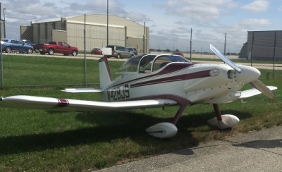

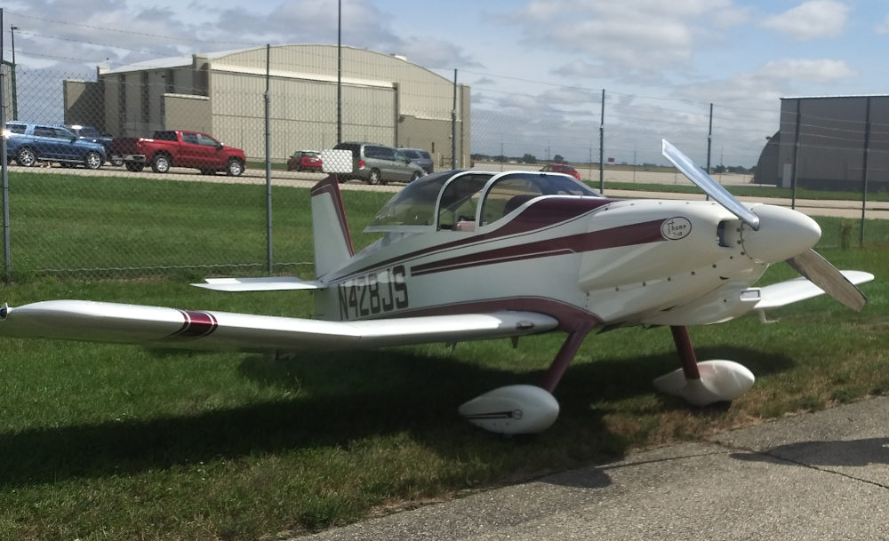

I just bought 8JS.. a great flying Thorp... I had a vans RV-4 for a couple years, enjoyed that, sold that... now I have the T-18 and I love this thing!
Mine's got VGs..stall strips..all the goodies.
I'm shy about the prop, cutdown M76, I am thinking about going Catto or Whirlwind in the future.. any suggestions let me know, I have read and heard great things about both. Anyone else still flying with this type of prop here, and would you say it's all good to fly on the M76 or should I consider swapping it out asap?
8JS has an O-320 with 10:1 pistons, probably putting out between 160-170hp...all great compressions and very nicely maintained.
I have been thinking about buying a Thorp for years, I am glad I did..

Congrats, Jenn! I’m sure you will enjoy that bird for years to come.
PostPosted: Tue Sep 22, 2020 4:45 pm
Congrats! I'm curious to hear your flight reports with the stall strips installed. You have a good looking plane.

I would not worry about the prop on that plane, it's the one and only FP metal prop 'approved' for the Thorp. That's a good solid Thorp you have, if I had the need for another I would have snatched it up myself!
