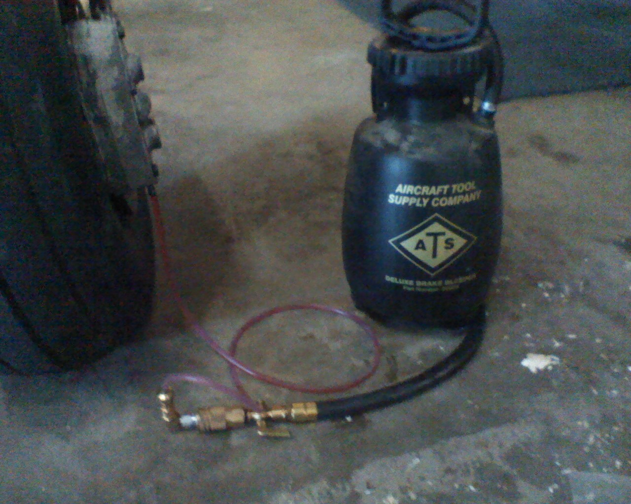

I think bleeding brakes is bleeding brakes whether it is done from the top or the bottom. I prefer to use this with a catch bottle inside...
File comment: The adapters that came with it aren't any good but the tank works great.

I dont bleed brakes, pump the fluid in from the caliper up into the cilinder using a thumb pump oil can, no bleeding required the air evacuates as the system fills with fluid, just takes a few minutes......Dan
That's how I always do it on the bikes and cars. Pressure bleed works like a charm!

When I said an hour I figured in taking off the wheel pant cuffs and bleeding BOTH brakes . Not a bad idea (flushing out the old dirty fluid) if they haven't been done in the last 10 years ! ??? I bought one of these ATS pressure bleeders when I was building my rocket (worked like a champ when I did my first brake set up and had the adapter to attached the ATS hose directly to the bleeder screw , no clear tubing required .) , but the last time I bled my brakes (bottom up) I used a pump oil can as shown on the EAA site . Found a quality USA made oiler with a metal flex spout and attached the clear tubing as indicated in the video . Worked as well as the ATS bleeder and cost about $20.00 to make . :P Funny thing about the ATS bleeder is that the original one I had failed at the welded plastic seam and leaked fluid all over my floor ! :o Wrote to ATS and even though the bleeder I bought was out of warranty they sent me a new bleeder tank (less the hose) . ::) I guess they found the early tanks had a habit of failing at the seam and up graded the tank material . The bleeders now carry a lifetime warranty . ;)

I have tried a lot of different things over the years. The thumb pump oil can works well and I also had good success with a hand crank fuel pump for radio control models. I did try a few different homegrown setups similar to the ATS tank but all of those failed (usually they couldn't tolerate the 5606). Since I buy 5606 by the gallon and it seems to be hard to locate cans that can be opened and resealed, the ATS tank makes for a good storage container as well as gives me the freedom to get out from under the aircraft so I can keep an eye on what is happening at the master cylinder. It also acts as a "no spill" dispenser for friends who need to "borrow" some. I think I had mine for 6 years now. Not all systems are feasibly bled from the bottom but for those that are, the oil can, fuel pump and pressure tank work well. What is "best" depends on your level of usage.

It took me 35 minutes including the time it took to get out the tools, manufacture a new catch bottle (2 attempts ending with a cut up pop bottle wedged under that master cylinder), bleed one side and put everything away to bleed the right brake. My "normal" catch bottle isn't compatible with the Matco master cylinder and I didn't know that was what I had until I crawled in to connect. I need to position a gantry crane over the aircraft so I can hoist myself in and out instead of flopping around like a fish trying to get a hold of something to pull on.
I wouldn't bleed brakes from the bottom without a clear tube somewhere so I can see if I am forcing air into the brake system. I have too many years of experience to allow myself be the reason there is air in the system or, if I am the cause, not to catch it the moment it happens. Things like that only cost me money because I won't charge a customer for my screw ups.
