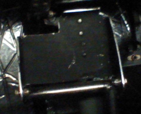

I went over to the paved runway this evening. 5 mph wind from the left front had me off the ground in less than 800 feet 3 times (one was closer to 700ft). The takeoff on the grass was about the same length with a left crosswind. I wish my landings were that smooth. I started getting a little crooked on the second landing and my right foot got hung up so I couldn't make corrections. When I got it back to the shop I swapped a couple of bolts end for end to get the threaded ends away from my shoes. I may swap those bolts for flight control clevis bolts so I can have a rounded surface against my shoe. I am not sure what I want to do about the rest of it. My toe hangs up on the fuel tank mount strap if I have to raise my right foot to use the brake (ie soft pedal). I may need to change the geometry a little to accommodate my boots. Normally I wouldn't raise my foot but I was heading for trouble and the brake decided it needed to be pumped once to get pressure just then. I didn't have an issue on the first or third landings. I don't think I have used the brakes on the grass.

Ditto what Bob said . Second thing I would do is spend about 1 hour and bleed the brakes (assuming you have no leaks in the system , master cylinder , caliper, etc.) . You should not have to "pump" the brakes to get a good pedal . A "firm" pedal is what you want . :P In fact with your heels on the deck your toes should be pretty close to the top of the pedal . Not sure if a smaller shoe would be a better fit than the boots ? :o It was a good idea to reverse the bolts . ;)

It shouldn't take an hour to bleed one brake....although it may take that long for me to wiggle into position to connect the overflow catch jar. ;) If I ever build an aircraft myself I do believe there will be an access panel for bleeding brakes! If I hadn't of screwed up the landing it would not have been an issue. Since I did, it revealed a couple of inconveniences I need(ed) to take care of.
I hated my commercial pilot training. I did it in a Mooney 20C and had to wear tennis shoes because there was no room at the rudder pedals. I just wear a size 9. I understand a home built aircraft being built around the builder but the Mooney surprised me. Everyone at Mooney must have had small feet when that thing was built.
The picture shows what I am hanging up on. I already changed the 2 bolts on the pedal and that may have fixed the problem because that should allow me to slide my foot back down if I ever need to raise it up again. I also think I need to reverse the bolt on the fuel tank mount strap (visible though the notch) just to be safe. That is what my toe caught on.
