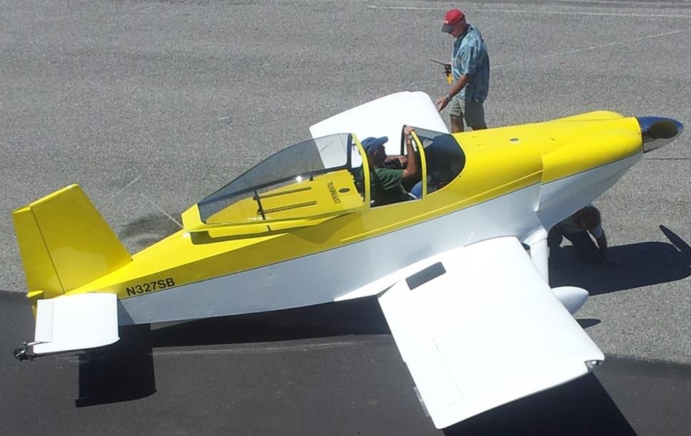

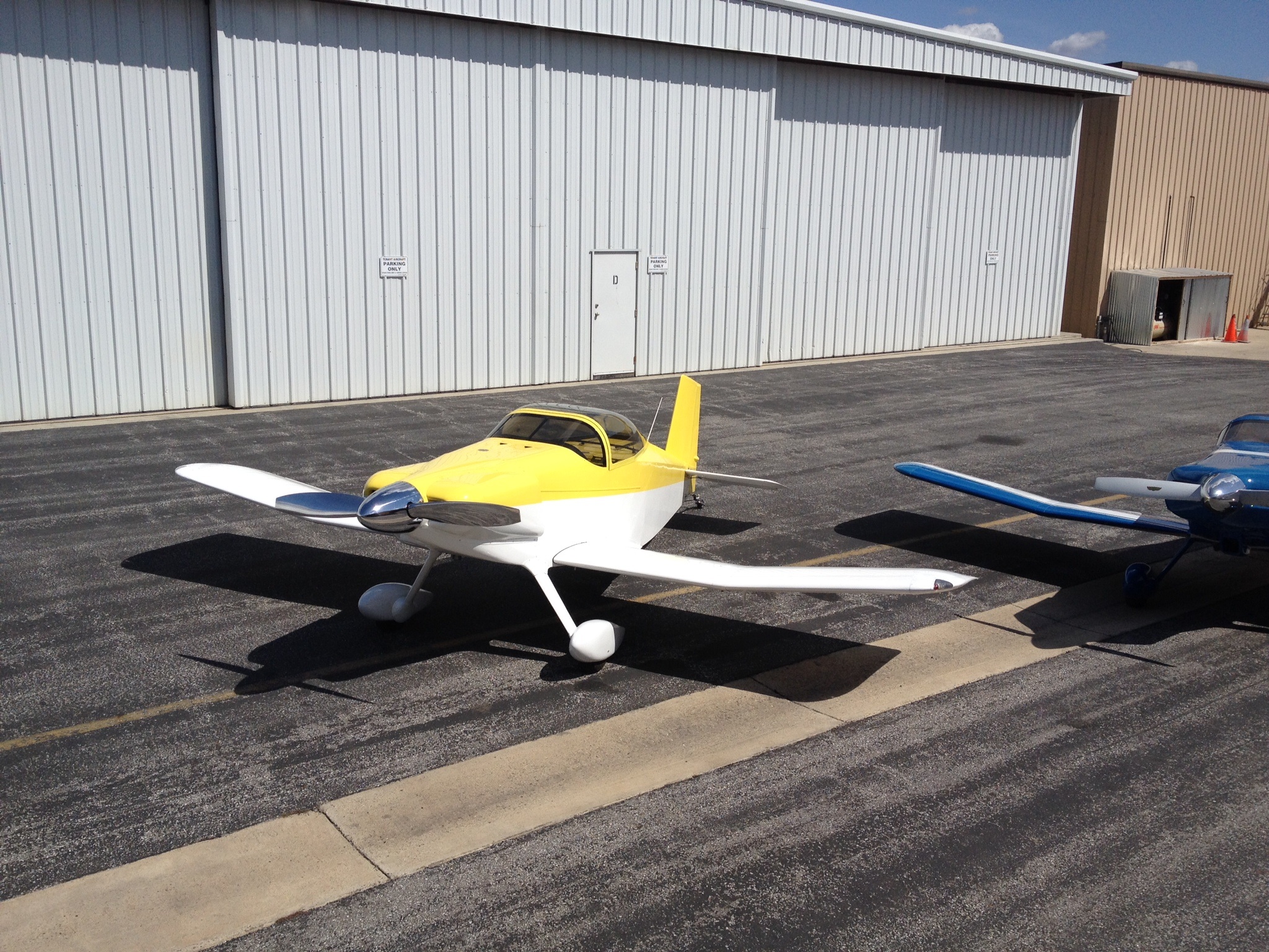

Our new bird has NACA inlet vents, two of them, just forward of the windshield. One goes to eyeball vent for pilot and one for the co-pilot. We were suspect about them, but in 100+ degree weather the cockpit get a nice airflow from them in flight. Not sure I well they would do if we were flying through a bit of rain. Probably need to make some stoppers for the them on cross country flights.

PostPosted: Tue Aug 26, 2014 6:44 pm
Posts: 100
Here is the best pictures I got. Try to zoom in and look at the cowling just 5 or 6 inches away from the front windshield. I will try to take some up close pictures and post them later.

Sorry :( Those were not good pictures. I will shoot some new ones and post it this weekend.
