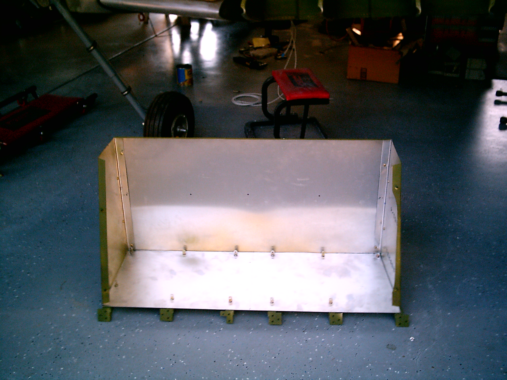

S18%20Baggage%20compt%20and%20Crow%20restraints%20002.jpg [ 1010.38 KiB | Viewed 65645 times ]
My baggage compt. is small . I don't like to carry a bunch of crap ! From the pic you can see the floor area is attached to the "stringers" with "eye bolts" and they are screwed to the floor stringers with floating nut plates . I also installed several nut plates and eye bolts on the aft bulkhead . The rest of the compt. is screwed together with standard screws and additional floating nut plates . The nut plates and eye bolts serve 2 purposes...(1) hold the compt. together and (2) they also allow me to use bungee cords to secure items in the compt . to keep them from hitting me noggin ! ???

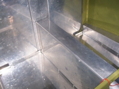

That should be a couple pics of Scott's baggage compartment. The tubs are made of .020 and have around 1/2" clearance to the belly skin, rudder and flap cable mechanisms. He reinforced the framework enough that you can lay across them while working back in the tail cone. Karen and I bought a couple of duffle bags that fit snugly into the tubs. Pack them full, drop them in and you can lay longer stuff across the top. I believe you can't have too much storage space on occasion, but that doesn't mean you have to fill it up every trip.

All of the pieces of the structure are bent up pieces of 020 and 032. The only extrusions are on the aft lower baggage comp wall. They are vertical and transfer load from either side of the center piece to the bulkhead and floor and centerline extrusion.

Tubular brace is on the aft outboard corners. An area that has proven through extensive field research to be a weak point.

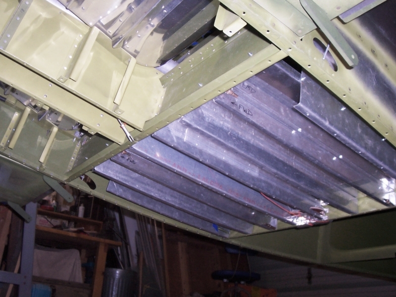

Here's a version of baggage compartment I posted in NL#99 (1996). Actually added a floor about 2" off of the fuselage bottom with short ribs between bulkheads for strength. The intention was for max volume for "baggy" things, although it does handle weight easily.

File comment: Two floor supports for baggage each side, plus side guard over flap cable and center tunnel.
