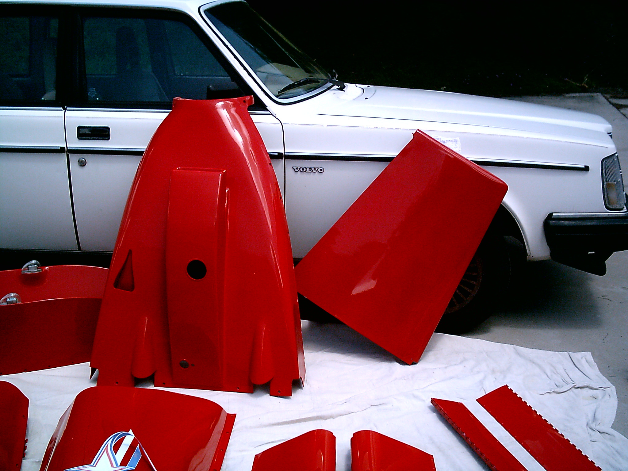

I put my NACA scoop on the bottom cowl (per an OLD NL write up) scat tube to a diverter box on the firewall and then from the inside a single hose to a "Y" splitter fitting , then via scat tubes to 2 eyeball vents on the dash . :P
