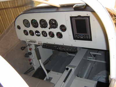

Its not a quadrant, but this has worked out for me.
MG
PostPosted: Sat Nov 23, 2013 6:16 am
I thought about doing that, but I wanted to try and not drill any new holes in the airframe. I do like to the look of it though.
