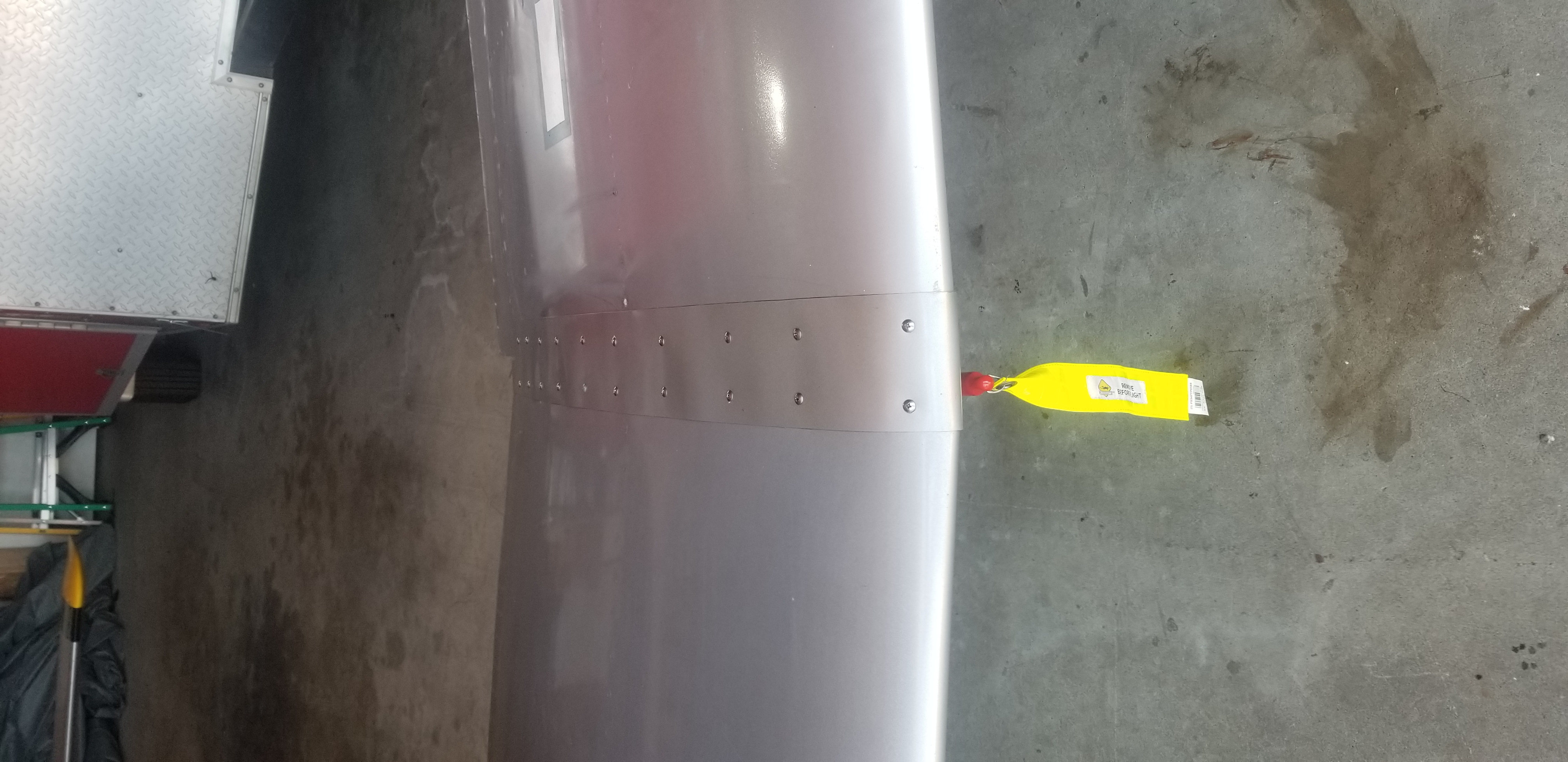

Can anyone direct me to the plan where the strip that seals the gap between the outboard and the inboard wing is set up so that it is stretched across the gap instead of screwed on?

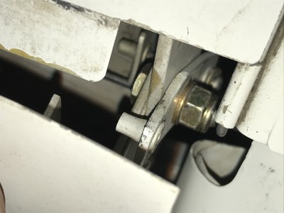

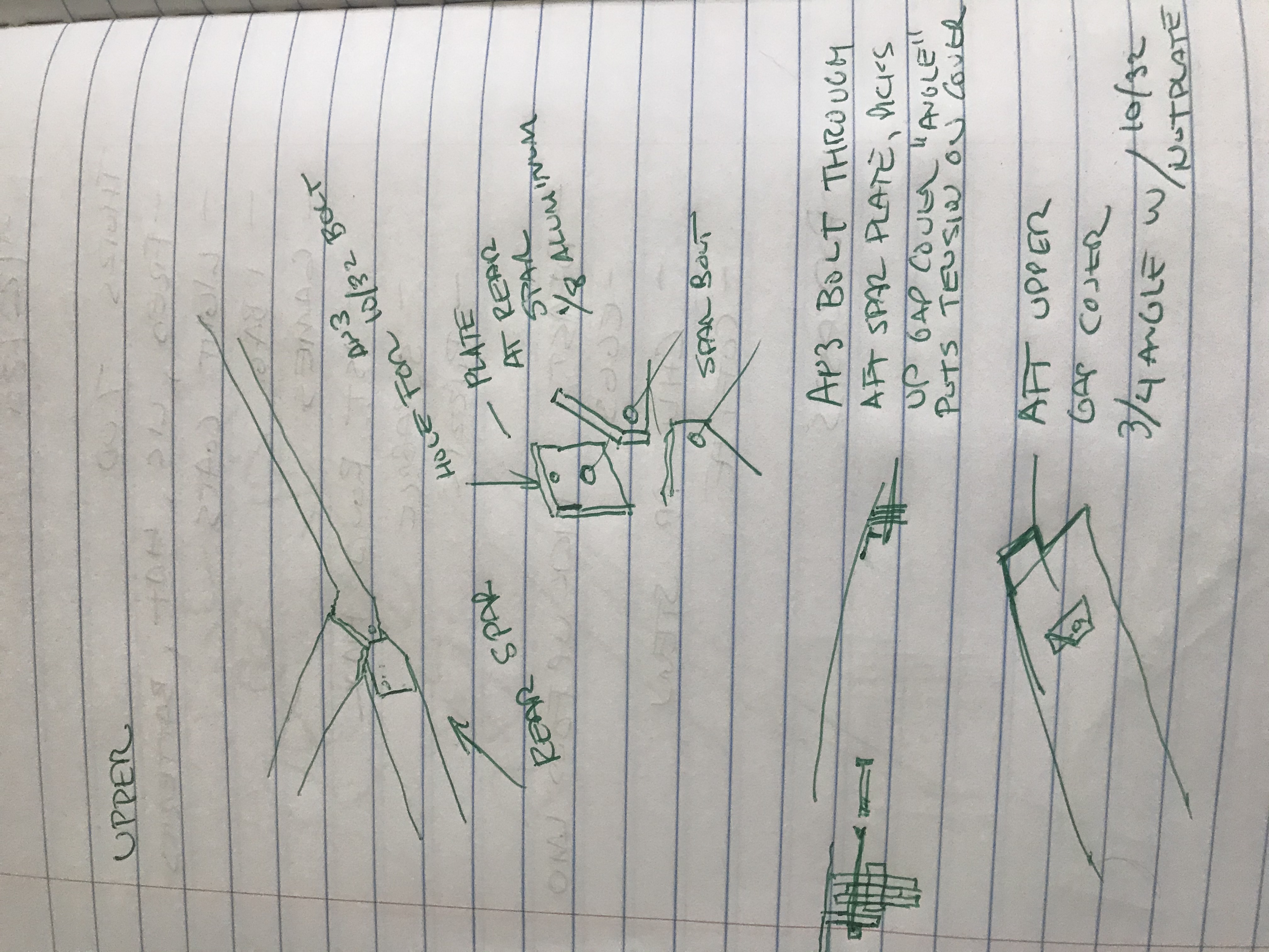

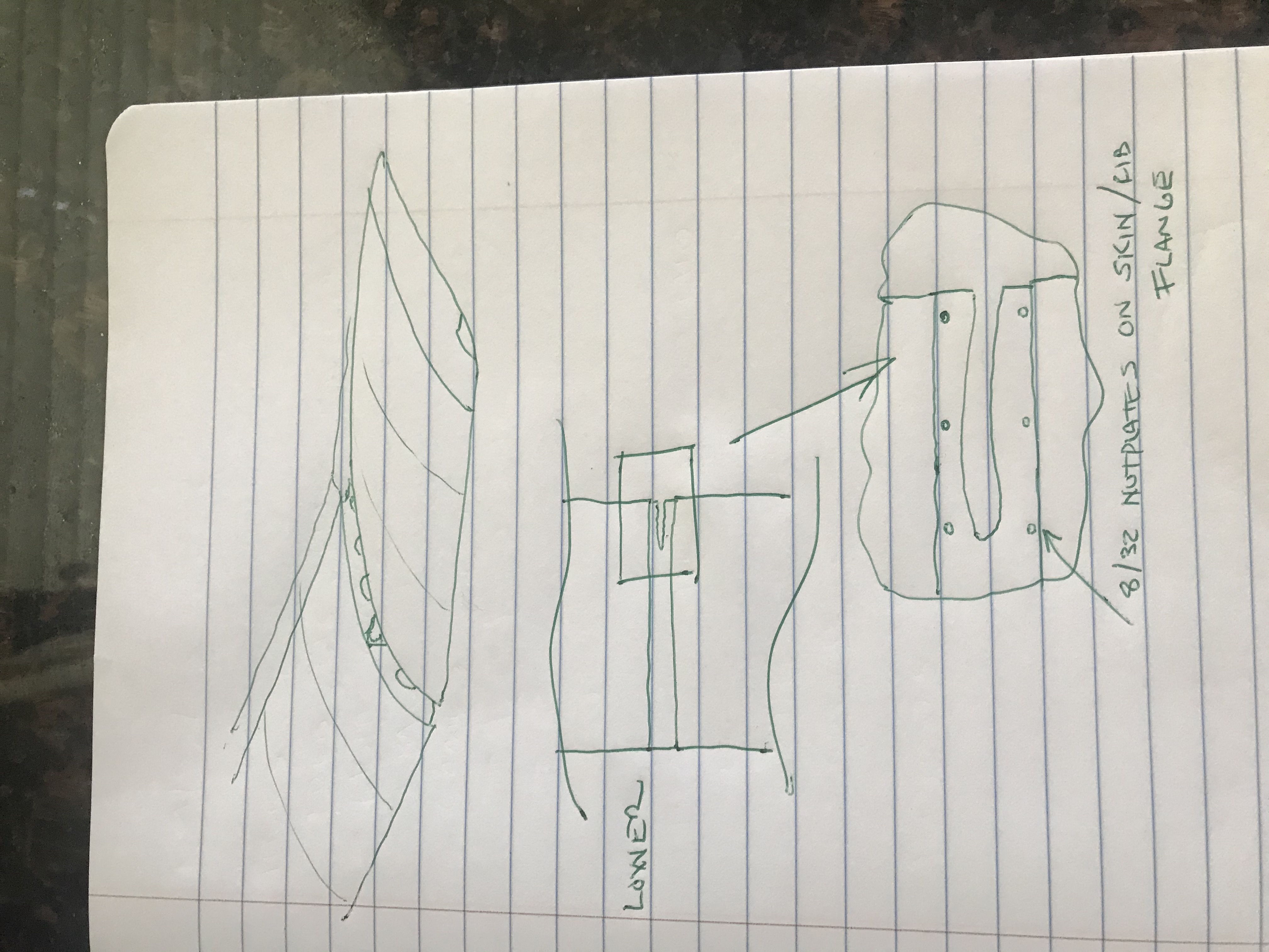

These sketches are admittedly crude but perhaps with a bit of explanation.
Upper attach, the gap cover gets a piece of 3/4 angle riveted on the aft rear such that it falls about 3/4 from the rear spar. This angle should have a 10/32 nut-plate facing aft. At the rear spar a piece of 3/32 - 1/8 aluminum is fabricated such that the rear spar now consists of the each of the outer and inner spar attach and this plate. The rear spar bolt captures the new plate. The plate has a hole drilled for an AN3 bolt to pass just above the center of the rear spar plates.
Lower attach, at the aft end attach the gap cover to the lower skin with <6> 8/32 nutplates they should line up with the area around the aileron control rod.
Assembly, attach the lower side with <6> 8/32 machine screws, at the aft end of the upper side of the cover place an AN3 bolt through the fabricated plate, capture the angle with the nutplate on the cover and tighten until the cover is acceptably tight (this is adjustable so the cap cover will most likely not bottom out on the plate).

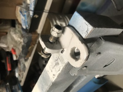

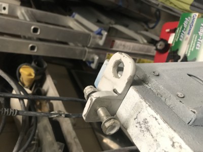

PostPosted: Wed Oct 07, 2020 11:32 am
Here's one way to do it ...

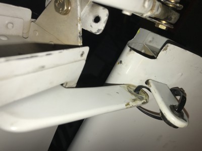

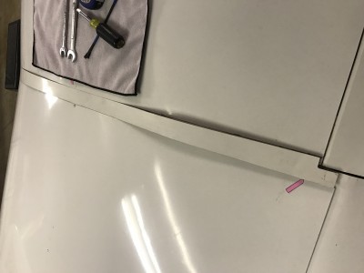

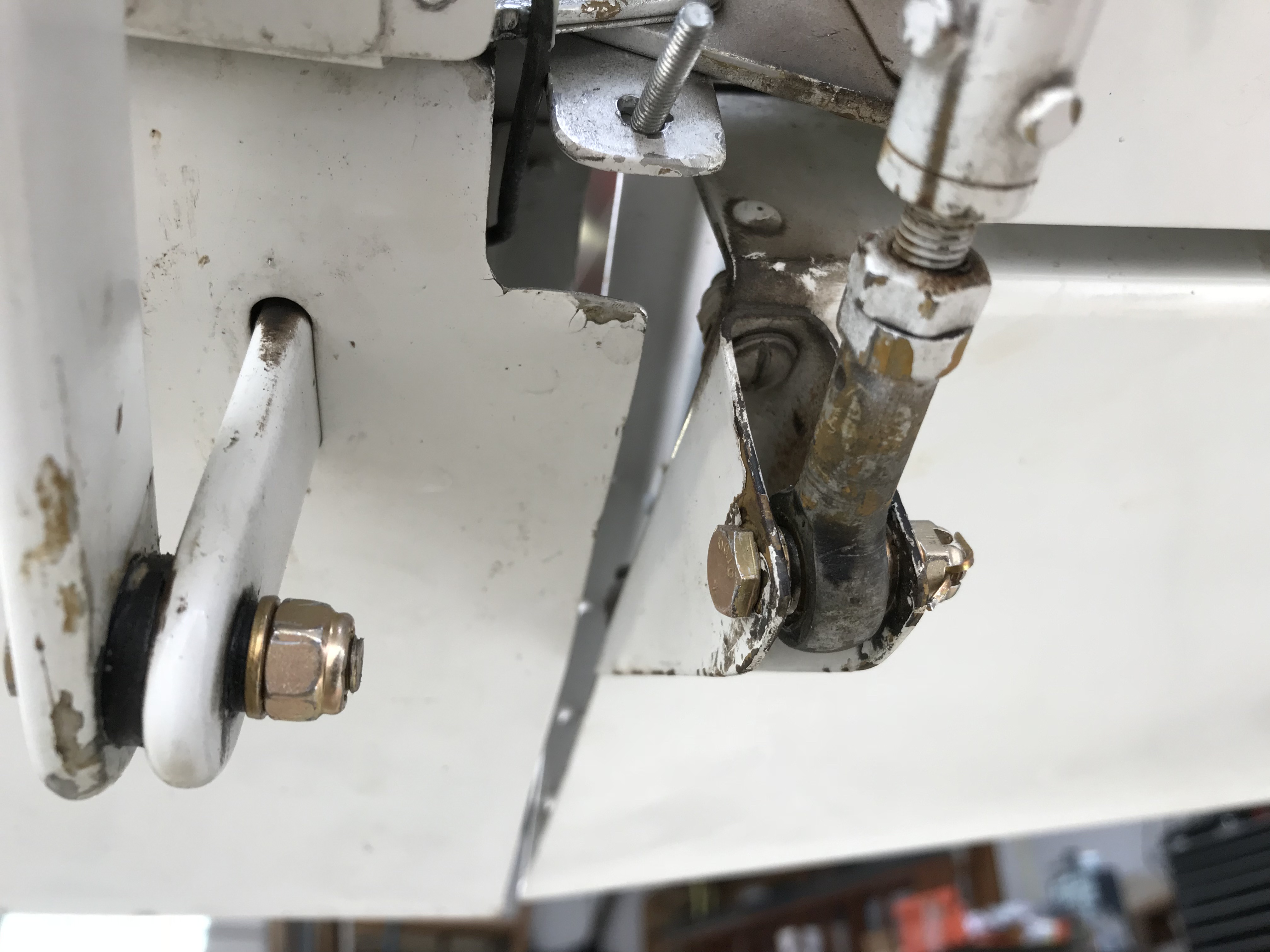

The gentleman who built my plane, N12055, was Robert Kiergard and he used what appears to be a very simple solution. At each end of the wing gap assembly he riveted angle stock with nut plates to accept a screw to tighten the gap seal to the rear spar.
His attachment method uses only two screws to hold the gap seal in place. He put his small plate aft of the rear spars. It has holes that accept one screw at the aft end of the upper side of the gap cover and one screw at the bottom side. Note that there is a rivnut on the upper end of the plate which is drilled out and so that the screw is guided through it to a nutplate or rivnut in angle stock riveted to the upper side of the gap seal. The lower end of the plate is just a hole for the lower screw. Hopefully the pictures will help clarify for you. These are the best I could find in my photos. If you would like better ones, let me know and I'll post them when I get a chance.
File comment: Another view of the end plate's lower side without the rivnut screw guide
File comment: The upper end of this plate has the rivnut screw guide in it. The rivnut is drilled out to let it act as a guide for the screw. You can see the lower screw that is attached to the gap seal's angle rivnut.
File comment: Lower end of the gap attachment plate. In this lower end, the rivnut guide isn't used.
