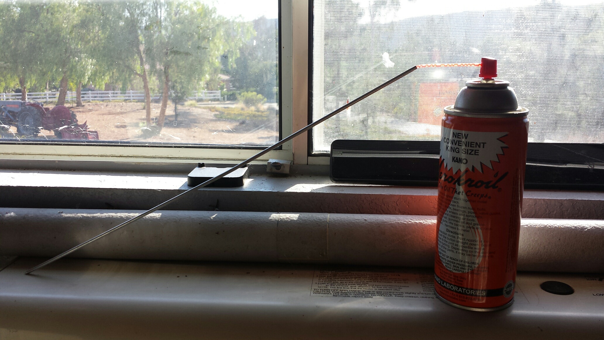

PostPosted: Tue Aug 16, 2016 8:52 pm
Well I'll add my 2 cents worth regarding these little devils . I am helping a good friend with his conditional and I got the wing gap covers off today and can see the problem with the bell crank access . As I have the S-18 I am fortunate to have access covers to the cranks . I came up with a solution for my AC when it comes to lubing hard to reach areas and it is quick , easy and cheap ! It involves using the plastic straw that comes with almost every spray can of lube and a length of K & S metal tubing (you can get this tubing from most hobby and local hardware stores) . Cut the plastic straw in half and insert it into the K & S tubing (it comes in brass, aluminum and I think steel) . I went with the aluminum tube . You can either silicone around the insert area or slightly crimp the tube and straw . This set up will give you extended range and control over the lube . You can also slightly bend the aluminum tube if necessary . The lube will not spray out , it has a steady drip/flow . With the hidden portion of the bell crank I think I can use an inspection mirror and light to direct the metal tube to where I want the lube to go . Probably would work even better with 2 knuckleheads conducting this precision maneuver ? :o
Adding an access cover in this area for the "Standard" T-18 wing would be a good option during the building process . ???
As an added bonus after lubing you can use the tube to fill cannoli , fill party balloons and possibly do those long over due medical procedures ! :P
Shazam

Wicks sells an extremely flexible plastic hose that is designed to fit into the spray nozzle about 3 feet long. It is great for reaching into those hard spots. I saw them in their booth at OSH this year, they are cheap as I recall.
