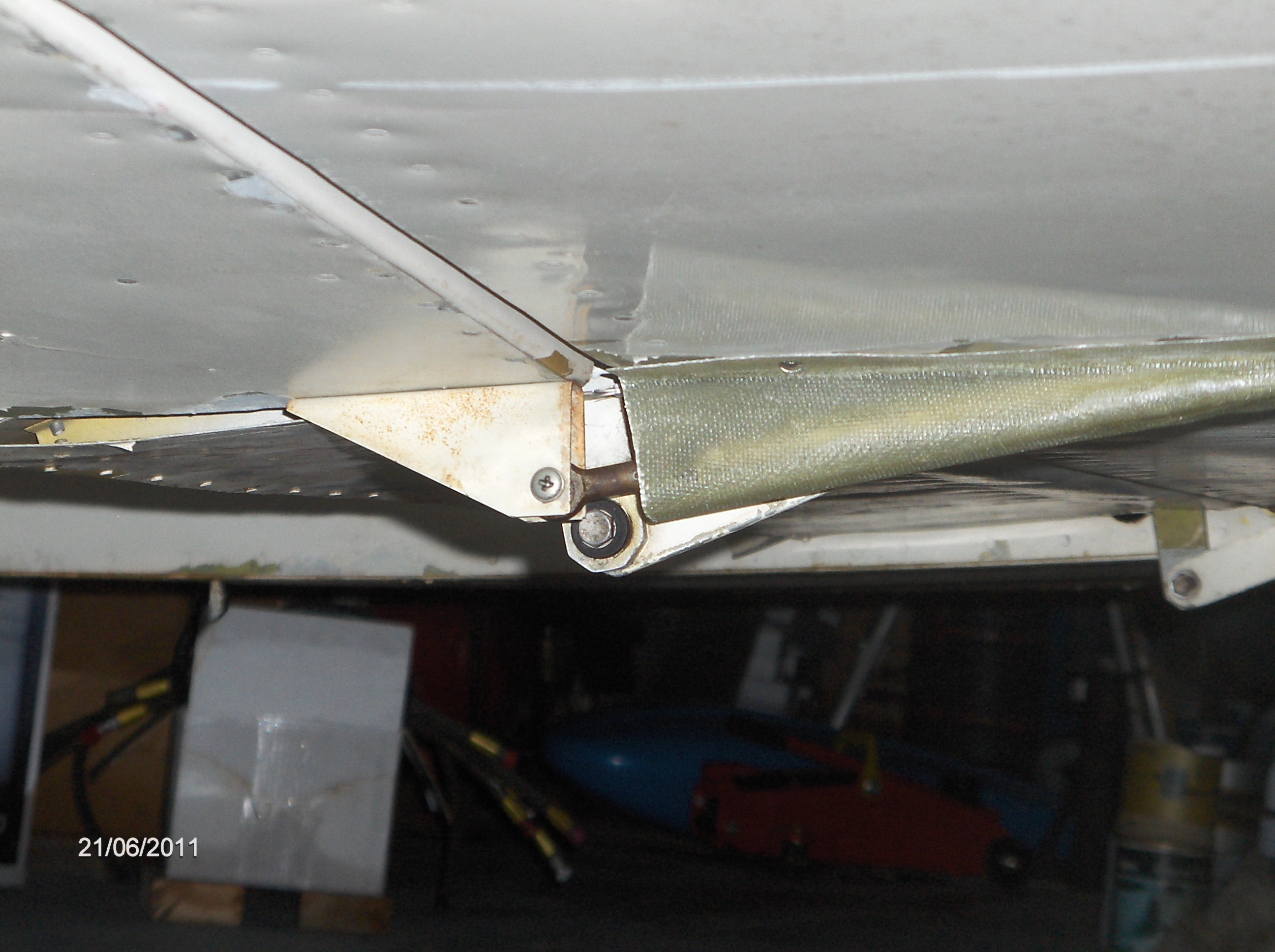

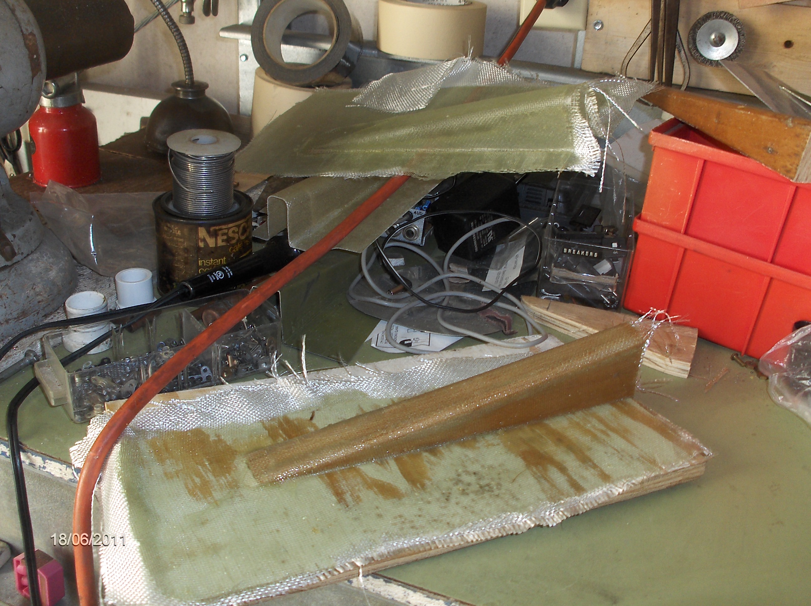

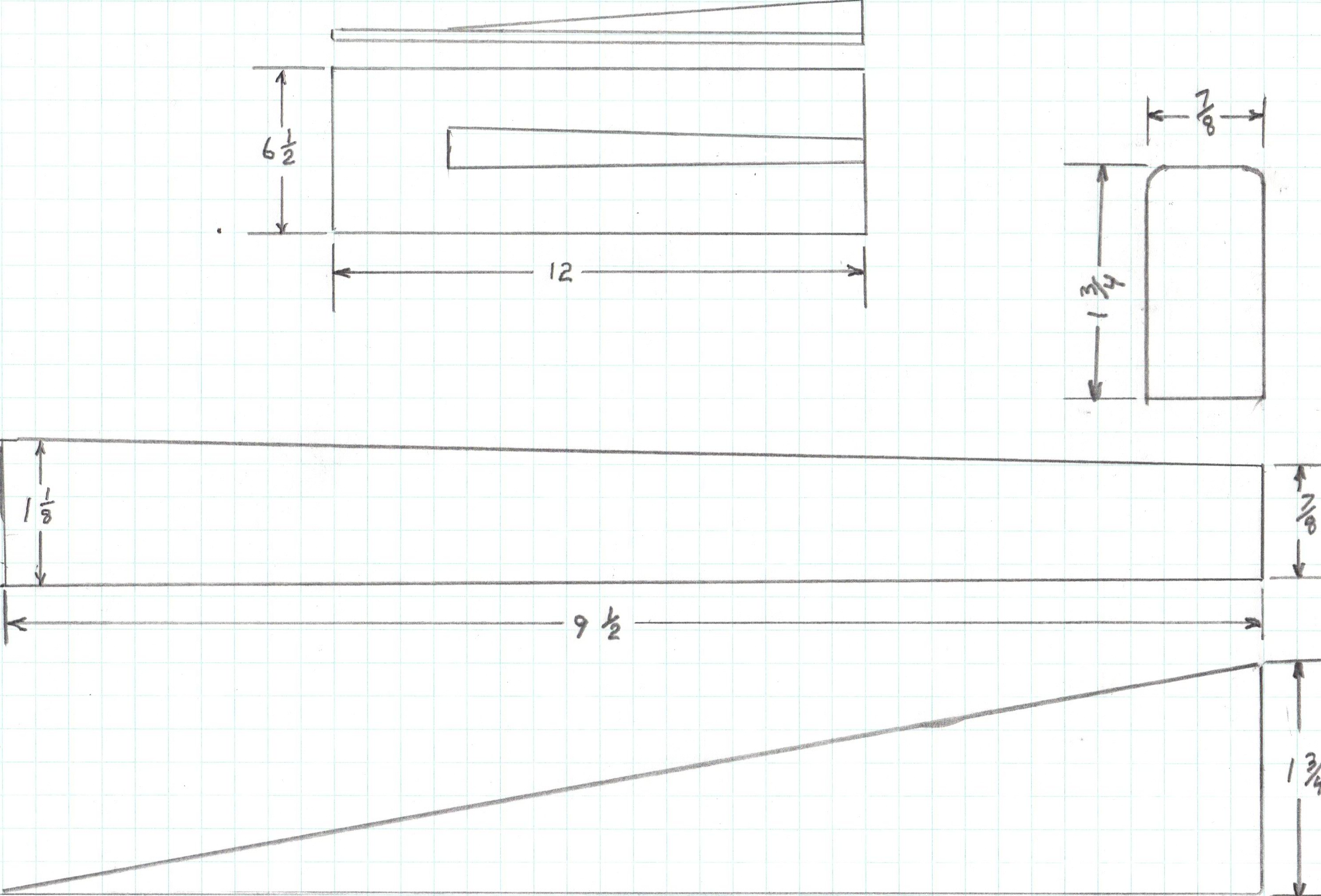

The following was submitted to me by fellow T-18er Hurant Karibian.
A simple wood form mould for making a gap seal under the wing.
The fiberglass flanges need to be thicker than the two thin layers that I used and the inboard flange only needs to be 5/8-3/4 inch wide.
The front flat I slipped under the wing joint cover.
--Hurant
