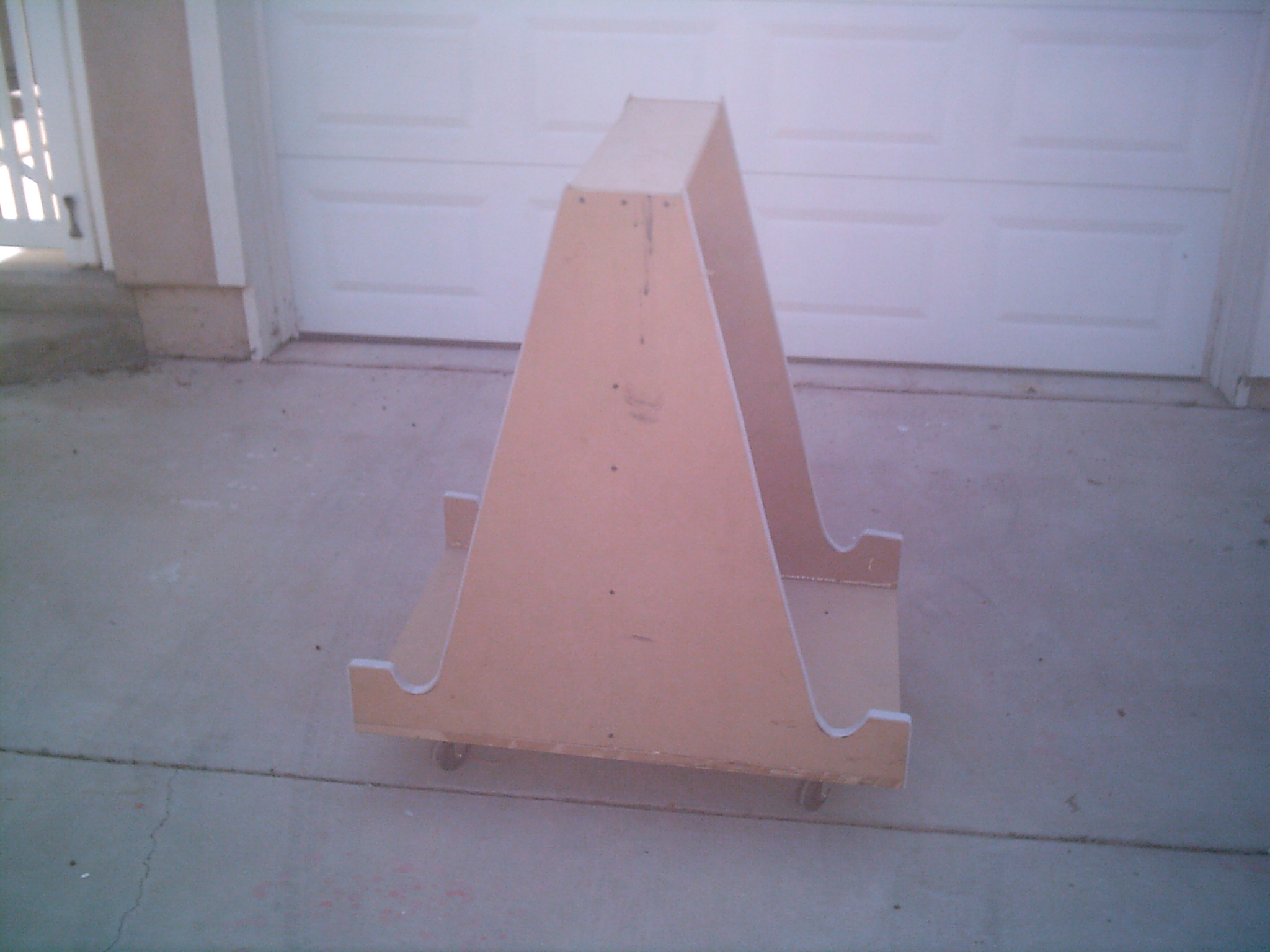

If you have not made one...especially for your S-18, don't wait as long as I did to make mine. Do it now. It only took about 2 hours (maybe less) and the cost was about $25.00. If you have limited space, this little baby will keep your wing tucked away in a safe place. It WILL make your life a lot easier ! [;)]
1. Furniture dolly from HF tools..on sale about $15.00 ?
2. 1/2 sheet of MDF 3/4". I had a piece collecting dust.
3. Roll of PSA 3/4" wide window weather stripping...peel and stick. About $5.00 ?
4. 1 3/4" dry wall screws.
5. Gorilla cement.

 Post subject: Wing Cradle
PostPosted: Wed Sep 15, 2010 8:13 am
Whether you know it or not, you just directed that at me - probably outa make sure the vert wood lines up with the ribs?
PostPosted: Wed Sep 15, 2010 8:22 am
I hadn't thought about the ribs ? I don't think it is necessary, most of the weight is on the leading edge. Mine are built super strong ! A builder should have this thang as soon as the wings are started !

Rich,
Gearing up for a paint job on my bird and I like your wing sling. what are the rough dimensions? I can figure out the top via the pic, what's the base? or should I just "wing it"!
Thanks
Chuck
Chuck Kincer
Richmond, Me
575CK
KIWI
PostPosted: Mon Oct 25, 2010 8:04 pm
I suppose I could let you wing it [}:)] , but here are the ruff numbers.
Base-2'x 3'
Height-3'
Top: About 8" wide.
The slope has to be such that the wings do not touch at the trailing edges when both are stored.
The base was made to no real size other than to cover the large HF furniture moving dolly. I did made one change to the base. The "curved" portion (I used a rib template from the drawings) where the leading edge sits was too tight. I just cut the edge of the opening a bit so the wing leading edge has a little more room to sit in. [;)]
I wish I had made this craddle when I first started building my wings, rather than moving them from one place to another one wing at a time. Best 2 hours I have spent in a long time. BADA BING, BADA BOOM ! [:D]

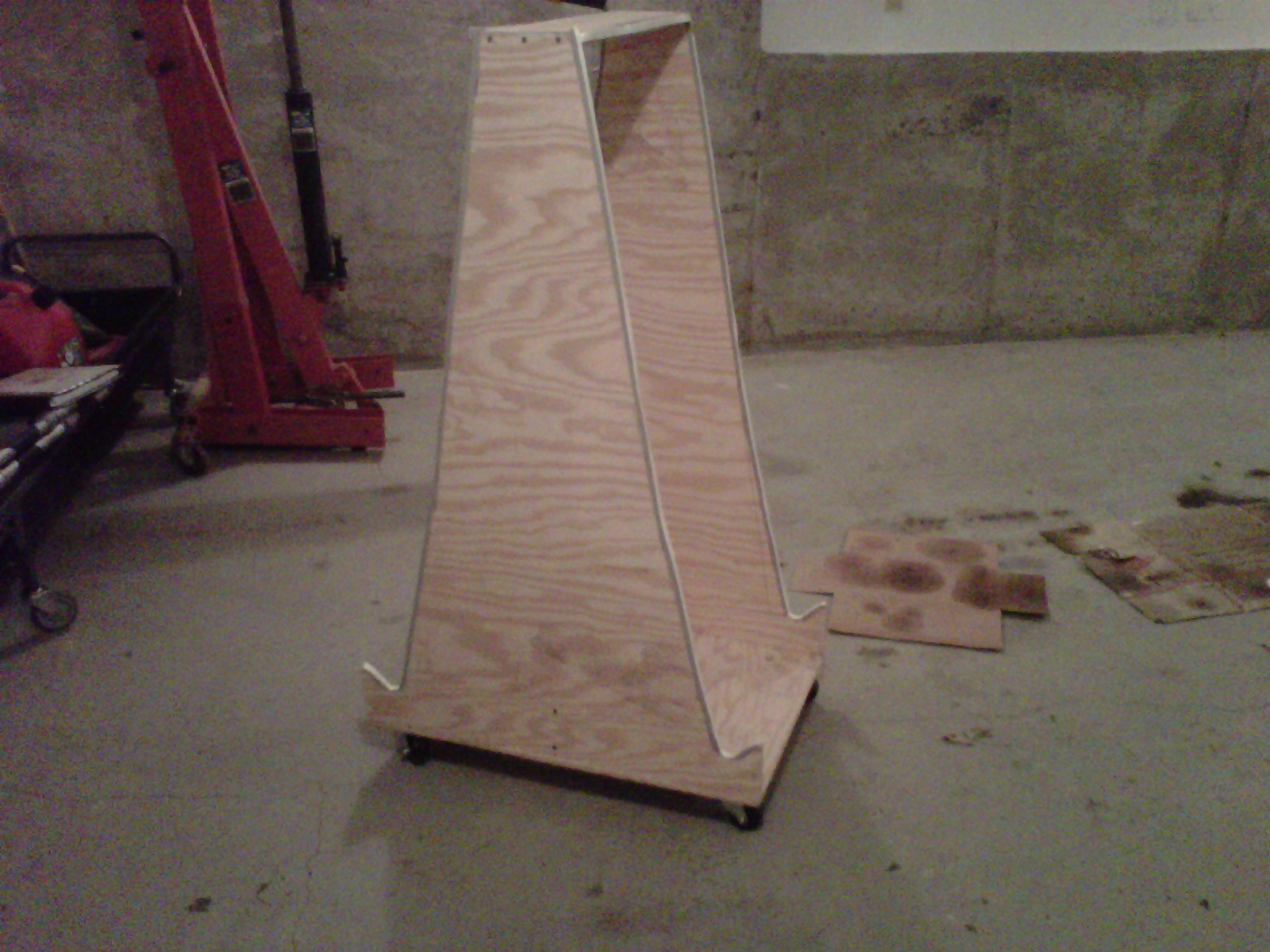

One Rich Brazell copy (sort of) of the wing sling fresh off the assembly line (patent pending!). it cost about $30 for casters, hardware and weather stripping (already had the wood).

PostPosted: Mon Nov 01, 2010 12:45 pm
"You look marvelous ! Now all you need is some Rich Corinthian Leather for the sides." [:D]
BTW...do you have a dog in the garage ?

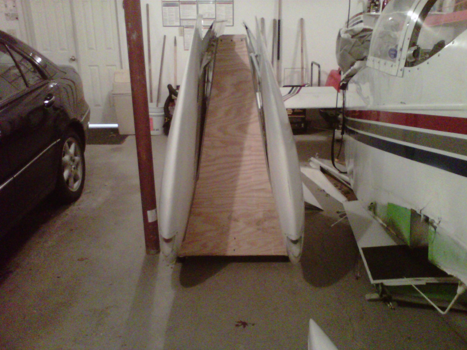

Wing sling in action!
