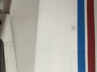

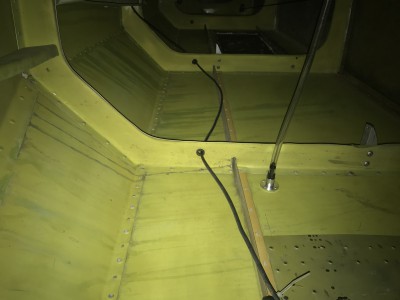

Here are shots of the new static ports:
 Post subject: Re: Retrofit Pitot Tube
PostPosted: Wed Aug 01, 2018 9:39 am
Jeff,
Nice work. I'm sure you know this, but make sure the static line rises inside the fuselage so you don't get water stuck in it.
PostPosted: Wed Aug 01, 2018 10:23 am
Good eye! The way I have it now, water can collect between the 2 ports but not gravity flow forward so the left side "should" always be clear. However, I have access to some salvaged Cessnas and I thought I might eventually raid them for their static line sumps but I like your idea better. It is easier to do and I don't have to wade through poison ivy and/or briars to do it. Thanks
