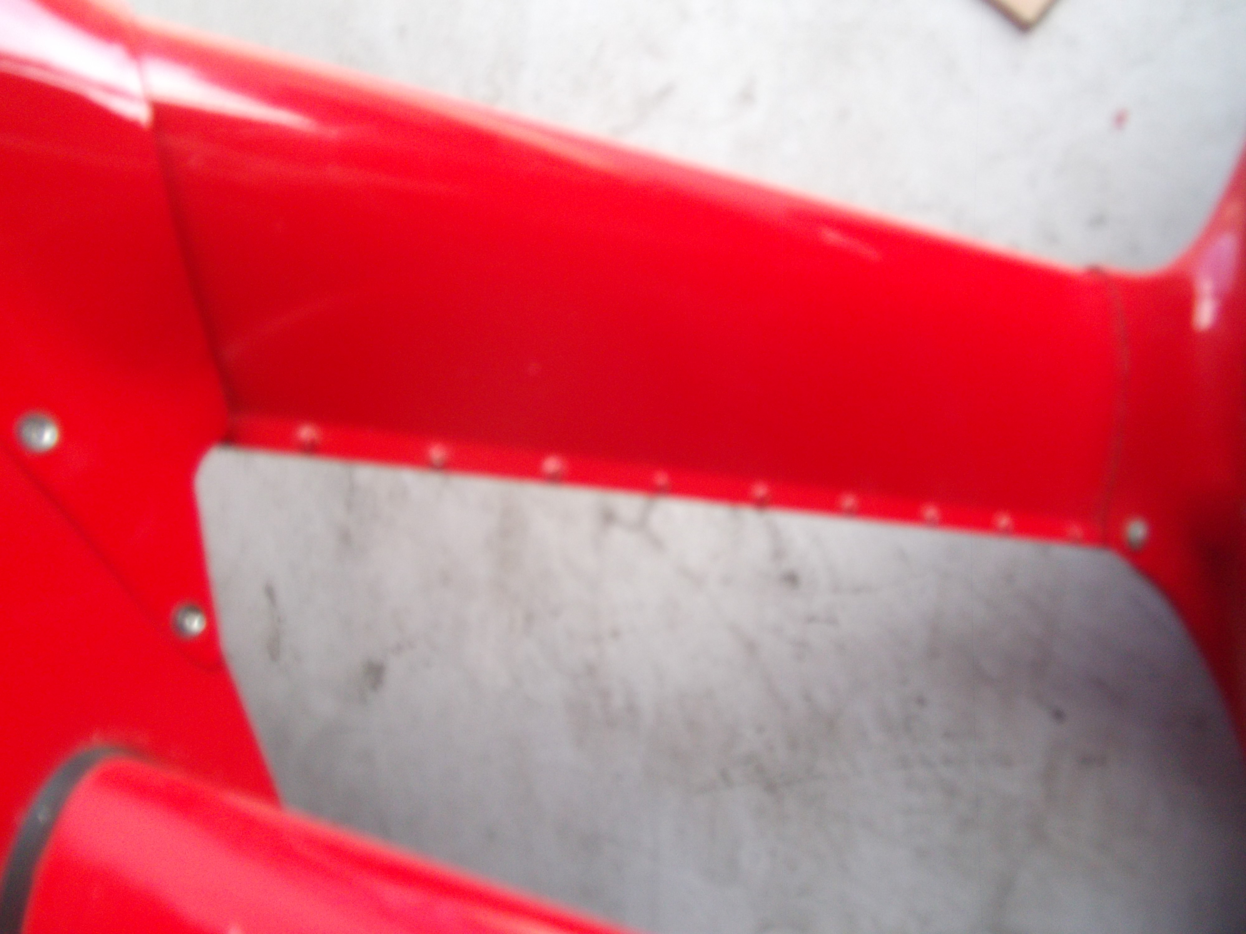

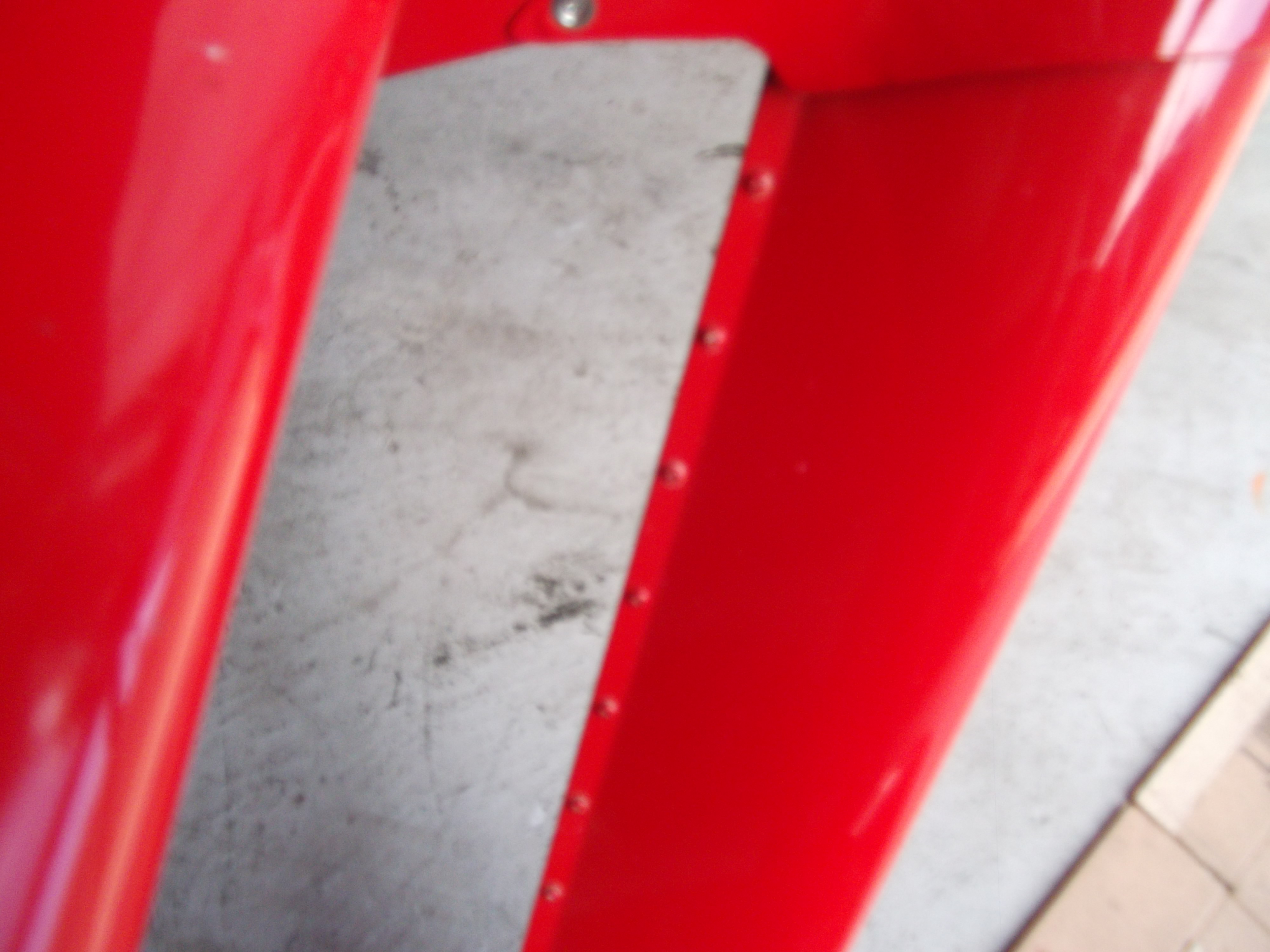

PostPosted: Sun Jan 03, 2021 3:37 pm
My idea for the leg fairing . #40 screws and nutplates . You will never know there are nutplates attached to the back of the fairing (at least you can't see them ) . Feeble idea from a feeble mind ! ::)
PostPosted: Sun Jan 03, 2021 8:01 pm
I did what you see in RBs bird. Except I rivet in a piece of 1/8 by 3/4 aluminum. I simply tap that for the screws. The Tigress has the same thing except the trailing edge is folded so the strip is actually about an inch forward of the trailing edge.
PostPosted: Sun Jan 03, 2021 8:53 pm
I used folded trailing edges to match my flaps and ailerons. The picture is not great but I put the seam on the inside and just stuck the trailing edge of the inside into the folded part. Tension keeps it there, no fasteners. Just a connection at the top fairing to keep it from falling down.
PostPosted: Thu Jan 07, 2021 3:50 pm
David Read's idea and execution are brilliant!...I'd pay serious money for a template of that piece!! Kudos David!!
