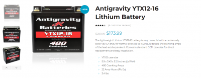

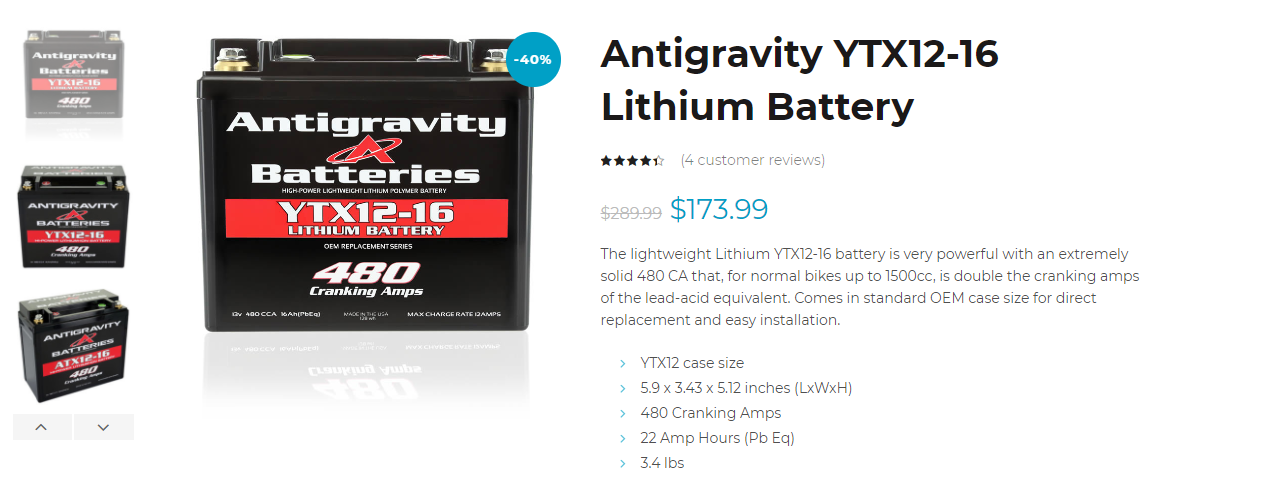

Bought a Full Throttle FT230 that Rich recommended for my T-18. Works fine, but I'm really interested in LiFePO4 batteries for their performance and light weight. For an experiment I bought a Antigravity YTX12-16 with 480 cranking amps and 3.4 lbs. a 1 volt higher resting voltage. Wow!!! This thing cranks over my O-320 way faster than the FT230. Did 4- 5 second cranks cold and still had a lot of battery left. The amp hours is lower than the FT230 of course, but its rated at 192 Watt hours so you should be able to pull 15 amps for an hour if needed. Putting N2WB on a diet losing 12.6 lbs. for under $200 bucks seems like a no brainer to me. Also this battery technology only loses 1% of charge per month without a parasitic draw verses up to 1% day with AGM technology. So no more battery tender i hope! Bought a LiFePO4 maintainer just in case. Yes! they are a different charger due to the voltage is a volt higher. Anyway- just thought I would share, and of course any input would be appreciated. I got a new FT230 battery for sale if interested $60.00 shipped to lower 48 ;D
