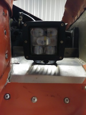

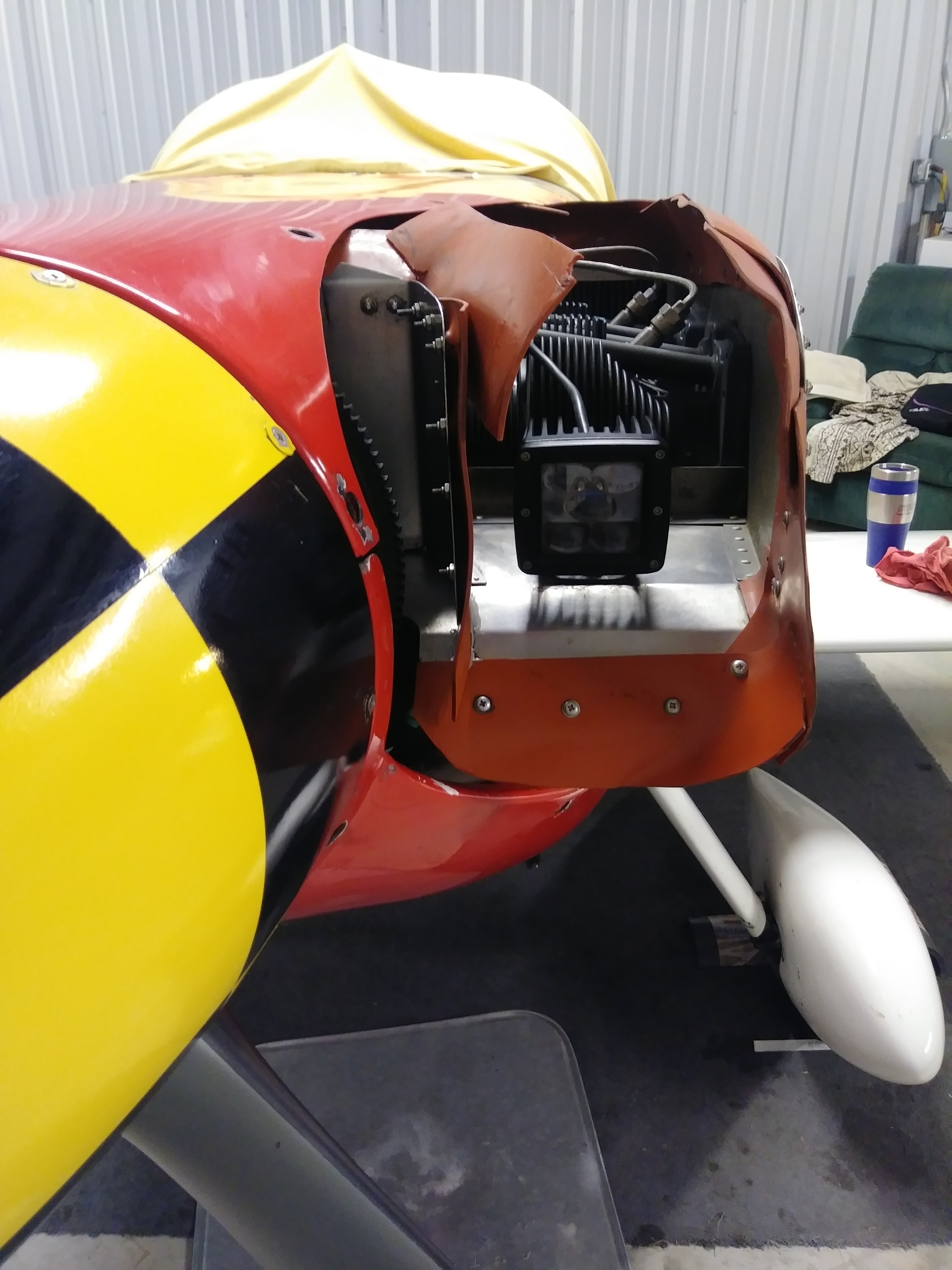

PostPosted: Sat May 18, 2019 6:37 pm
Here are a couple of pics of my installation.....and Naught from Naught = Naught means Rich is now a "Triple Naught" spy!!
