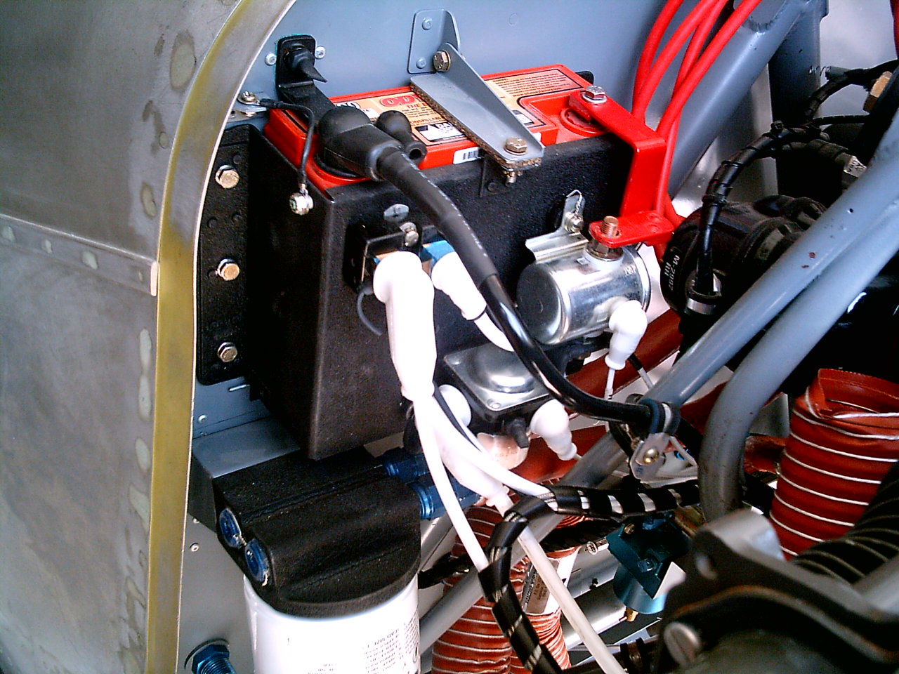

9 pounds ! OH MY ! Yep..start out with a fresh W & B . Then I would take a closer look behind the seats/baggage compartment all the way to the tail to see if an undecided voter has set up camp back there ! I have heard of some guys finding old radio gear back there (remote compass/ADF gear etc.) that would not tip the scales in your favor ! ??? As Mr. D sez you can put the PC-680 on the firewall and it works quite well . ;) Shorter battery leads are a plus , in addition to moving the battery weight forward . :P

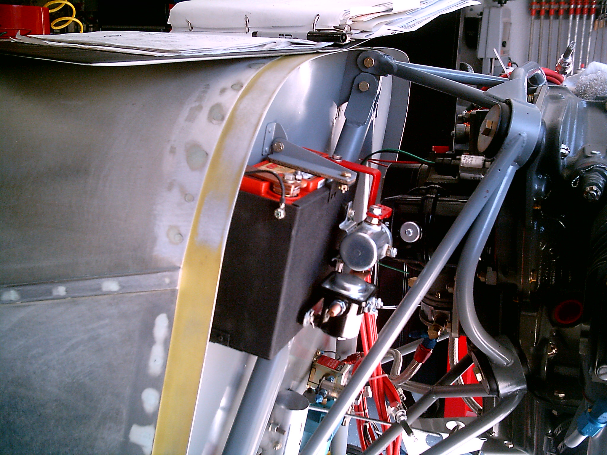

I like the battery position in the picture above but I have an oil filter occupying that space already. I found an extra ELT behind the seat so there is ~4 pounds that can disappear. Looking at the aircraft file, this bird appears to have always been heavier in back. The very first tail weight was 57 pounds. Current sheet shows 67 pounds. I will have to figure out the arm for the ELT and see what that does to the balance. It won't be a big change. I am thinking barely noticeable on paper.
BADA BING , BADA BOOM ! Oil filter below PC680 . :P
