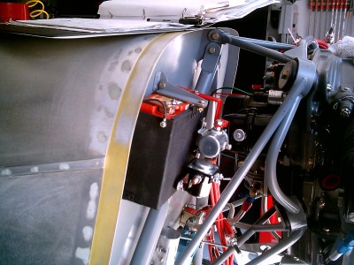

Let me be the first to respond to your queries and I'm sure there will be others I hope, along the way. Before I start moving items from one end to the other, I would perform the weight and balance on the airplane to see where it stands as far as the CG is concerned. The thing to remember is that the CG on the Thorp is between F.S. 61 and F.S. 71.
Never heard of dead weight on the engine and if there has been some, someone need to chime in. The ring you refer to is a weight ring secured to the back of the starter ring weighing twelve pounds. I have one and use it when I use the wood prop which I'm about to take off for refinish and install the Sensinich. The prop erosion which occurs with wood or composite props generally occurs when flying fast. In other words, when the airplane is moving fast across the skies and not so much as the propeller rpm. As a precaution, I do back off on throttle if I happen to come across rain; however, if you have a hard finish on the prop, erosion is minimized.
I too had the Odyssey 680 mounted under the passenger seat and while it was easy to get at for whatever needed, I decided to move it to the right side firewall and have a jumper cable accessible for jumper cable if ever needed. By moving the battery to the firewall, I shorten the cable by some six feet. Starter was not getting the required voltage to turn engine fast enough due to poor grounding connection. The cable to starter solenoid is now 12 inches or so long.
Again, do the math before cutting and I'm sure you should be able to find enough space on the firewall for the battery box. You may have to move some components and that shouldn't be too difficult.
S-18 engine mounting, flaps, aileron,aileron trim 027.jpg [ 614.64 KiB | Viewed 44809 times ]
9 pounds ! OH MY ! Yep..start out with a fresh W & B . Then I would take a closer look behind the seats/baggage compartment all the way to the tail to see if an undecided voter has set up camp back there ! I have heard of some guys finding old radio gear back there (remote compass/ADF gear etc.) that would not tip the scales in your favor ! ??? As Mr. D sez you can put the PC-680 on the firewall and it works quite well . ;) Shorter battery leads are a plus , in addition to moving the battery weight forward . :P

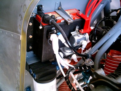

I like the battery position in the picture above but I have an oil filter occupying that space already. I found an extra ELT behind the seat so there is ~4 pounds that can disappear. Looking at the aircraft file, this bird appears to have always been heavier in back. The very first tail weight was 57 pounds. Current sheet shows 67 pounds. I will have to figure out the arm for the ELT and see what that does to the balance. It won't be a big change. I am thinking barely noticeable on paper.
BADA BING , BADA BOOM ! Oil filter below PC680 . :P
