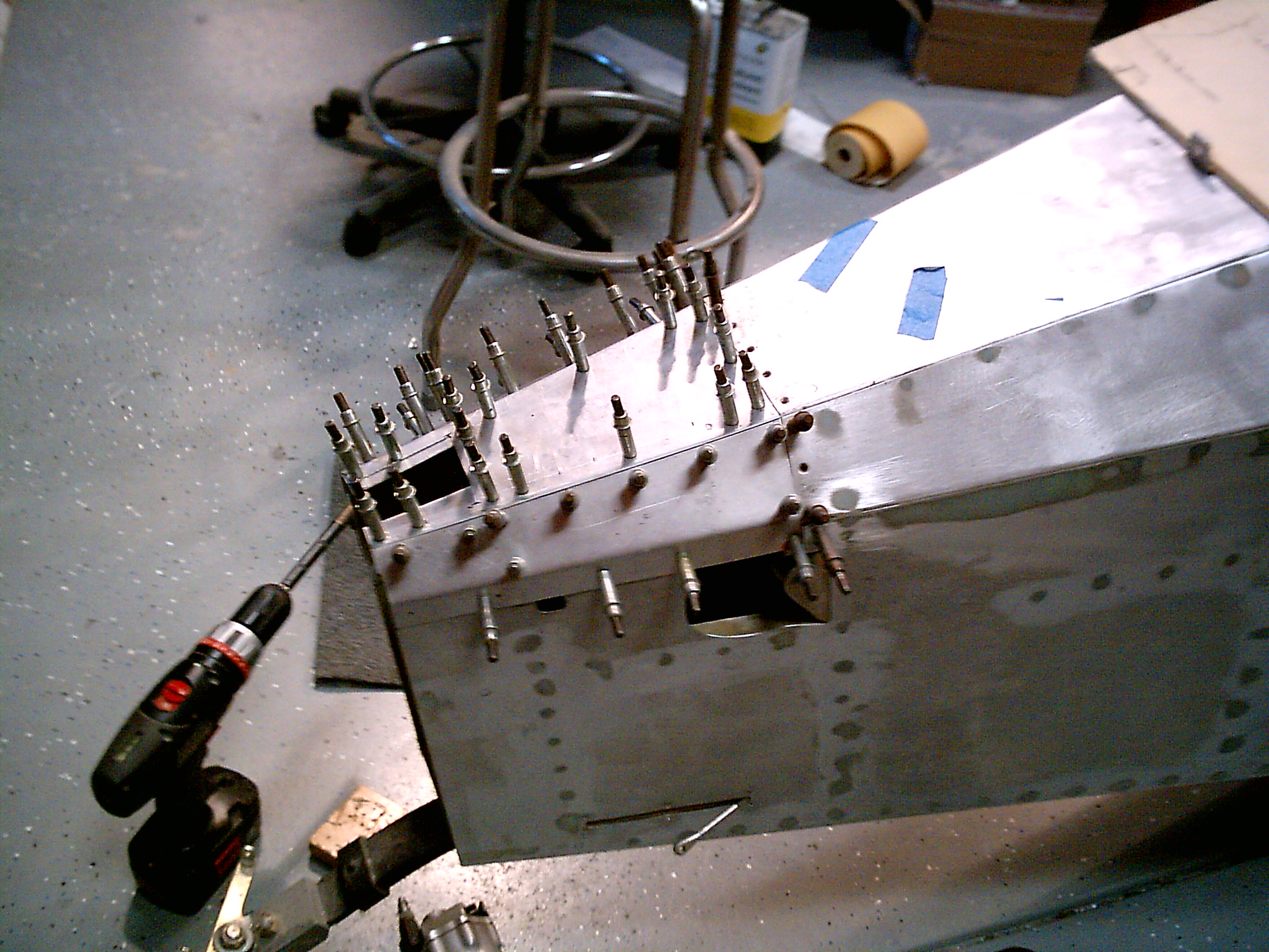

Some folks have put in an inspection cover below the HS on the fus. to address that issue or some folks (me) during the build process split the cover that goes over the trim torque tube/HS pivot points . Once my covers are off I can inspect down in the "hole" and lube all necessary pivot points using my lube extension , w/o having to remove the fin , etc. I have been using Kroil spray for all my bearings/pivot points , flaps , hinges , etc. I don't remove anything unless it needs to be replaced (out of limits) . :P The spray is also great as a bug repellant ! ??? Not !
