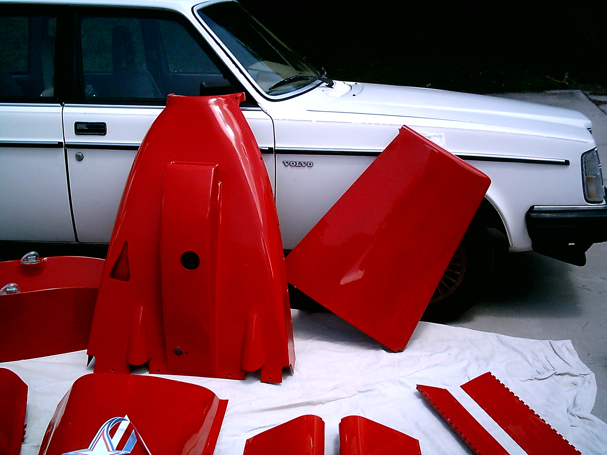

Still trying to picture this ? Is there an inlet attached to the lower cowl that allows air to enter or is the scat tube just sitting there at the front of the lower cowl trying to catch any "cool" air that happens to pass by ? ??? I have a NACA vent on the lower right rear of by S-18 cowl with scat tubing to the firewall (copied from a very early NL) . The attached pic shows the NAVA vent . :o

Rich, yes, that is how mine is set up. Thank you for the pic. I will try sceet tube John. Good idea about the size too.
