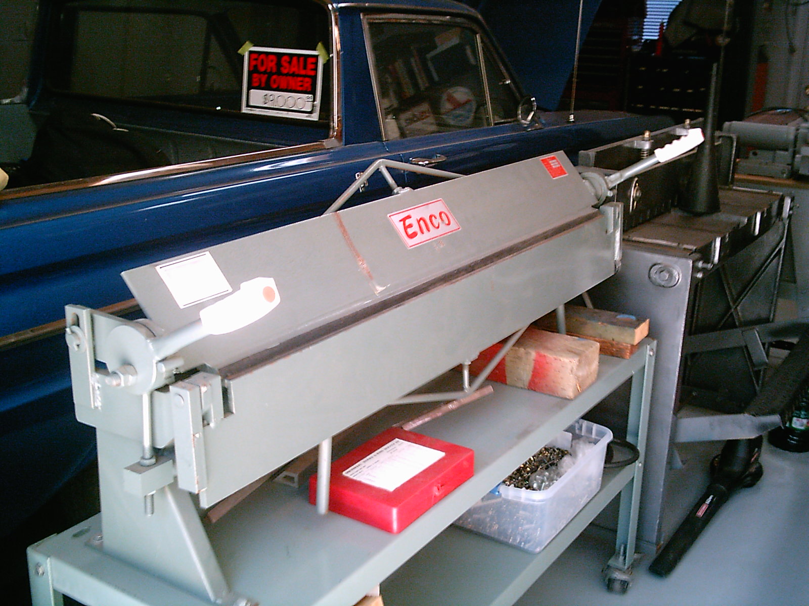

Lou makes some good points . With regard to e-bay the freight can cost as much as the used brake and you may need some way to get it off the truck if it doesn't have a lift gate . I am about 50-50 with regard to freight companies not destroying what I have delivered . I got a decent 48" brake from ENCO new for just over $200 and they were offering free freight at the time . :o
