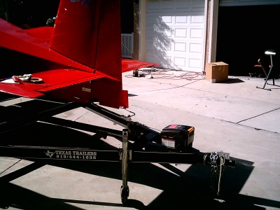

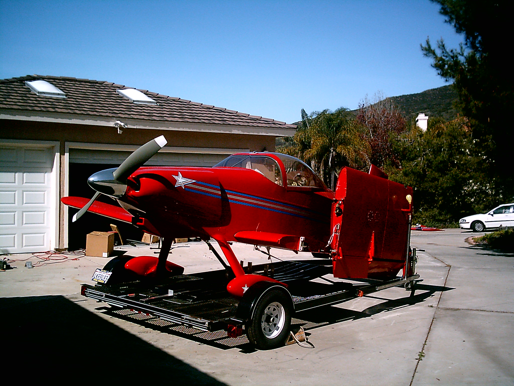

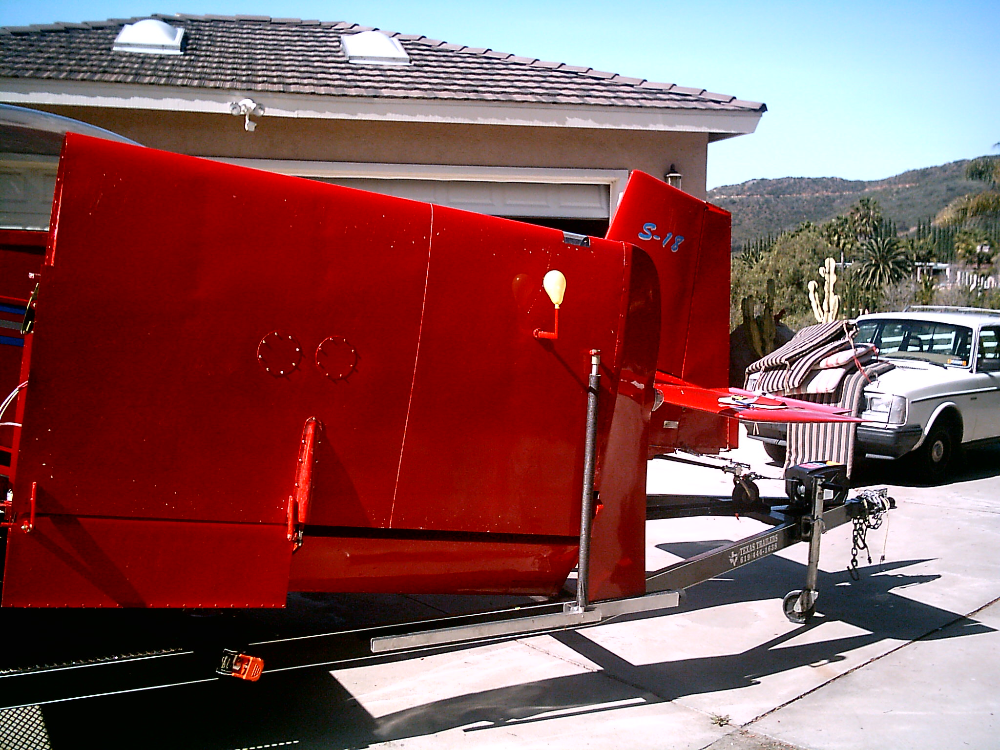

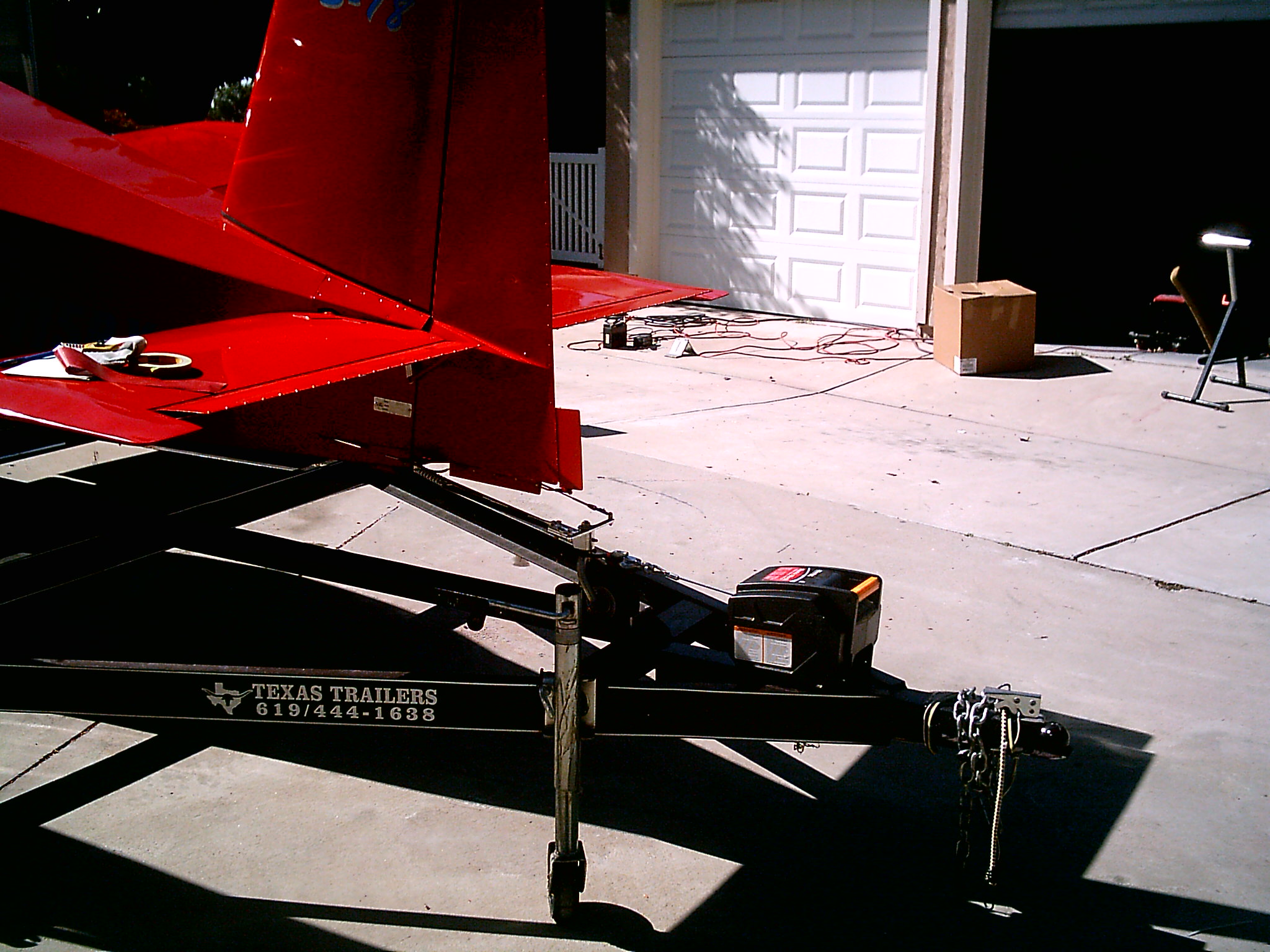

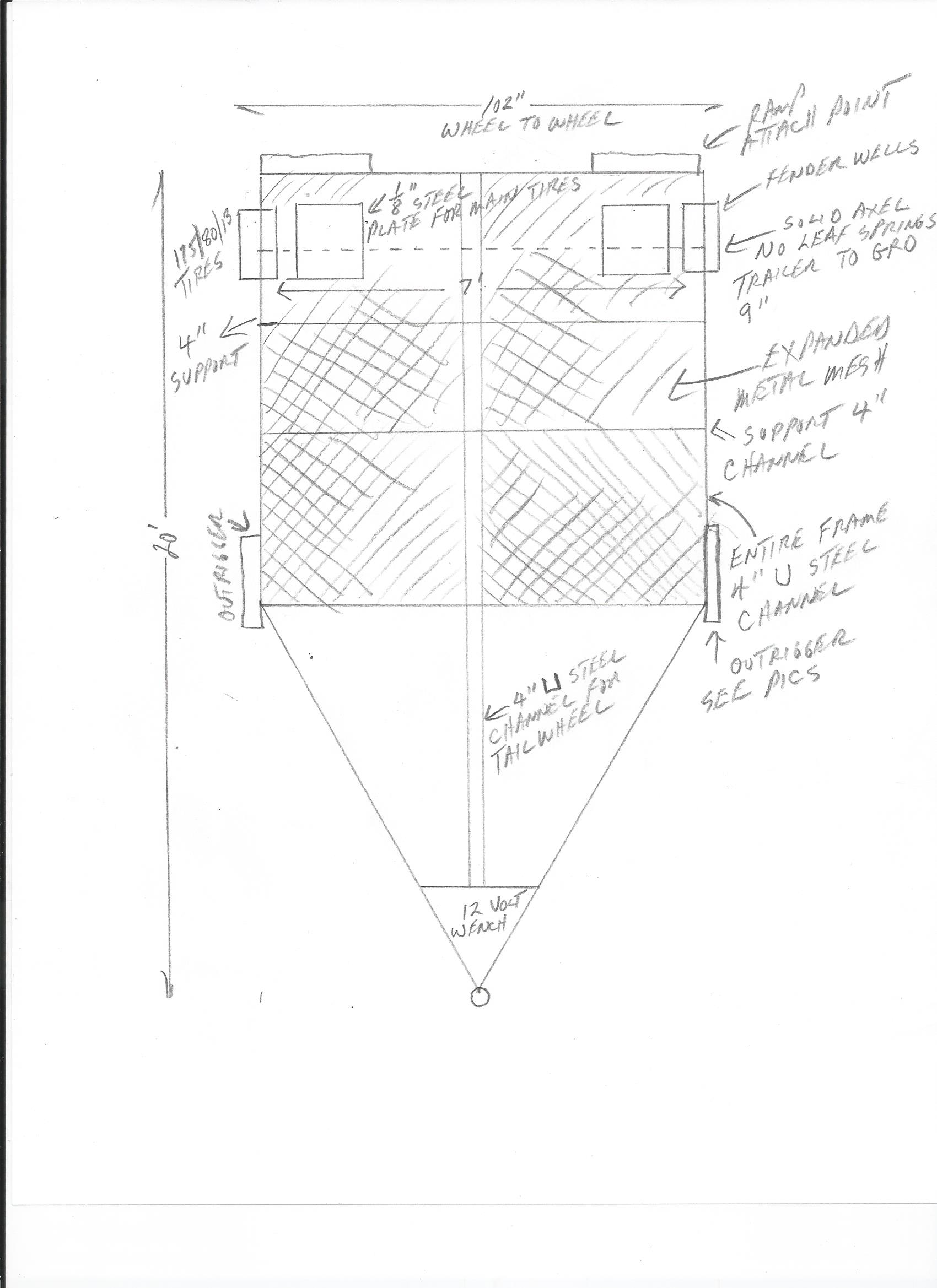

Terry: Here a ruff drawing of my trailer supplemented with pics . All measurements are approx. Like I said the basic trailer is nothing more than a modified flat bed . Any questions let me know or we can discuss it at SEZ .
PostPosted: Sat Mar 28, 2015 1:53 pm
Thanks, the napkin will help. I'll go visit the trailer maker next week
T
PostPosted: Sun Mar 29, 2015 7:16 pm
Terry : One added note . The expanded metal mesh is probably not necessary . I only added it to make an area so I could used the trailer to haul items with AC off the trailer . ;)
