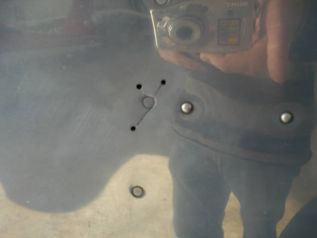

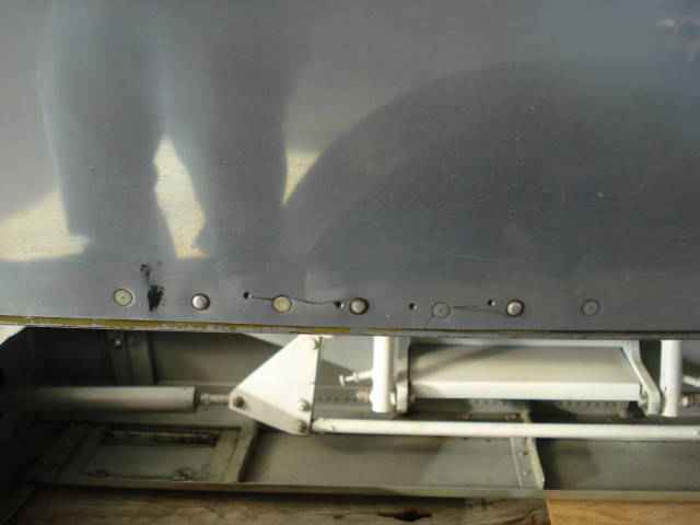

I saw this recently and thought it was worth passing along.
This is a shot of the fuselage skin on a Thorp. A good reminder for the builders and or re-builders out there to deburr those holes (everywhere!) and make sure those skins are tight. One would not think the fuselage skin works enough to develop cracks like this but it does (look at an in-flight pic of a T-18 and notice the side skins). This particular airplane had diagonal stringers added in between the fuselage bulkheads to mend oil-canning. I can only assume that it was bad enough initially to cause this.
Note: the braizer head rivets were added in response to the cracks.
Note: Here the braizer head rivets here tie into the stringers that were added to mend oil-canning.

I would assume at a certain point it would become a structural matter with this much cracking ? Not an engineer, just asking.

Indeed RB,
On this particular airplane these the cracking was isolated to the two spots pictured above.
A few things going for the airplane ..
1.) The overall workmanship is quite good, much above par.
2.) It has a new owner is going down for a serious going over right now where I'm sure these areas will be addressed.

On my initial first glance it appears to me that the added stringer in the bottom pic does not tie in to the bulkhead, just butts up, thus the skin carries the load between then. A little piece of angle can fix that. It does look like it has oil canned in several places. Do you suppose that just the oil canning is what cracked the bottom edge in the other pic? I agree that it has the potential to be a really nice plane though I have to question your assesment of the mentor. Thanks for your help so far.

Yeah that's what I thought too, not sure why he went to the trouble of installing those stringers and not going to the trouble of drilling out a couple of bulkhead rivets and tying it together. While we're at it, why didn't he dimple the stringers? In my opinion the stringers give it a little character, they're straight and in a way look like they could have been per-plans (see pic .. look at the "second WL-42") ... I like the airplane although I'm getting a bit envious of you guys up there. Olney, IL is quickly becoming T-18 central!!
