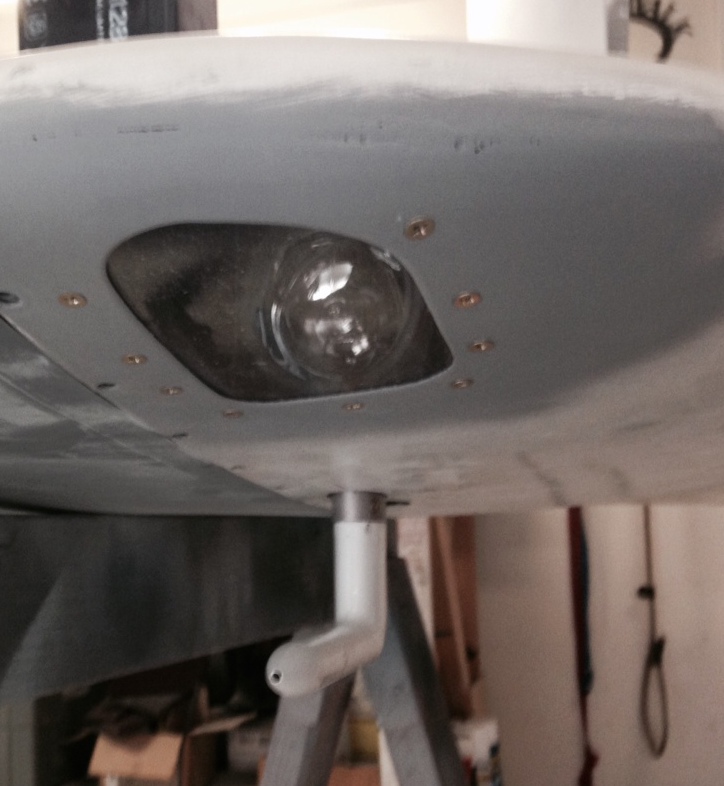

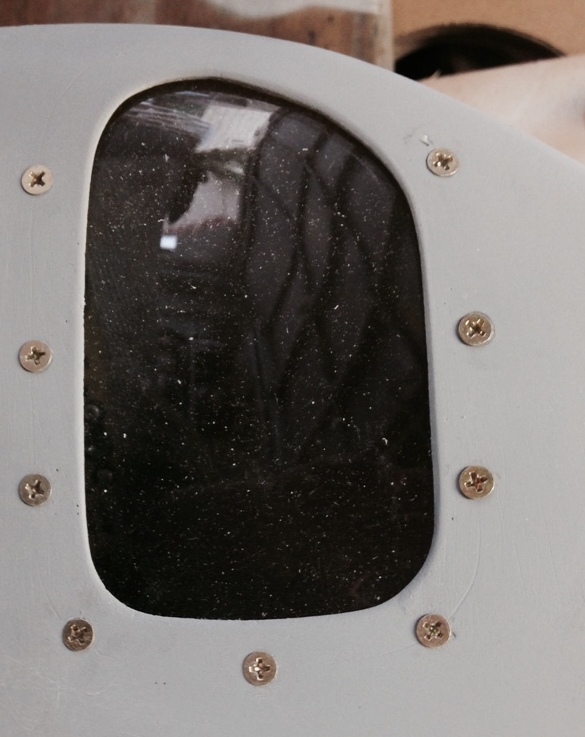

I've modified the tips for 66WT to accept LED nav/strobe and LED Landing Lights. The ones from Ztron Labs have a built in Wig Wag feature.
I don't figure on landing much at night, but figure it's worth having lights for recognition.

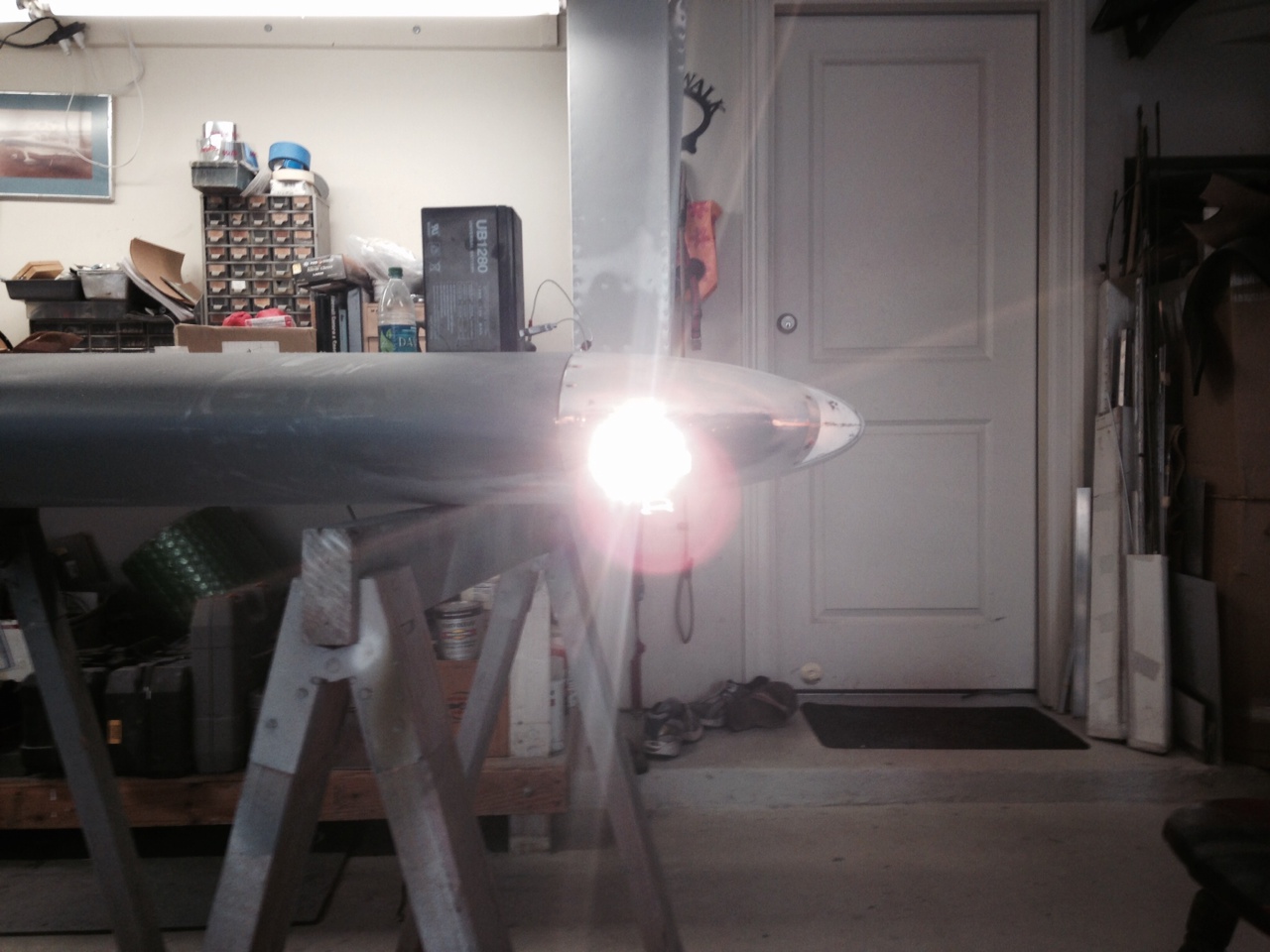

PostPosted: Tue Mar 11, 2014 10:43 am
That's funny Terry ... I did the same last weekend.

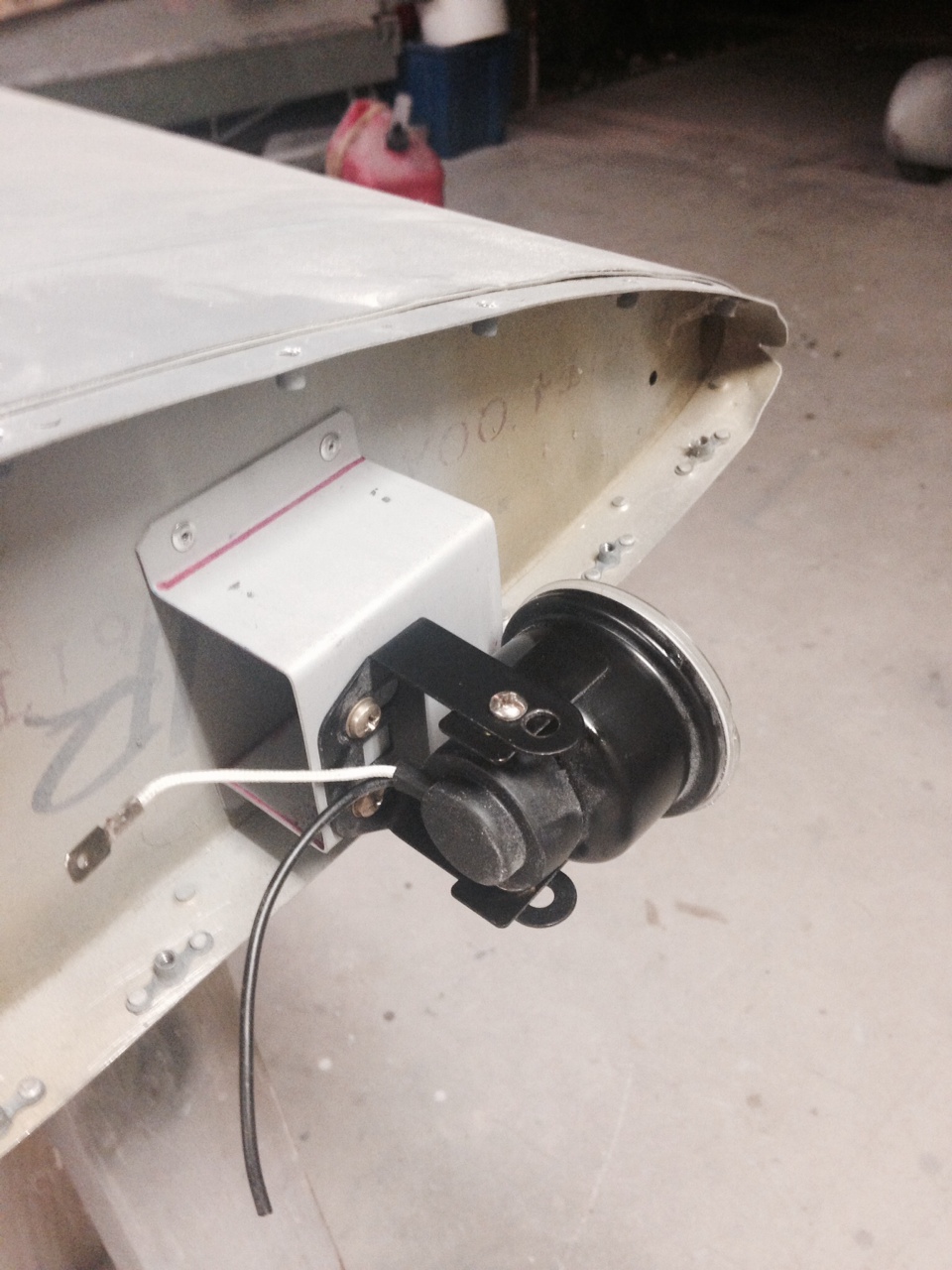

PostPosted: Tue Mar 11, 2014 2:16 pm
I'll get some for you Dick, but really not much to it ... a 1.5" standoff with nut-plates, the lights had 90 deg mounts between the lights mount and the standoff it put the center of the light about 3" outside the end rib.

PostPosted: Wed Mar 12, 2014 9:42 am
Here you go Dick
Thanks Ryan

PostPosted: Fri Mar 14, 2014 11:42 am
Lee, I like your mounting idea much better than what I was trying to do with glass in the tip. The light will be more secure and easier to aim if I change mounting to the end rib. Thanks for the photo.
