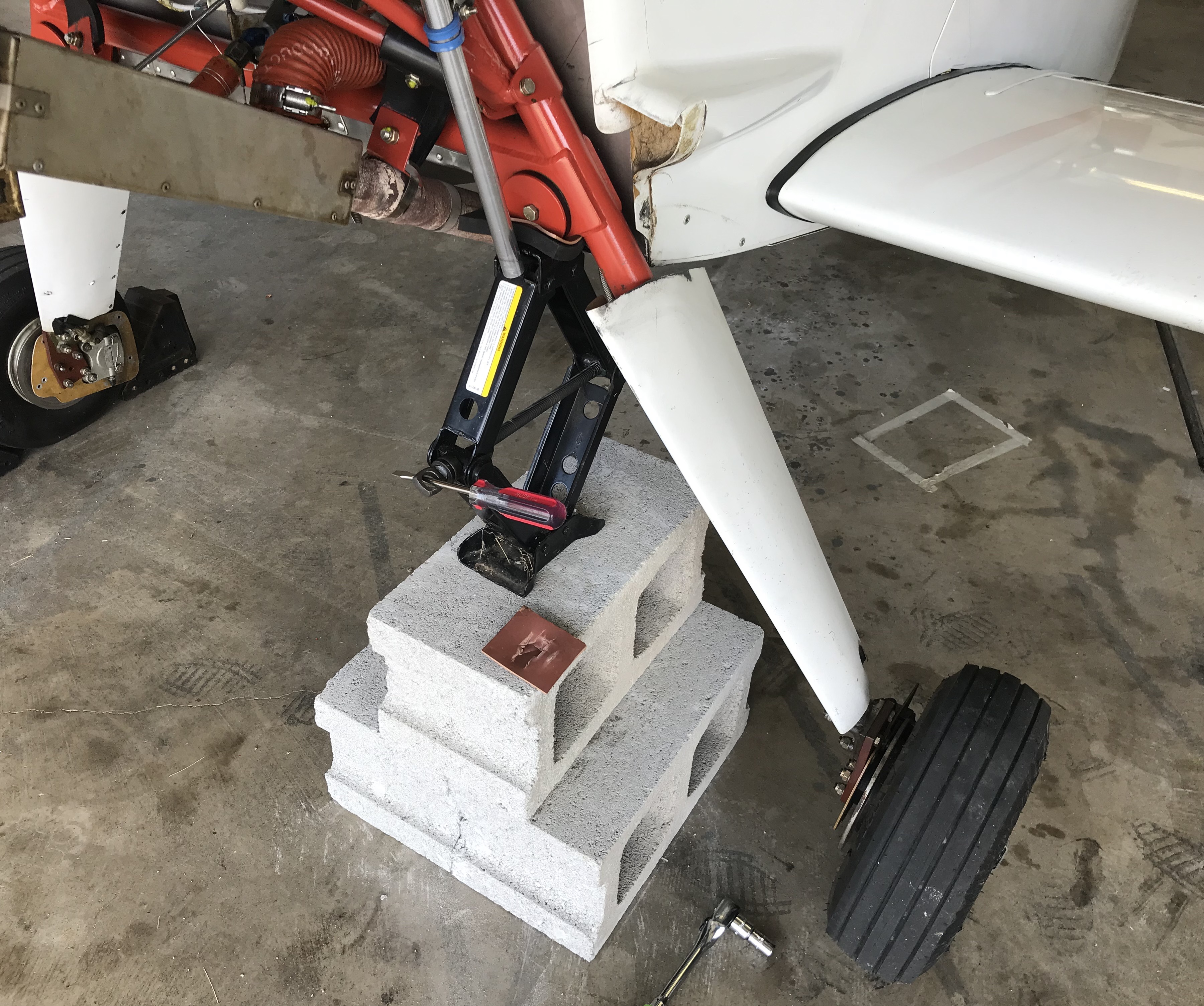

2. Jack. I found that I prefer to jack the plane where the A-frame attaches to the lower firewall. I felt that I didn't have a good, safe jack location down at the wheel. I found a scissor jack that came with an old Jeep with a V-notch at the lifting pad that fits the gear perfectly. I still use a couple layers of rubber padding so I don't mar or scratch the metal. The advantage for me is that it keeps the entire lower gear/axle/brake assembly unobstructed while working.

File comment: Jacking method
